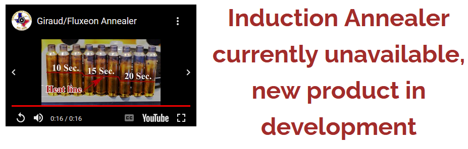

    Nice. Didn't see they had a good induction conversion up and running. First version looked to be a bust.

    It’s been out of production for several years now. Pisses me off.
    sigh...late to the party again! haha
    I have their brass trimmer but never really looked at the annealer part of their website with any rigor.
    Wonder why it has been years out of production. Now, I'm not a design EE, but what I know from actual EE's, is that making an induction coil and powering/controlling it is really not a ground breaking challenge.
    I use my friend's AMP until I feel like getting off the $$ for my own (this year sometime...been too busy going broke buying other rifle stuff! haha).
    I just think, based on my little bit of knowledge, that an induction heater type rig is more controllable (repeatable) and certainly better from a fire safety hazard POV. But then, I'm an idiot who once almost burnt his house down...close call and long ago but its the type of memory that keeps on giving! LOL
    Word on the street when they first put a pause on it was that they were going to come out with a new model so I didn’t pursue getting one of the old models. Well I’m still waiting, not so patiently.
