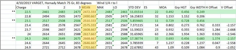

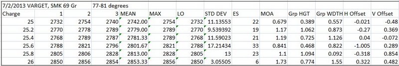

A couple of runs in my MVP Predator. I didn't spend too much time on the heavies hoping to get more velocity out of lighter bullets.
Still trying to decide whether or not to like this rifle.

Looking at the chronography, I really don't get much meaning; I suspect 3 rounds is not enough to have meaningful value, if I'm reading this data correctly. Matters like ogive and neck tension variances have too much weight in such small samples. Rather than 3 rounds, I'd be checking 10. Load development selections have far reaching consequences. I like to have repeatable results with large samplings upon which to base my bulk ammo production.
One of the things I did with my MVP Predator was to mount up the same scope on it, a Bushnell AR .223 Optic BDC 3-12x40 scope, as I have on my 16" AR upper. It makes it a bit more easy to like. The things I like most about the MVP Predator are things I might not like so much in my heavier, more precise rifles. I see it more as a field rifle than a range rifle, where compact mobility and decidedly lighter weight should count for more.

These were OCW runs to see if anything jumped out at me.
