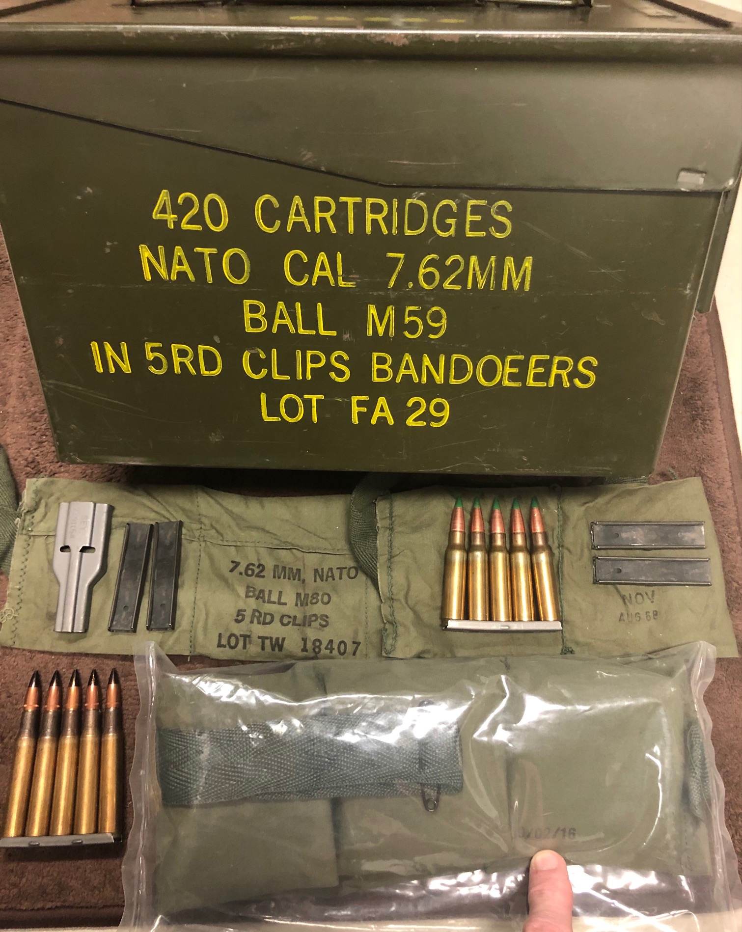

I'm just waiting for somebody to come out with the box of mil spec stripper clips designed just for the USMC M40, lol. Seriously, no other modern rifle has gone through so much speculation than the so-so original USMC M40/700. Do any of you even own an SKS :).
Joking aside, the US military has used 5-rd stripper clips since the turn of the 20th century. Attached pic are various US 7.62 NATO ammo circa 1958 (M59), to Vietnam era (1968), to a recent bandoleer that utilized M80 ammo. The 30-06 stripper clips were about the same except they have 2 small bumps or 'nubs' on the side and the later ones seem to have only one small 'nub.' I looked it up, and the first use of the modern 5-rd charger clip was on Paul Mauser's rifles from the 1890s. At the turn of the 20th century all military bolt action rifles from the major powers used clip slots to allow a soldier to quickly load (and re-load) 5-rds into their rifle, which matters in combat... (US, UK, Germany, Japan, Russia, etc all had clip guides on their infantry rifles).
(I have not studied the history of the Remington Model 720 or 721, which I presume some had the square cut-out like a lug slot, but I have studied the 1966 and later history of the M700s).

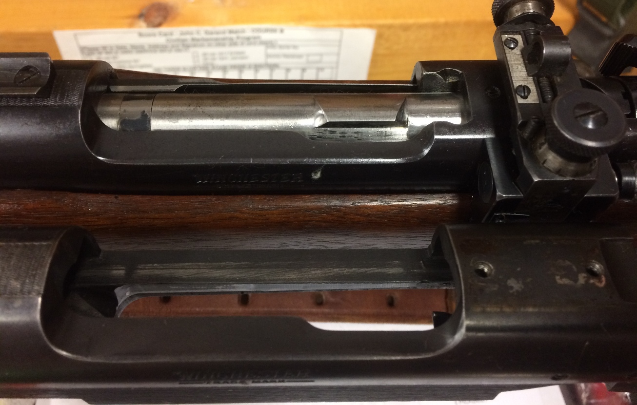

These M70 match rifles were made with clip slots to allow the rifle to be competitive in the Rapid Fire Stage. (They made a 'National Match' version and a Target version, but I won't go into the differences here, other than to say they both had clip slots.). Here's a 1950 M70 National Match model (not my rifle). Please note the clip slot on this early M70 and the fact that it was designed for high-power competition.
Below M70 rifle in the front is a mid-1950's hunting M70 rifle with no clip slot and standard barrel. Rifle in the back of pic is a 1953 M70 Target rifle with clip slot, a medium heavy target barrel, and precision match sights. (It's like that rifle in the above 1954 ad).
Other than the clip slot on the top M70, both receivers are otherwise identical. So, WRA didn't machine clip slots on their standard hunting rifles as it was more expensive and time consuming to do all that machining, so only their special target rifles got the slots (and I think the rare heavy barreled 'Bull Rifle' got it too)...and guess what? Remington decided it wanted to compete against the M70s - and did the same beginning in 1966 when they made the first 40-X repeater target rifle. They wanted to compete with Winchester in the 1960s, so Merle Walker developed a target rifle:

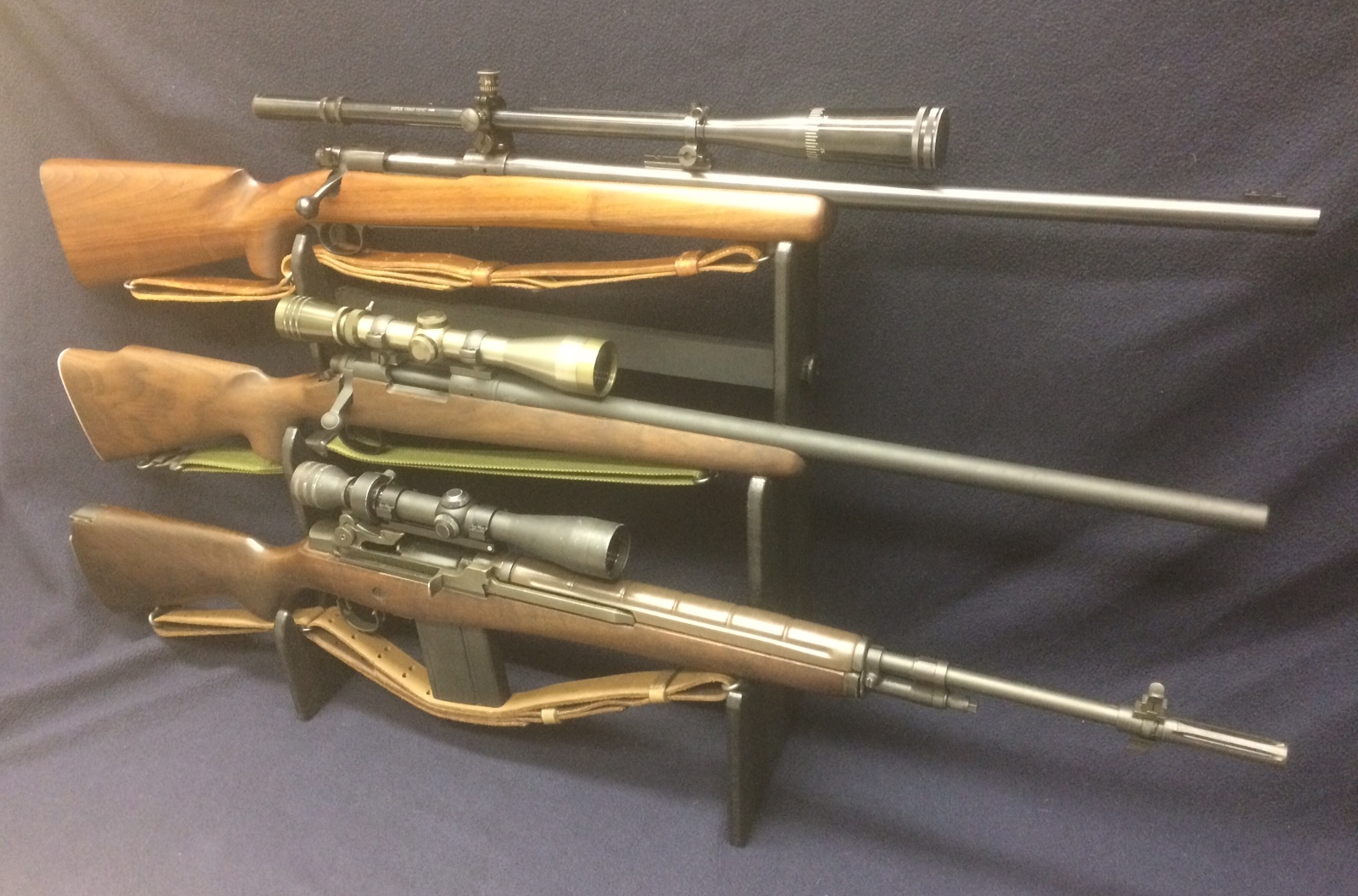

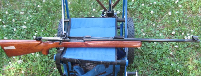

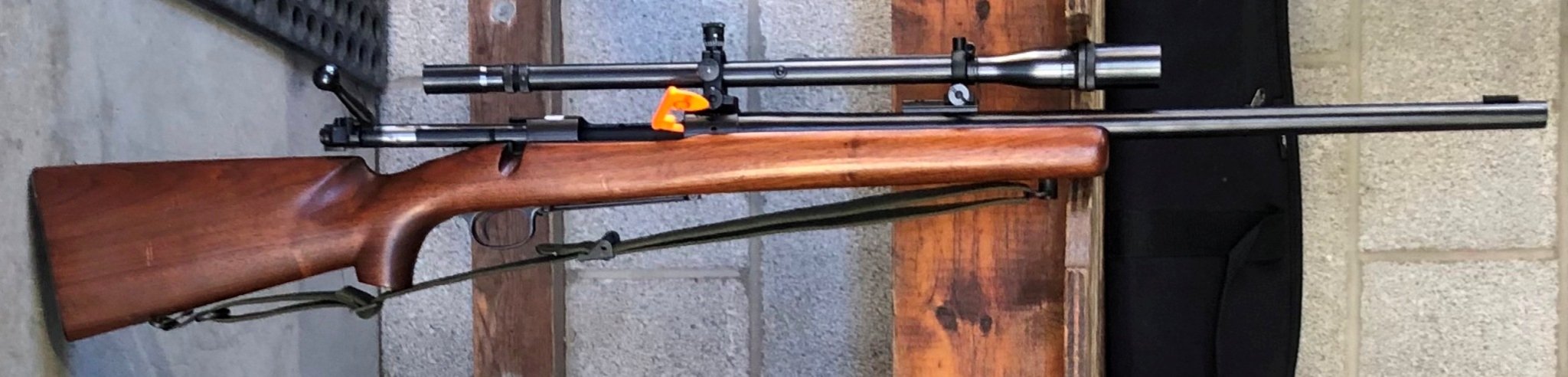

Wondering if there was any connection between the single shot 40X (early 1960's vintage) and models issued/used by Uncle Sam?
The stocks on these old beasts were a bit heavy, with barrel contact screws, t-slotted rail on the underside, and a relief cut on the comb to clear the striker....
At some point it was fitted with a newer (action was polished blue) "Remington" marked barrel in .308 with a parked finish...
I got this Rifle a decade ago in a trade and regtetted it until I shot the best .30 cal group of my life with it....know what they say about book covers

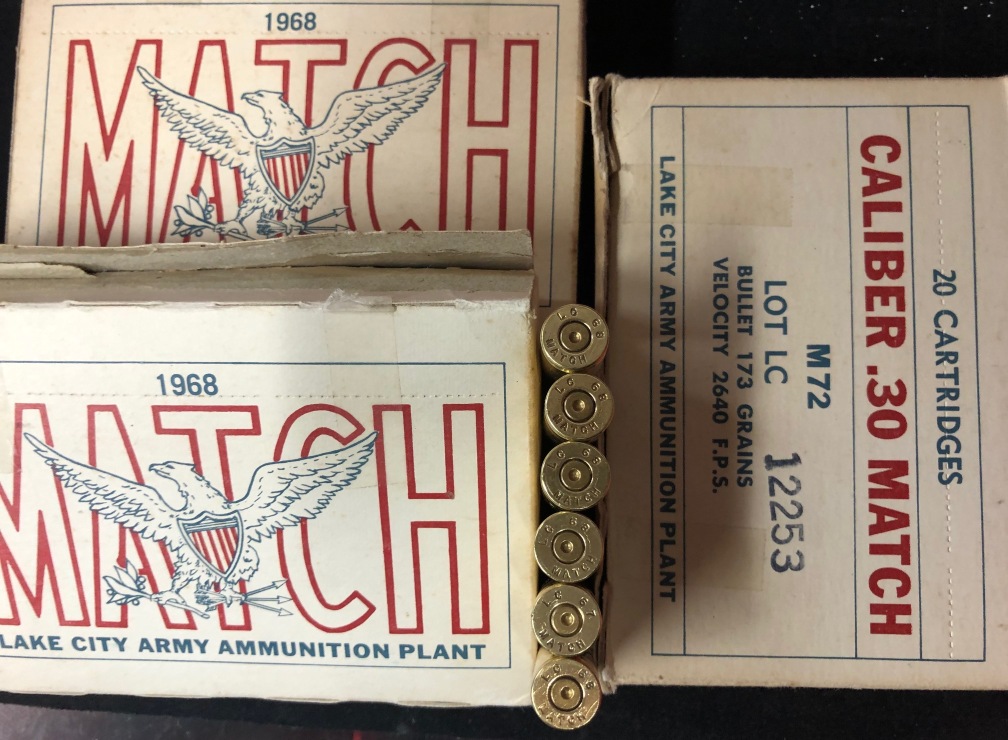

Just a reminder, Lake City was still producing generous amounts of -06 into the 70s and Frankford Arsenal stopped in 1961. The last M72 was 1967. Carlos was shooting an -06 Model 70 in Vietnam using M72.
Yep, that's correct, lots of M72 was certainly in the supply system during Vietnam and well into the 1970s, and it was used by Hathcock and others.
BTW, it appears that LC was still making M72 match ammo in 1968 as well (see attached pic of some old M72 boxes of lot # 12253), but maybe that was the last year. Fwiw, I use that LC match 67 and 68 brass for my 30-06 reloads for my M70 replica sniper.
