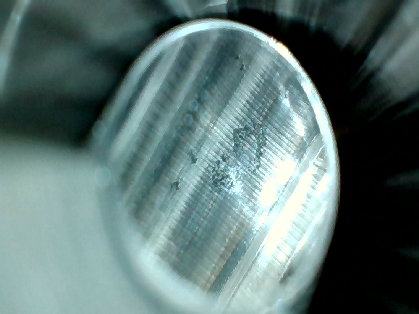

I probably have less than 500 rounds through my MSR 10 .308. Never shot corrosive ammo. But the barrel has extensive pockets of erosion the entire length of the barrel. attached photo is of one of them. Barrel is standard chromoly steel - not stainless. Any thoughts? Nothing else I have has anything like this in the barrel.
You’re rolling the dice with the odds against you when buying low end stuff and that one clearly wasn’t a winner.
You could send it to Savage and try to get it replaced but good luck. I sent back a long range hunter 7mm rem mag that grouped like a shotgun pattern and they sent it back to me a few weeks later saying it met their accuracy tests. Still shot like shit.
If standard barrels work on them then I would say dumping that barrel in the scrap bin and putting a good barrel on it would be your best option.
