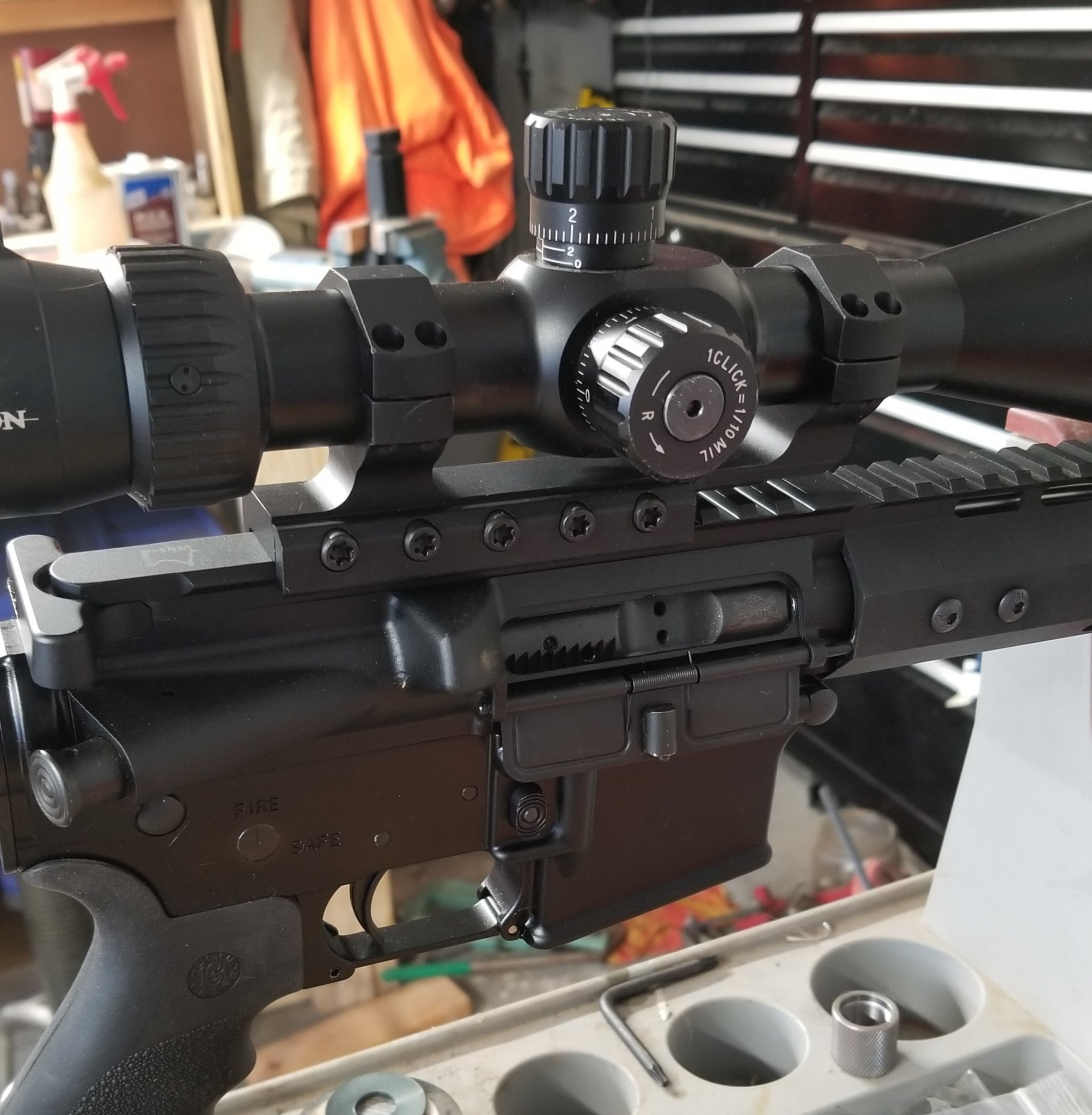

Any suggestions for 16" 6.5 Grendel
Highbrass
Pew Tang Clan
I recently got to try out my 6.5 Grendel that I put together several years ago. I wanted to test it long range but I had several issues. Most of these issues were self inflicted, but I think I have most of them under control. My main issue was a cheap scope mount that would not stay tight. It will be replaced with either an Aero Lightweight or Leupold One Piece mount. My other issue was a Magpul stock that was flexing.
I have the AA 16" 7.5 Twist barrel. My goal was a lightweight short barreled Grendel that I could take to 800Yds (longest range at the place i shoot)
I need to test some handloads and i'm looking for input here also I have some 123 AMX's with 30.5 Gr CFE and some 100 Gr Lapua Scenar's @ 31.5 CFE
My last range trip started off to be a disaster but I was still able to hit steel @400 yds.
My scope might get a swap also. Current optic is an Athalon Argos 6~24
I have an Arken on order and have a Athalon Ares 6-24 that I can swap from another rifle.
I know others have 16" Grendels, what are your suggestions?
a 16" Grendel should hit 800 without issues. I've taken my 16" out to 800 with factory ammo, 123 ELD and 123 AG (2400-2450 fps). The scope mount and scope sound like they're part of the problem. What does your rifle group at 100? Mine is only 1.25-1.50" with most factory ammo. My scope is a PST II 3-15 in a Seekins MXM mount.
To the point..I built this rifle the first time on a shoestring budget. There was a several year gap between the rifle assembly and being fired. I used some "budget" parts which have proven problematic. I now wish to atone for my foolish choices, and was looking for some recommendations on parts and loads to make a lightweight short barrel Grendel that will be consistent to 800 yards.

I have an 18" Alexander Arms barrel and it's been great for me. Your 16" barrel should get you out to 800+ yards no problem with good ammo. Your scope is probably just fine for what you're doing, but an upgrade might be worthwhile eventually. I would focus on the mount first and foremost.
If you're "upgrading" your scope mount, I would not recommend an Aero Precision. I had nothing but trouble with one on my lightweight coyote-hunting gun, and the issues went away after I switched to a Warne XSKEL mount. The Aero mounts are not something I would recommend for any "precision" oriented uses. Get a solid mount from Burris, Warne, LaRue, ADM, Bobro, or similar (depending on budget) and accept that it will be a couple ounces heavier than the Aero. Those few ounces of saved weight don't matter if you can't reliably hit where you're aiming. If you really want a lightweight mount, Nightforce makes a quality one that's around $200+.
Reactions: LRRPF52
I have the Leupold mount coming in this week.
While I haven't used one myself, I have heard that they're quite good. Hopefully that helps you get on target. A quality torque driver will be essential in getting it mounted properly. Be sure to follow the instructions from Leupold, and you'll be all set.

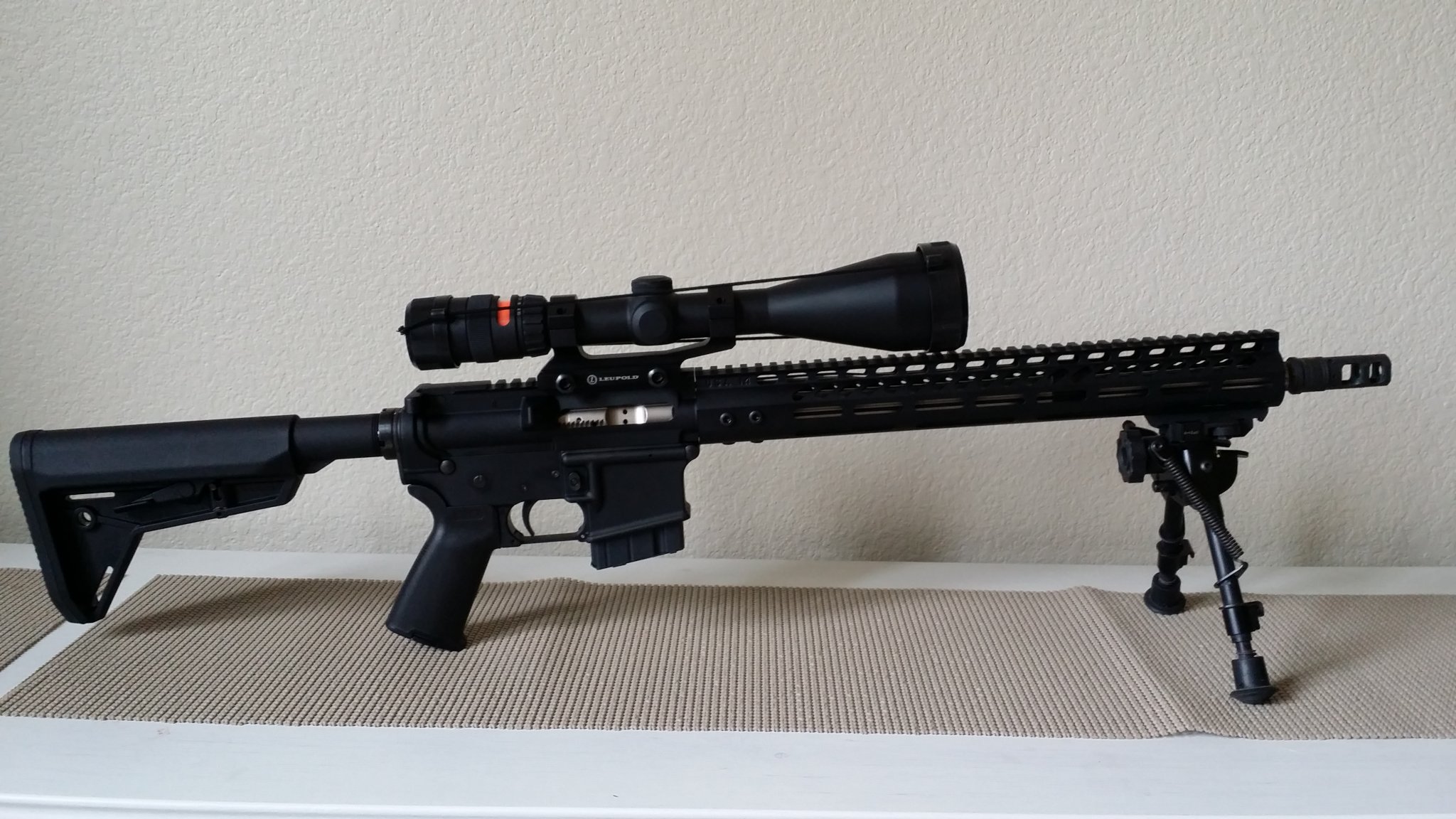

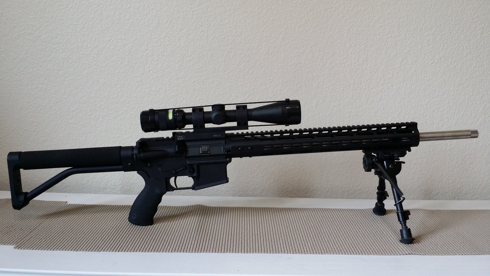

I like the 100-130gr bullets in both a 16 & 20 inch Grendel.
My go to bullets are 108/123 scenars or 123 Hornady BTHPs (cheap) or SSTs. Later used for hunting.
For powder, I've had good luck with AR-COMP, H4895 and CFE 223.
