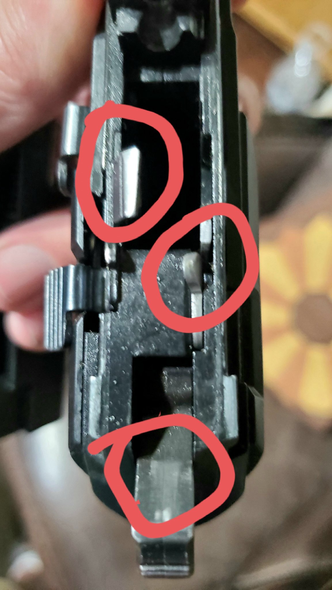

I was an early buyer of the SIG Mosquito and jamomatic was a good description. Sat in safe for years waiting to be sold then couple weeks ago I decided to try it again after coming across 4 extra magazines. Before going to range I took some 600 grit paper and polished the friction points. Just a light touch to put a little wear on coatings. Took 4 boxes of mixed 22 out and had 2 FTF out of 200. I would get that many per mag on a good day before running mini mag. YMMV but thought I would mention.

Took a pic of where I polished my mosquito to make it work.
Not worth the hassle man. If you have to polish hammers, reprofile extractors and ejectors, polish feed ramps and slides, tweak springs and feed lips, you’re not shooting the gun you are playing gunsmith. Sell that crap and run a pistol thats 100% out the box. Been down that road, its a waste of time.
