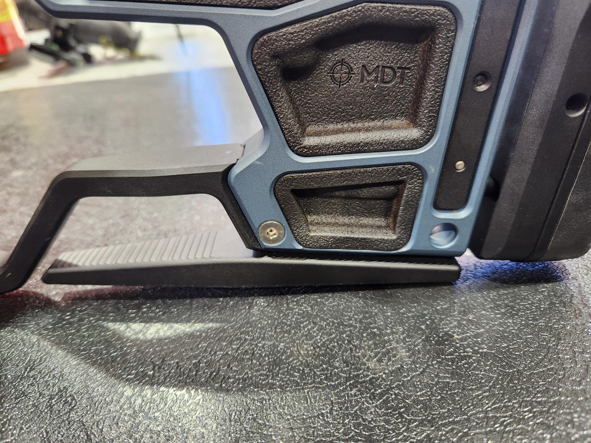

    Picked up an ACC Elite and got MDT’s aluminum bag rider with it (among other widgets). Problem is, the bag rider angles downward from back to front, and I’m looking for one that has a bottom surface parallel to the bore.
    I could do a lot of internet searching, but thought the Hide might know an outfit who makes what I want. Thanks for any help in advance.

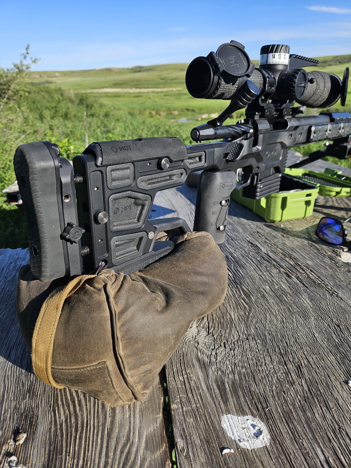

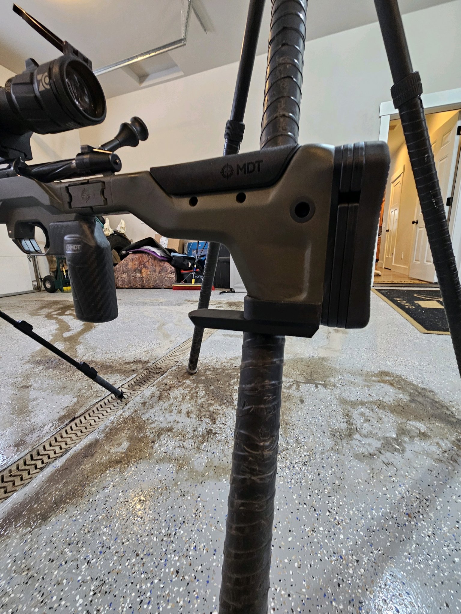

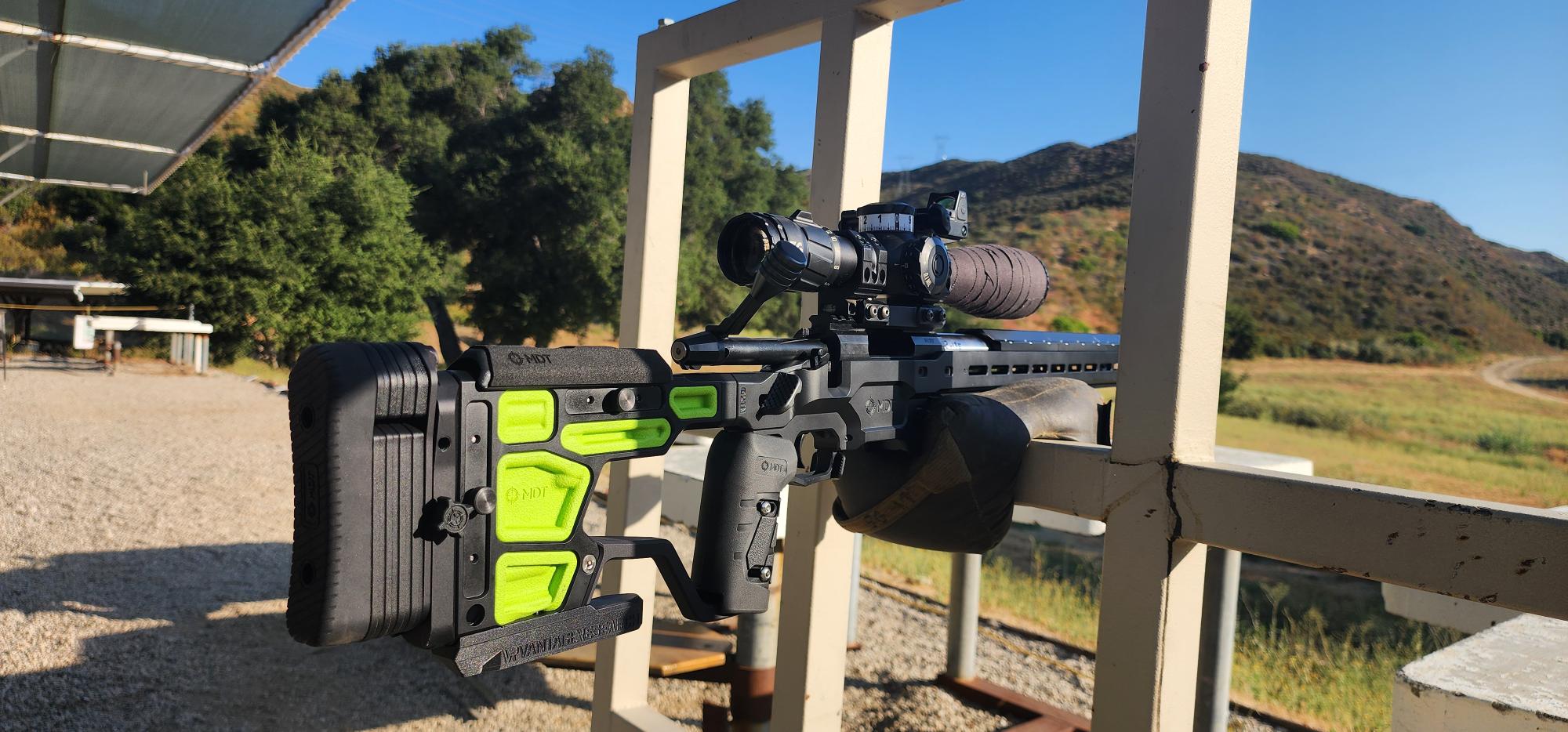

    Made a simple one, just dont want the chassis to hit the ground every time when I go prone.

    This has been mentioned to MDT a number of times and it blows my mind that they don't get that their bag rider for the Premier is just not suitable to the Elite due to slant. It would take an engineer how long to modify the CAD data to do this? sigh
    Yep, I was pretty annoyed when I bolted it on. I'm sure they'll get there, it's gotta be a little glaring to their product management team when their flagship shooters are running 3D printed parts that compete directly with the MDT official stuff. I get that SKU minimization is important, but angled vs straight bag riders are not a new concept. I do think that the precision shooting community isn't necessarily aligned on which is best though, some people like that the angle provides them more rear bag range; I think tripod rear might make the issue more obvious.

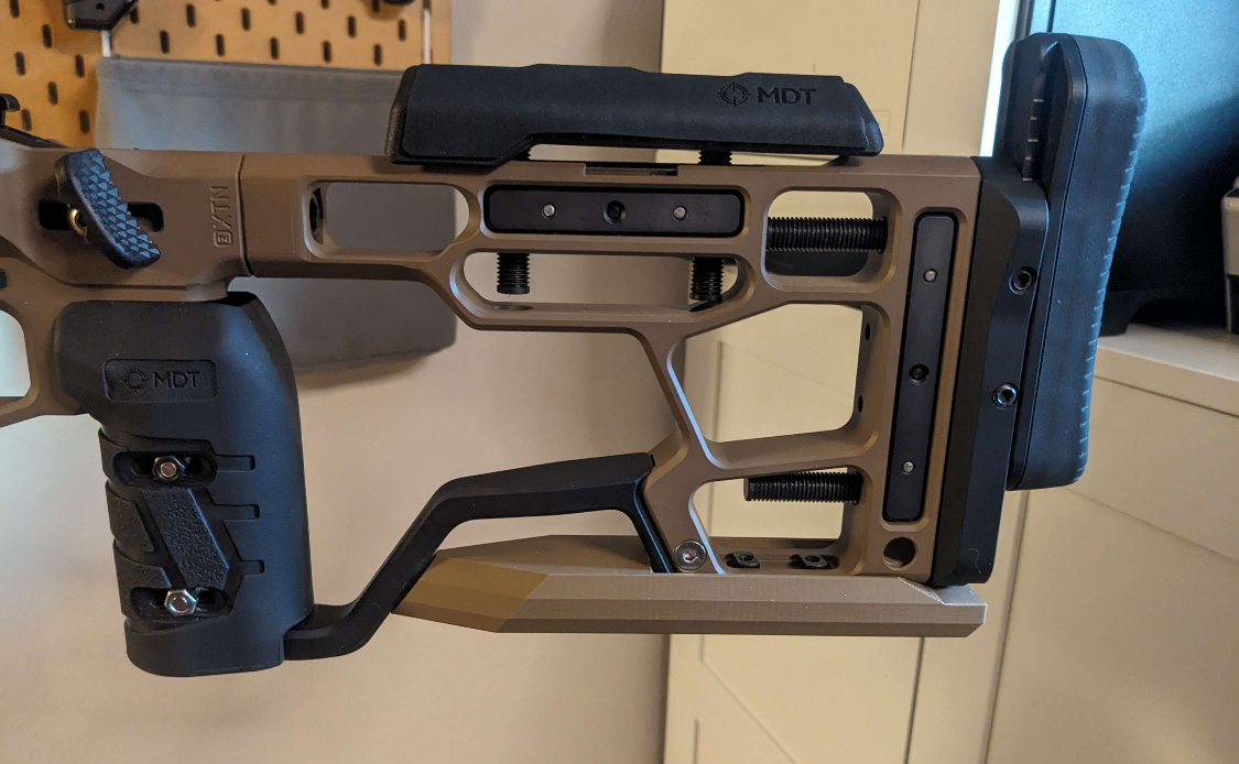

    ACC Elite bag rider here for sale now.
    CNC machined 6061-T6 Aluminum and Cerakote finish matched to the factory black.
    Flat bottom with full radius edge for ideal tripod rear support engagement. Top surface has grip ridge texture to it (smooth). Does not stick out at all presenting any snagging surfaces. Tapers to match the grip support width. All other edges have a radius and are smooth.
    Attaches with 2 MLOK fasteners (provided) into the MLOK slot on the bottom of the MDT rear stock. 4.9oz weight.
    Tested by a top 10 PRS shooter. Everyone is happy. Get yours now.

    Is the bottom surface parallel to the ARCA on the forend?
    It creates a flat plane across the bottom of the rear stock. No relation to barrel axis, however it is very close to that axis.
    Provides a 6.4" long flat area with a radius edge to engage rear tripod. The bag engagement part is a bonus. These chassis without a bag rider only leave a few inches of area in the rear where you are basically up in your armpit engaging tripod rear support.
    In fact all, of our testing was around tripod rear support. Everyone has a place to engage they feel comfortable and stable and the full 6.4" length gives that room. Also this does not present a snag point like some of the other attempts I have seen at shorter versions.

    I appreciate the info! Tripod rear is roughly half of my use case, but rear bag is the other half. One thing I don't want is elevation changes when the rifle travels rearward, which is why it's important to me that the bottom surface of the bag rider be parallel to the bore. As I mention at the top of this thread, the current MDT offering fails to achieve this requirement; it will tend to tip the muzzle downward under recoil. It would be better for me to run no bag rider at all than to have this issue.

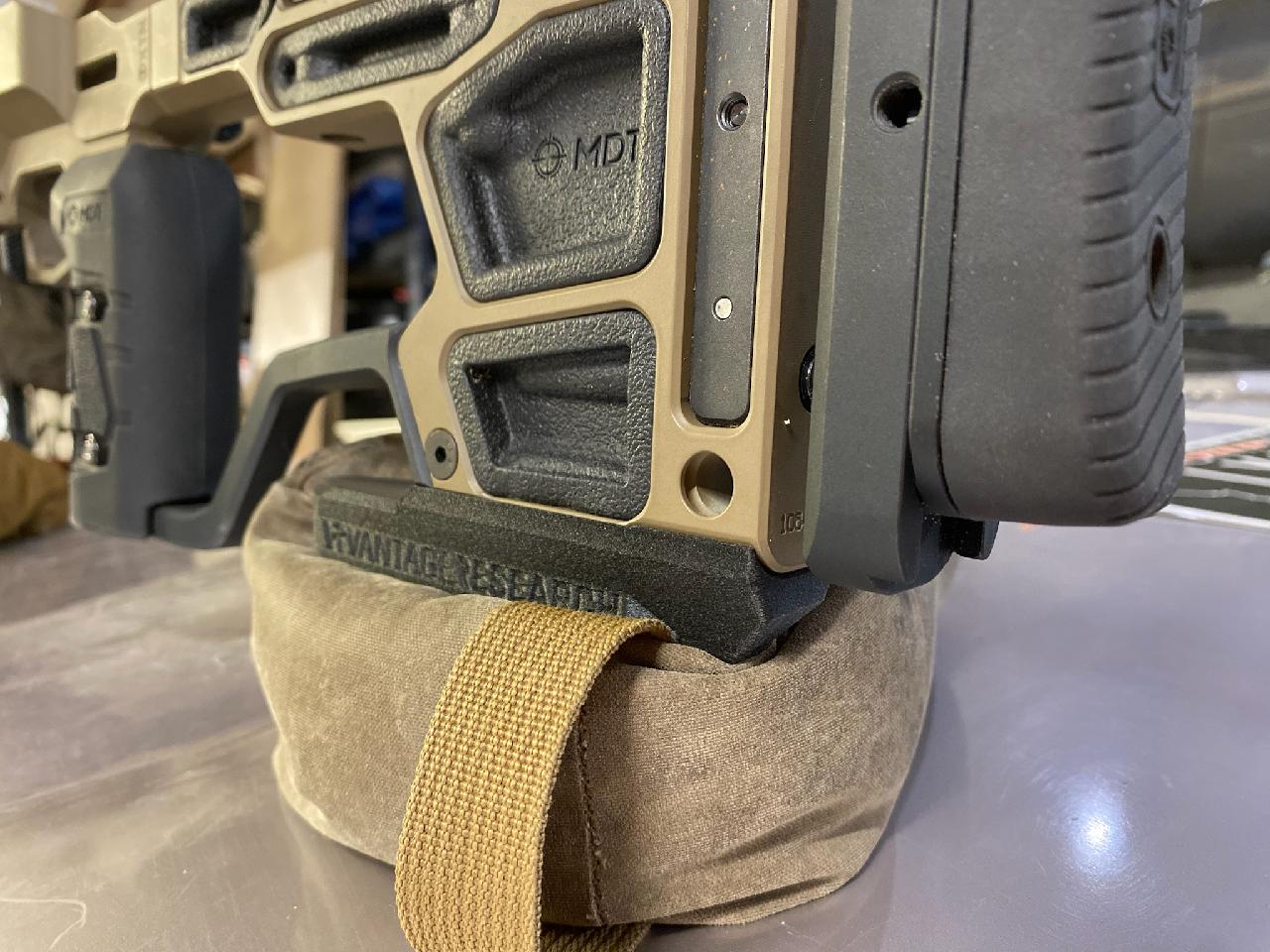

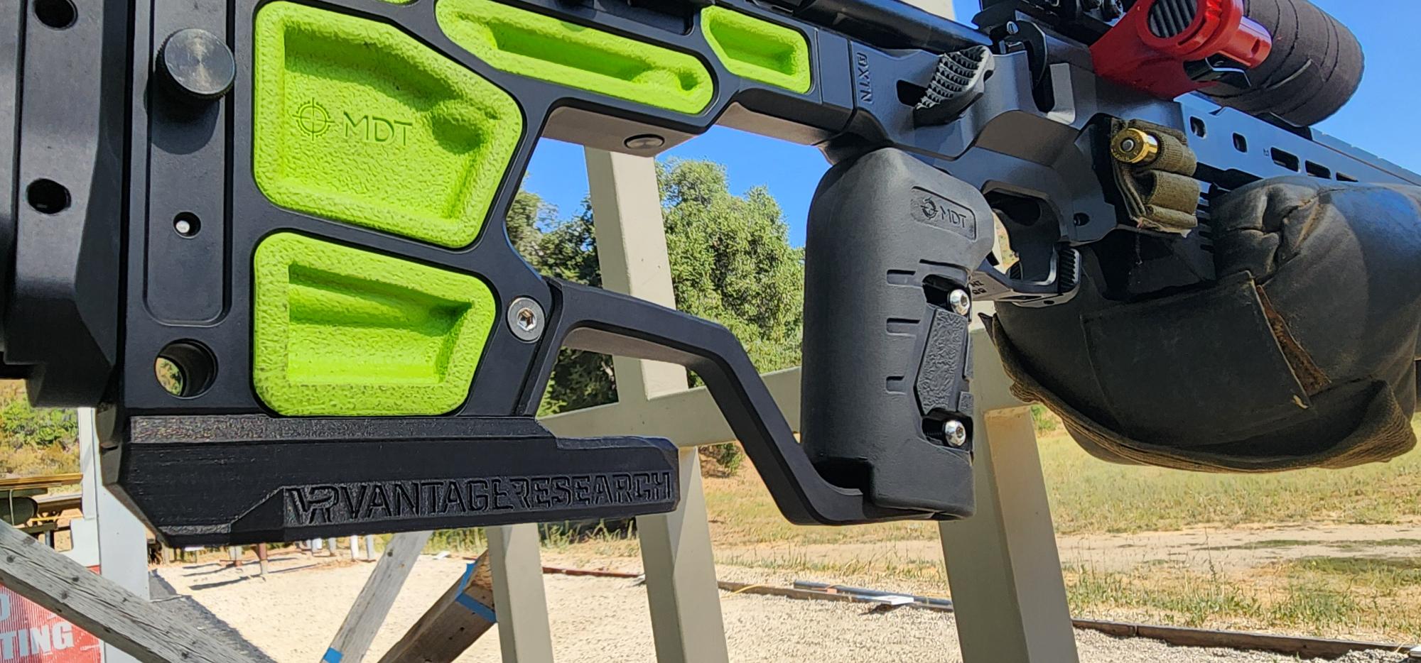

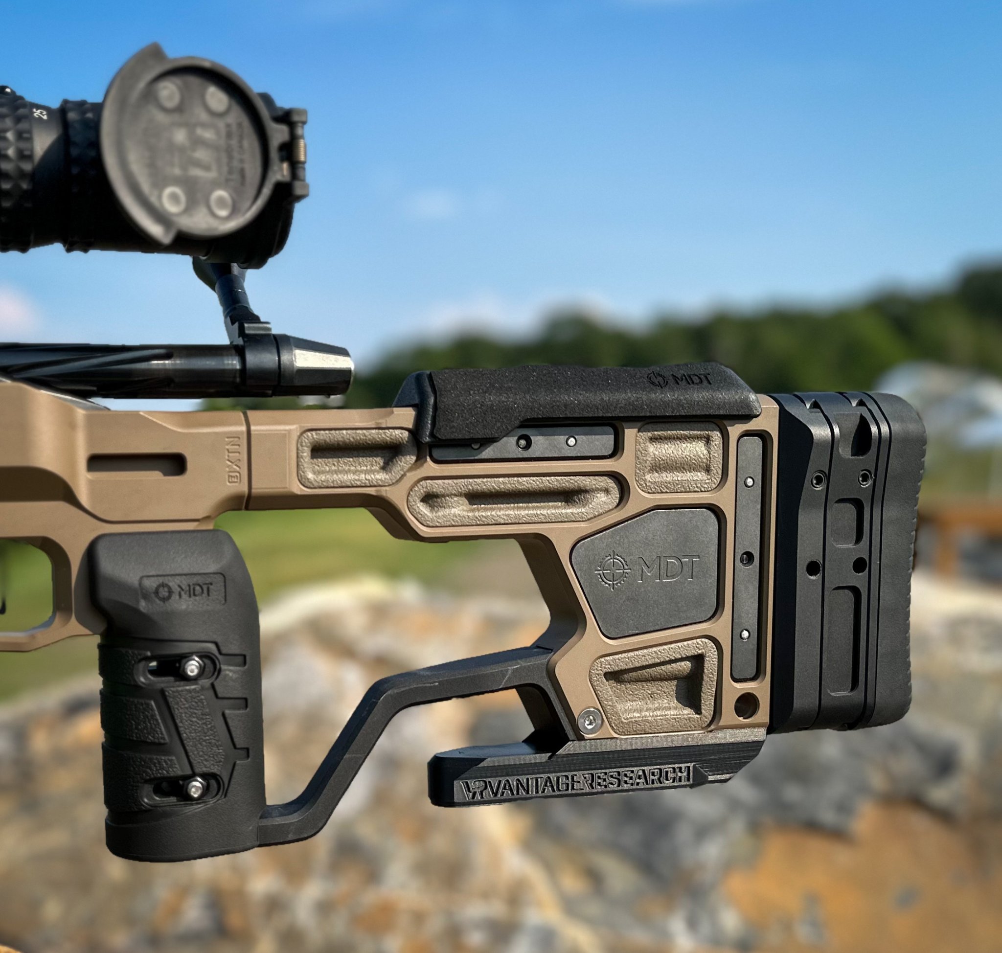

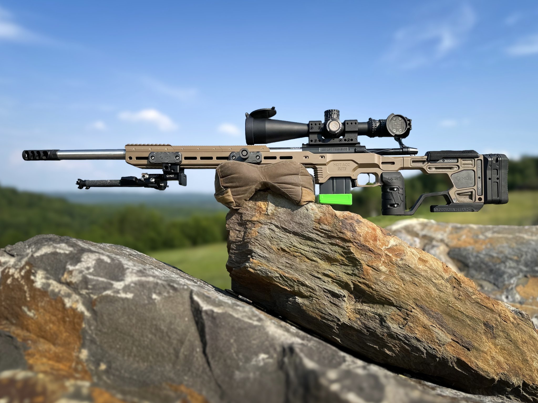

    Michael from Vantage here - I made these specifically for this use case as I see they were posted above:
    More of them are getting out there in the wild and we're getting great feedback from them in the field. Some highlights are that they are purposefully designed to fit the bottom contour of the ACC Elite, fit flush, add minimal weight, and drive recoil parallel to the bore axis.
    I'm not surfing the hide as much as I should, but shoot me an email at [email protected] for a hide discount on these.
    Any chance you could custom make them so there is just like a little nub that protrudes in the front rather than like an inch?
