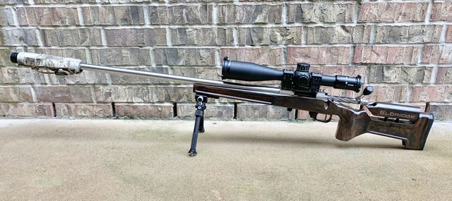

I went with a Defiance medium (not XM) action and use WSM alpha mags. If you hand load, I’d stick with the shorter freebore (.130). You shouldn’t have any oal issues with Alpha mags and 140 class bullets. If I did it again I’d go the same direction.
