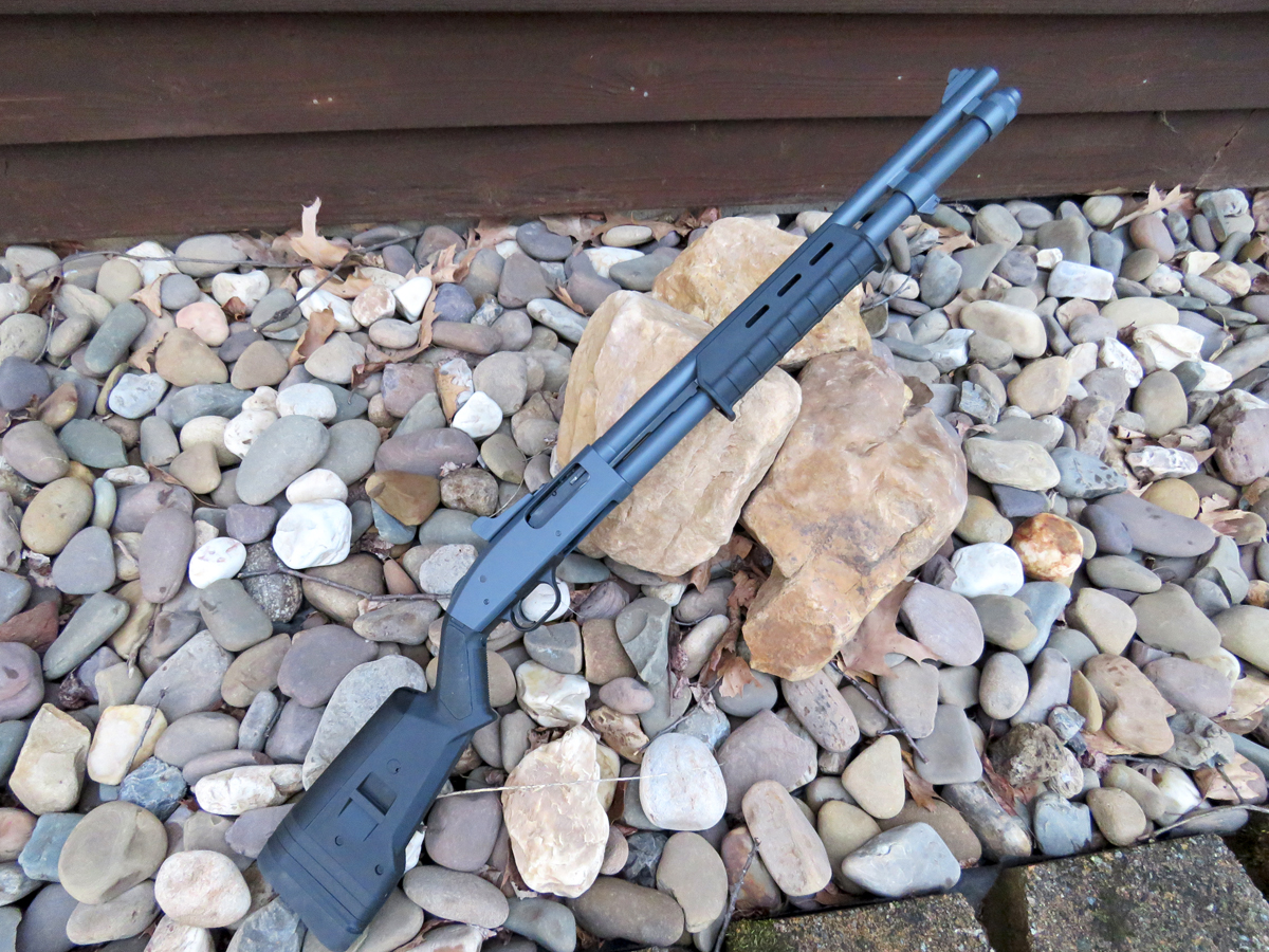

I would opt for something like the Duracoat Aerosol spray cans, I've used these several times and the price is about the same as a vinyl wrap kit and if you can operate a spray can you can handle this. A lot of people recommend Alumahyde II but Duracoat is dry to the touch in a couple hours and ready to reassemble for use after 24 hours; it's also chemical and corrosion resistant.
This was a Mossberg 590 I did in Combat Gray.
