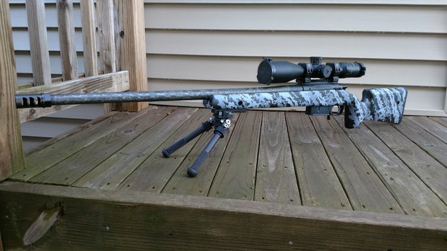

This is my third one and they have all been extremely accurate! This is my latest LRI build in 6.5 cm.
Todd
