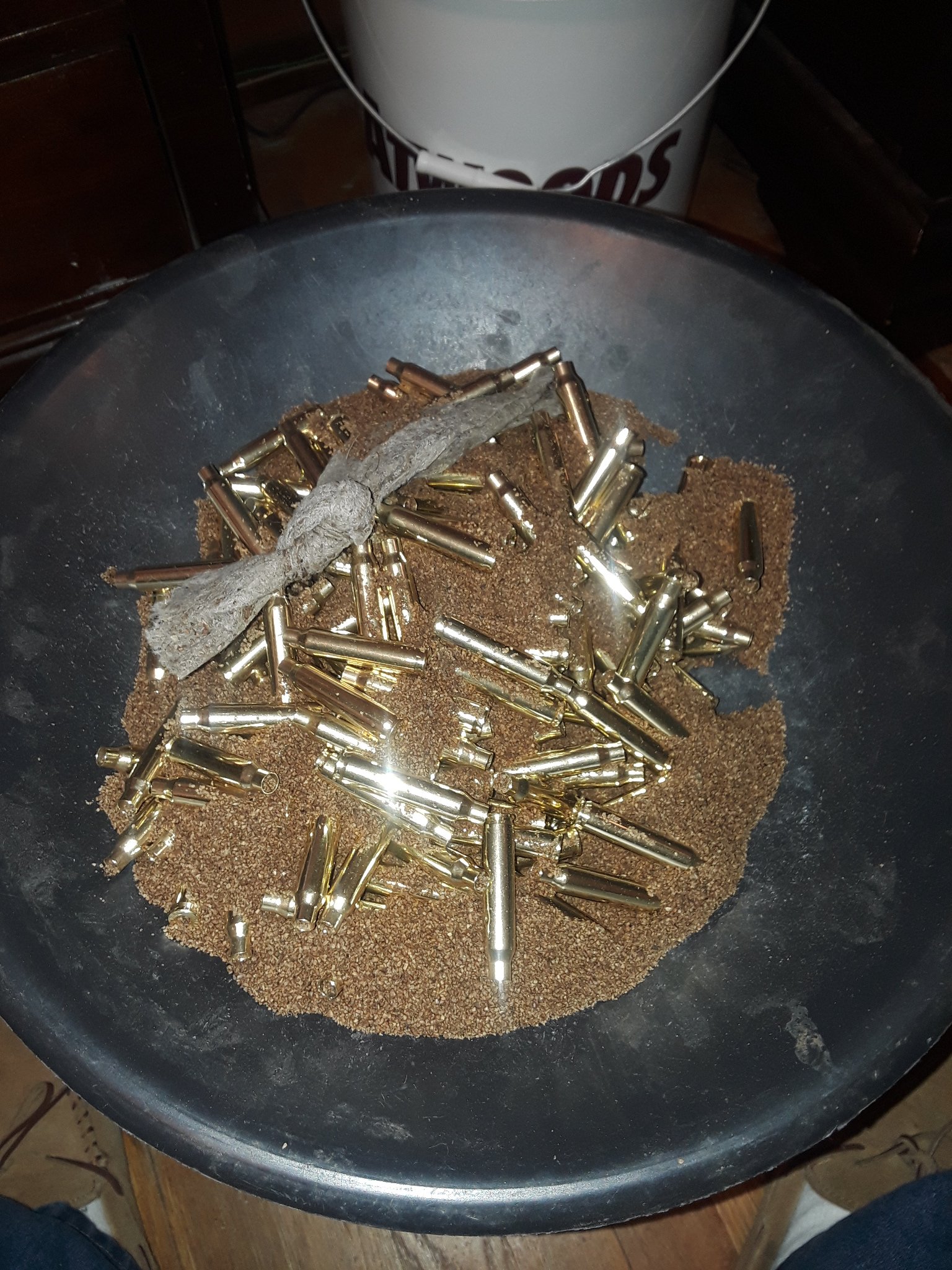

I got some of it also. The lack of dust compared to walnut media makes it so much better to work with. I can remove it in my loading room instead of taking it outside. I used Orkan's method of leaving the tumbler running and hold the case against the side of the bowl. Did not make any worse mess than walnut.I tried the rice that @orkan recommended. Picked up a big bag off Amazon. Worked great. No dust like I had with the other media. Gonna stick with the rice now.
