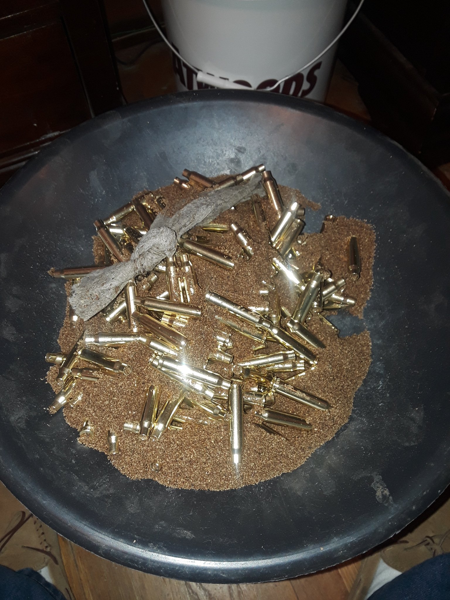

Anybody using rice to tumble?
I leave the primers in because it can get stuck in the flash holes and that just annoys me. But rice works great. Pretty sure I started doing it after reading Orkans article on it. 🤙🏻🤙🏻🤙🏻

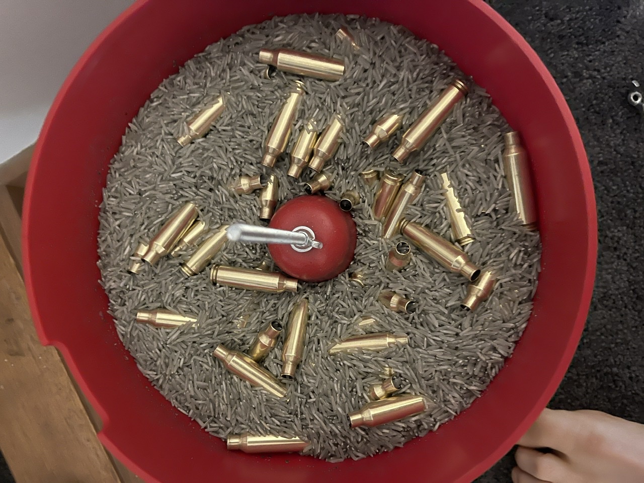

I use rice in a Lyman tumbler, works just fine. Same rice that @orkan recommends.
I don't clean primer pockets or flasholes, spent primers are still in the brass when I tumble. So no issues with getting rice stuck in flasholes, and can't say I see any degradation in performance with this method.
How long do you run the tumbler ? 4hrs?
It works, but not as good as the cob or walnut. I am sure it is more expensive than the 20/40 cob from drillspot.com ($26 for 40 pounds, shipped.) But if you get that you better have something to put it in. Needed 3 plastic 5 gal. buckets. It comes in a paper bag, and I am sure the mice would be into it almost immediately.

When I tumble rifle brass, which is rare, I use a Dillon vibratory tumbler. I use lizard bedding (ground walnut shells) for media and add a cap full of Nu Finish car polish to the media. Tumble for 90 to 120 minutes and the brass is clean.
I use corncob, tumble with primers in, and wipe down each case afterward with a pink shop cloth and 90% rubbing alcohol to remove dust and reduce die erosion. I lube with RCBS liquid lube for resizing/decapping, and remove that with a pink cloth and 90% rubbing alcohol. By handing every case exterior, I can locate most case damage before actually getting into case prep.
I resize, then clean/ream flash holes, reloading itself begins with repriming. Each completed round gets another wipedown with 90% Alcohol.
