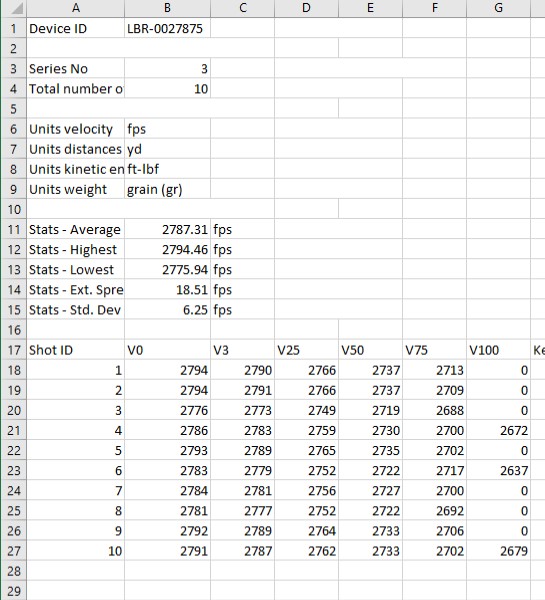

I'm running Peterson in my 284 using 183gr Sierra's, Fed 210M, 50.3grs of H4350 at 2787 fps with no pressure signs out of a 24" Shilen barrel. Load groups sub .5 MOA consistently as long as I do my part. Currently only at 3 loadings but so far so good and the brass seems like it's high quality. One thing I will say, I ran the first new batch of brass through my FL sizer prior to loading and had excellent accuracy and numbers off the bat. So then out of curiosity, I loaded 15 cases straight out of the box and had several flyers with a high ES which makes me think the neck tension on these isn't as consistent as Lapua out of the box.
