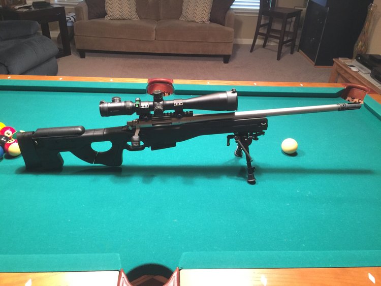

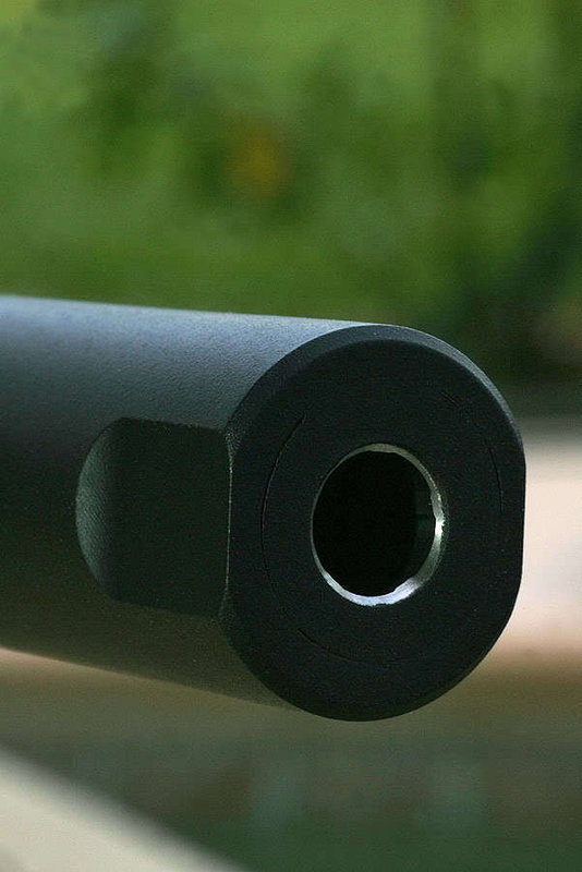

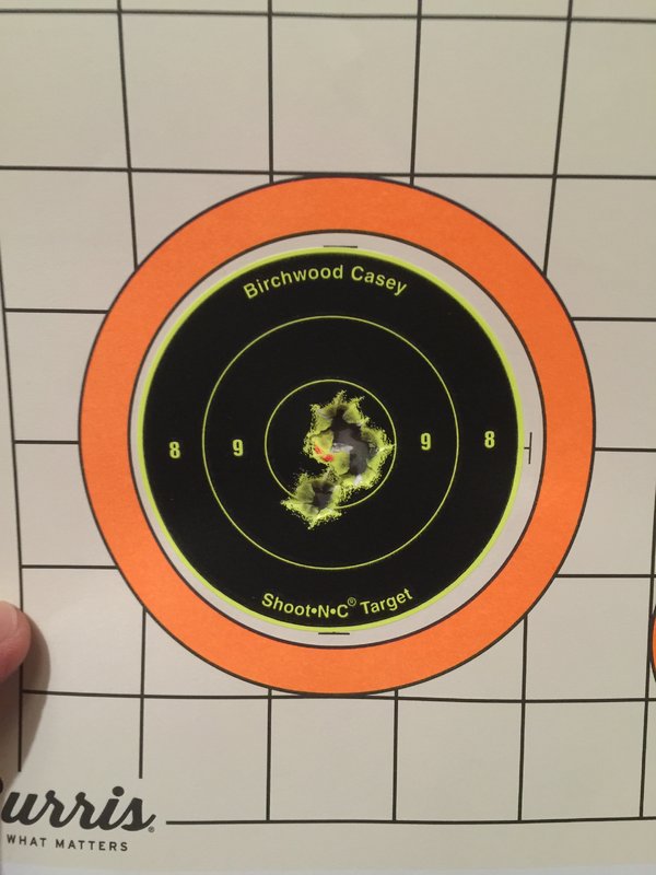

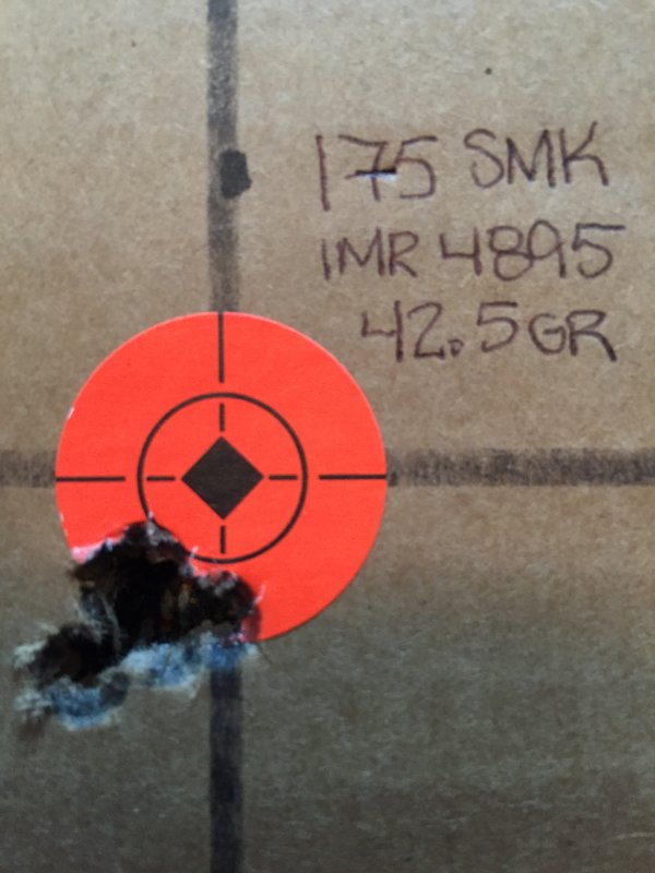

I picked up a 5R in 308 with the 20" barrel back in January. Added a Timney 510 trigger, Nightforce 20 MOA base, Gen 1 Vortex Viper 6x24 PST FFP in Vortex Rings and dropped it all into my Gen 1 AICS chassis.
First range trip it delivered a .53 MOA group at its best with my FGMM 175 clone load (41.8 grains IMR 4064, 175 SMK, ZQI once fired brass). I can't wait to see what this does once I have time for proper load development.

That's some good shooting! Have you tried the 168 FGMM by any chance?

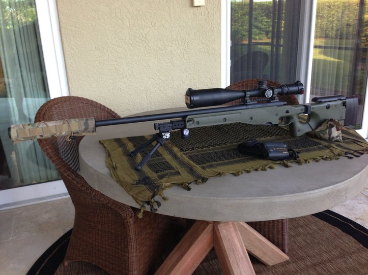

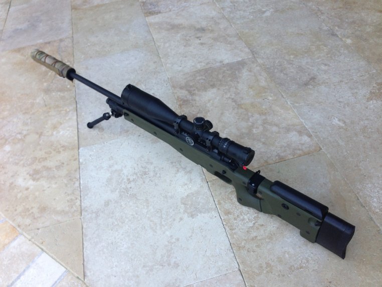

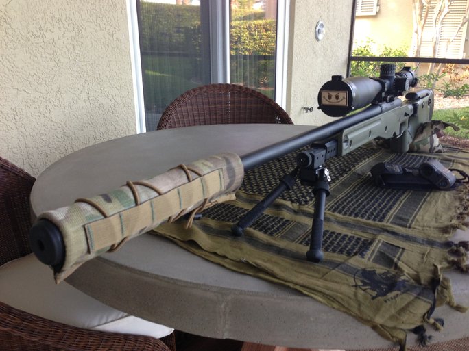

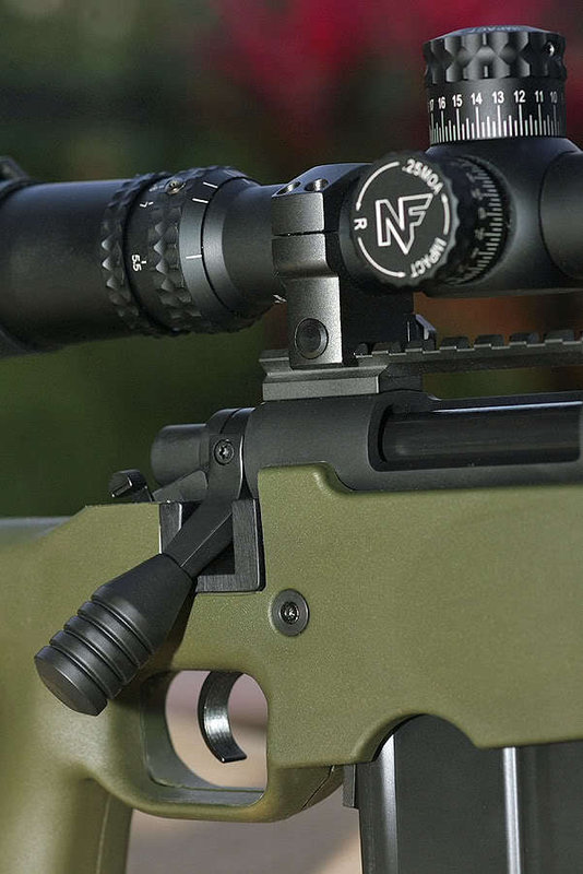

I have a Gen 1 700-5R in .308 and it has always been a great rifle. Loves FGMM 168 and 175gr ammo although I reload my own mainly. I did order 200 rounds of 168gr FGMM from PSA....couldn't pass it up for the price. Anyway, the rifle is a sub-MOA rifle straight from the factory. Maybe I just got lucky but with the Gen 1s, there were plenty of guys reporting they had great shooting rifles. Very few reported having problems from what I recall. I hope your new Gen 2 turns out to be a shooter as mine has. So here is what I changed / added to mine:
- Timney Trigger set to 2.0 lbs
- Sold the stock here on SH and mounted the action to an AICS 2.0 chasis
- Threaded the barrel and added an AAC Cyclone
- Phoenix Custom Rifles over-size bolt knob
- Cerkoted the action and barrel Armor Black
- Installed a Nightforce NXS Zero Stop 5.5-22x56 SFP scope in Leupold Mark 4 Rings on a NF 20 MOA base
- Atlas bipod
Here is what it looks like and what she is capable of:
- Atlas bipod
Thanks for posting that! that is one sweet rifle. That's some good shooting too! Actually, I got a gen 1 5R, the green one with the stainless barreled action. I may spray it black, but trying to decide how to tackle the bolt. might just spray the handle only and leave everything as is.
