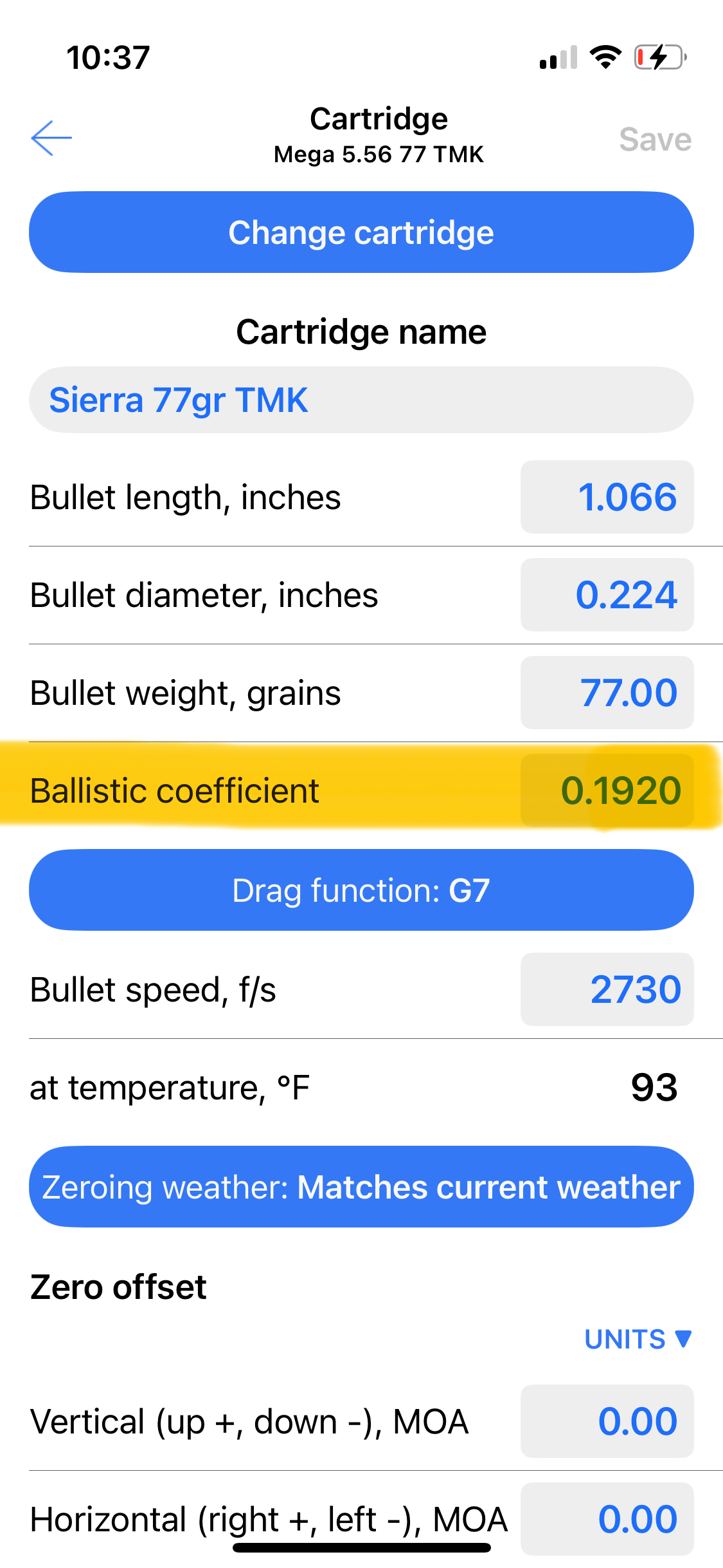

I tried to switch again not long ago to the TMK just to feel more comfortable about expansion at extended ranges from my SMK’s (haven’t had an issue yet with opening tips). But after finding a good load i ran them awhile back and notice hits needed more elevation than called for using the listed bc. I remember one other person saying this and listed he found a g7 of .192 worked best for him. Plugged that in and immediate center hits to 800 yards. Here is the thing, my SMK’s use .190 with solid repeatable precision shots worst 1.2 moa groups at 850 yards. So in my mind the tmk shoots less accurate in all my rifles by about .25 moa+ rifle dependent and basically they copy the SMK’s dope. I’m pretty sure I’ve about decided I’ll be moving back to the 77 SMK.

I'm far from an authority on long range shooting, but I stopped using BC quite a while ago. Applied Ballistics and Hornady 4DOF have impressive libraries filled with custom drag curves for most of the popular bullets. I have found these to work better than ballistic coefficient.
I second this. The Radar ballistics of both AB’s CDM or Hornady’s 4DOF is far better than BCs. Box BCs are good to see a number, but if you can use radar ballistics that’s the ticket/more ideal. True up either ABs Drop Scale Factor (DSF) or Hornady’s Axial Form Factor and you will rarely have to touch it.
