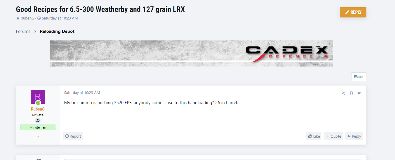

Hi,
How are you pushing this 3520fps then??
Sincerely,
Theis
