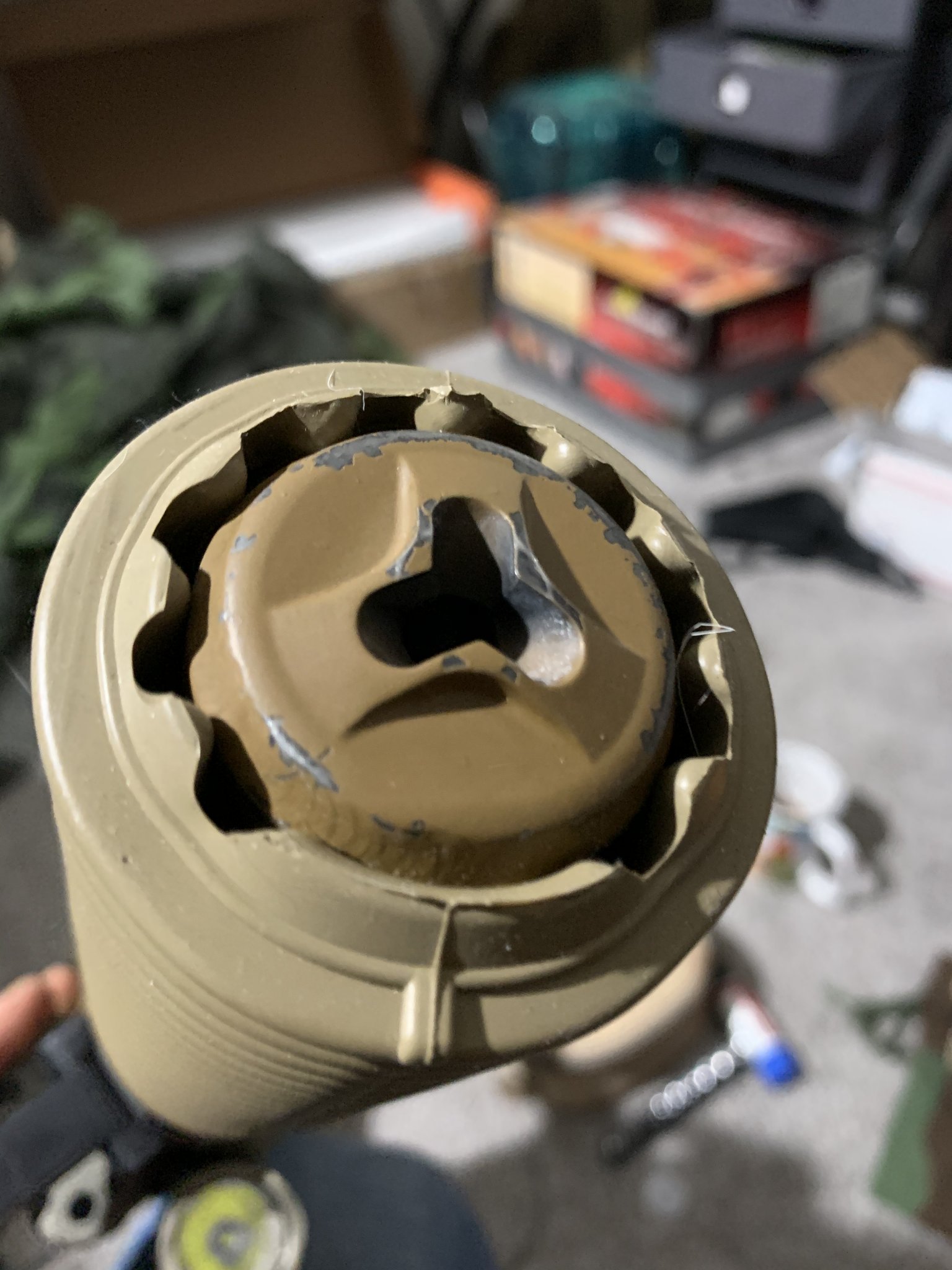

Anyone ever cerakote a muzzle brake?
People finish them in whatever custom finish their barelled action is all the time.
I can't explain how the finish holds up after countless rounds and after multiple times soaking it in chemicals to remove carbon.

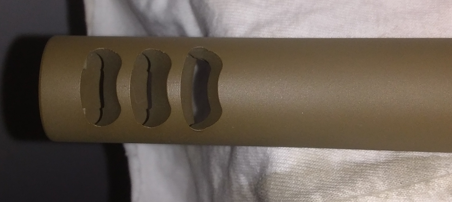

I have two muzzle Brakes from Muzzle Brakes & More - Beast 3 port Brake and both were cherakoted black and are holding up fine.
Here is one on my 6.5 Creedmoor
I will also be putting this in a bolt gun. After only 240 rounds I had a decent amount of buildup and took a lot of effort to remove the carbon. I tried vinegar and water which removed the carbon better than Hoppes but it also removed some of the nitride finish on the brake. Was going to see if I could have APA re-coat the brake for me but then thought cerakote may be a better option.
I’m hoping that cerakote will resist carbon buildup making cleaning easier. I’m not looking to do this entirely for appearance reasons. If cerakote, or even something less durable such as paint is applied and easily wears off then I’ll be back to square one with excessive carbon build up and a pain in the butt trying to remove it.
Prepping surfaces prior to cerakote requires blasting with aluminum oxide. The result is a porous surface. It most certainly should make carbon stick to the surface better.
What I was getting at earlier is who cares about the ports. You never need to clean them to a bare surface. Keep the excessive buildup at bay, but that doesn’t include cleaning to the metal surface.
they used to sell teflon repair paint but it must have been taken off the market...i can't seem to find it anywhere.
wonder if there's something similar out there?

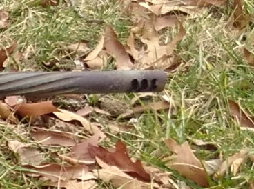

I have 3 titanium brakes cerakoted that I put on AR's. At the most I have a couple hundred rounds through one of them. The coating is fine but yes you still have to clean the carbon. I think it is fairly easy to clean with the coating.
Just wipe off the brake with your girlfriend's panties, kick her to the curb, get a new one and go to the range. Simple.
I've Cerakoted all my brakes and yes, they do get carboned up. Only thing it affects is getting the inside of my rifle case dirty. I just wipe down the exterior and I'm good to go. Has zero effect on performance.

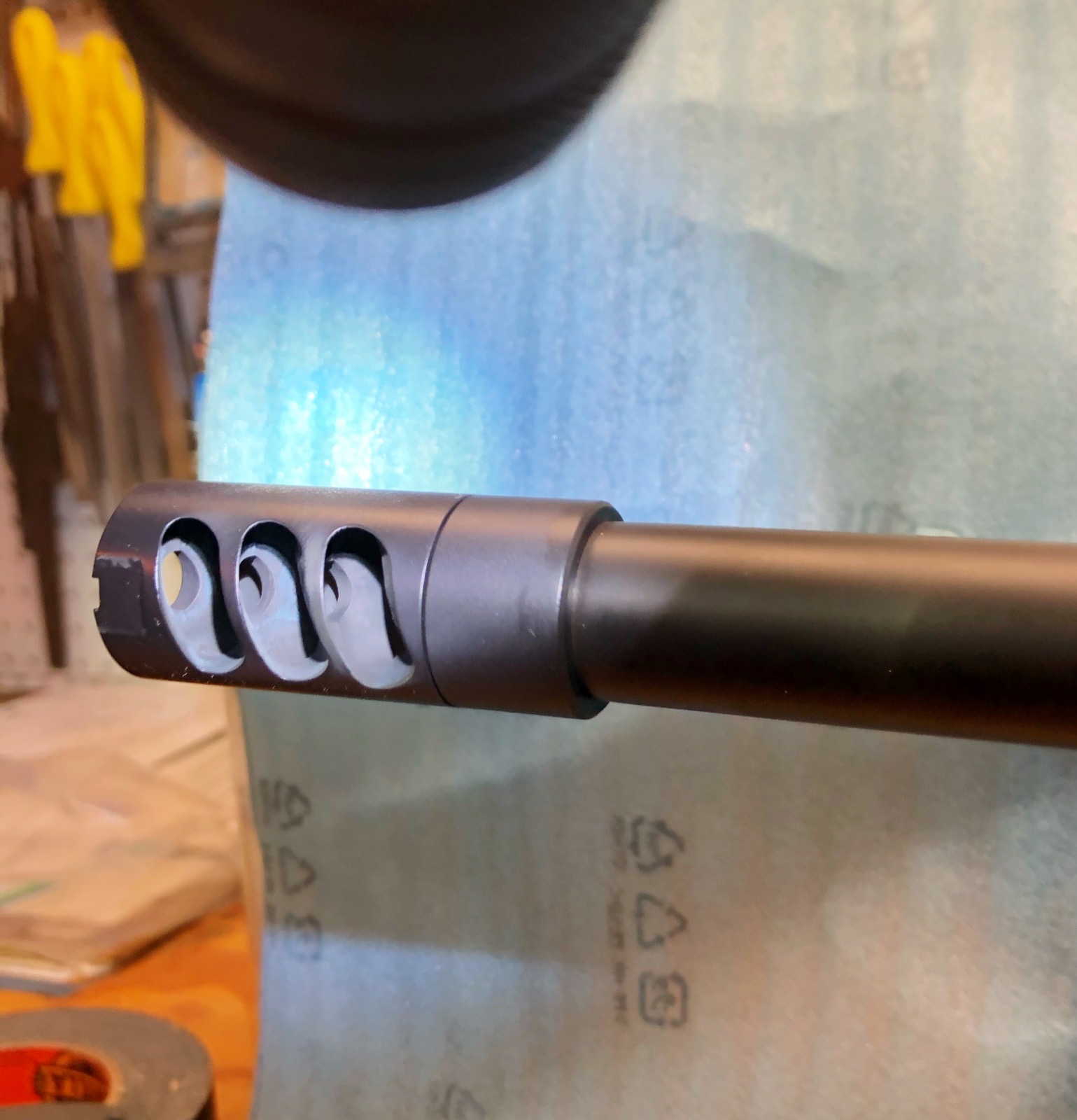

At first my muzzle brake looked like this:
And then after a range day it took a while to get the carbon off the ports. I'd use some 90% alcohol and wipe down the end of the barrel and after a few minutes it would be clean....then I slapped my forehead and said, "Rifles are tools to be used...not little princesses to be photographed."

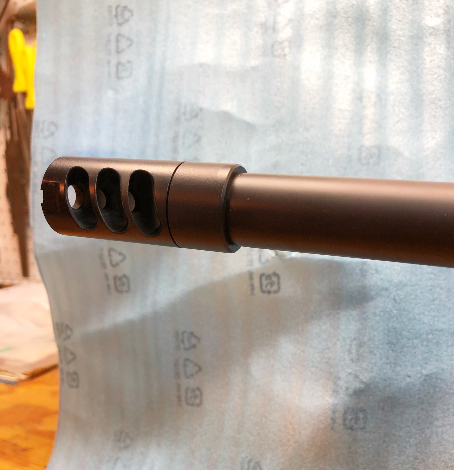

Then I took a trip to Home Depot and now my muzzle brake looks like this:
Now...if there is a little discoloration at the end....who the duck cares? It actually makes it blend even better. Oh...and Cerakote laughs at your question of durability....laughs I say. That's some strong stuff.

I soaked my son's cerakoted MBM Beast brake in C4 after he had not cleaned it for over 3000 rounds. It took a couple of times over a week, but it came out looking like new. I keep a specimen bottle full of C4 just for soaking muzzle brakes. The carbon turns into a sludge and wipes right off.
Reactions: matchbook454
I’ve been soaking mine since Saturday. Removing a little bit at a time with q-tips. I’ve only got 240 or so rounds through the brake though! Hoping the C4 works better than the Hoppes! I first soaked it in vinegar and water and that seemed to remove more quicker but I thought it was discoloring the finish on the brake. Turns out it really wasn’t. It’d been a long day and it was late. Eyes playing tricks on me. I’m getting old!?‍♂️
