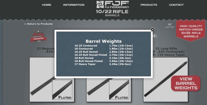

I assume you mean Feddersen? If so, I would buy with confidence. When looking for a lightweight 10/22 barrel it was between Feddersen and Kidd. The Kidd came out a little lighter so that's what I went with.
As far as accuracy, both have good reviews accuracy wise as well as both companies standing behind their product. Check over at Rimfire Central. They have a number of threads on Feddersen barrels.
