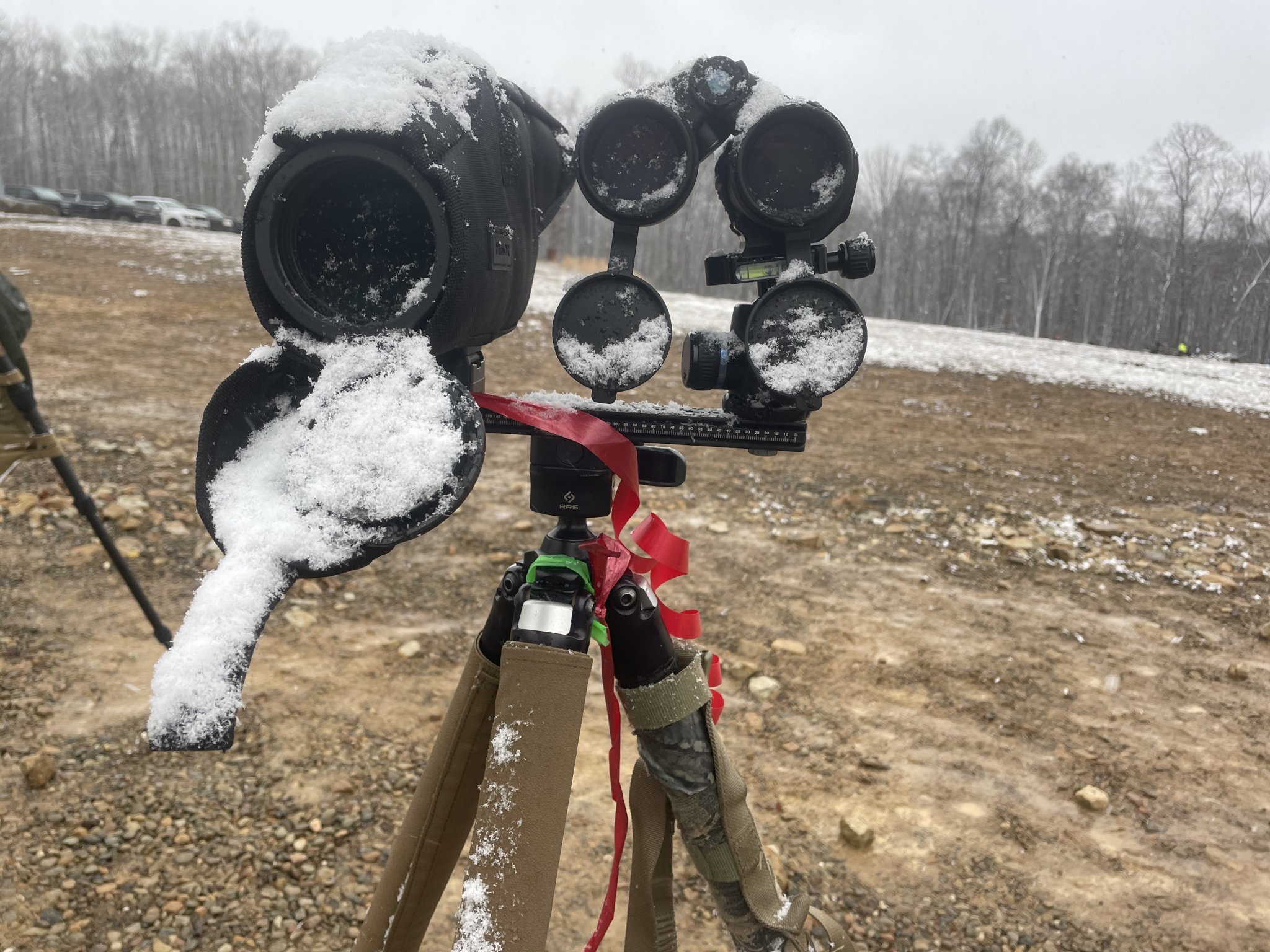

I use a MK4 spotter with TMR reticle on a rail with the lrf binos mounted side by side.
Binos are fixed 10x, offering a wide field of view and good overall picture of multiple targets.
Spotter might be at 20x, to suss out mirage and hopefully make better wind calls looking at dust / grass / splash etc.
Bino's are good but have some limitations.
Spotters are good but also have limitations.
Having both, side by side is a really solid, practical setup I find.

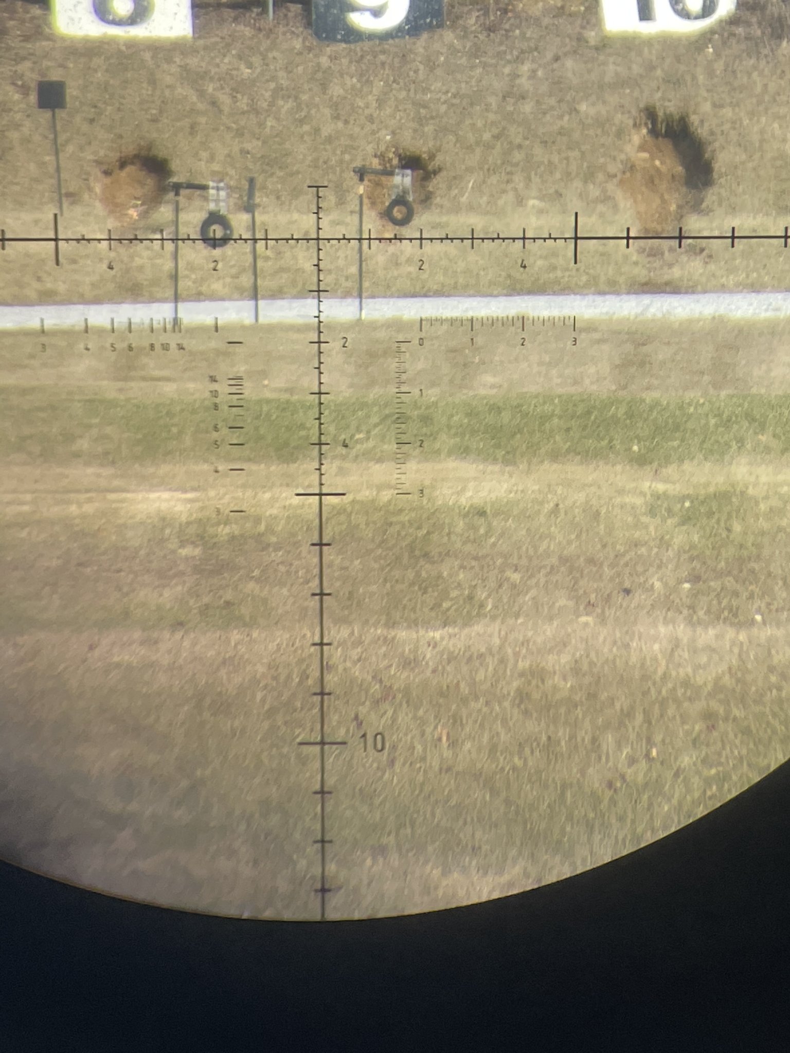

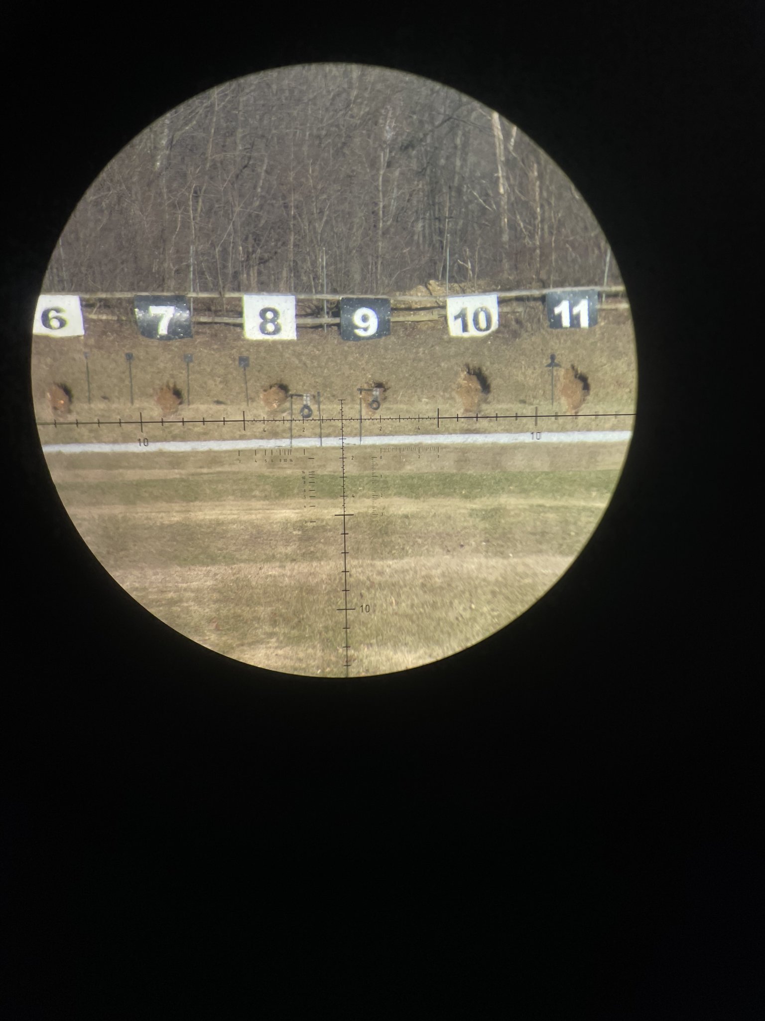

Either the reticle is garbage or the glass is, or something else. The minox spotter has a great reticle, but terrible glass (not the same as zp5 rifle scope). The vortex reticle is really nice and glass aint bad. But you are stuck with 22x fixed mag. Swaro and Hensoldt reticles are pretty horrible. And binos are limited to 15x and not many with a reticle. I know some are fans of stuff mentioned above, but I'm personally not going to use binos with glass less than a Swaro SLC.
Leupold Mk4 are decent glass and some decent reticles. But far from ideal when you're used to Swaro spotter glass and really good reticles like ZCO.
