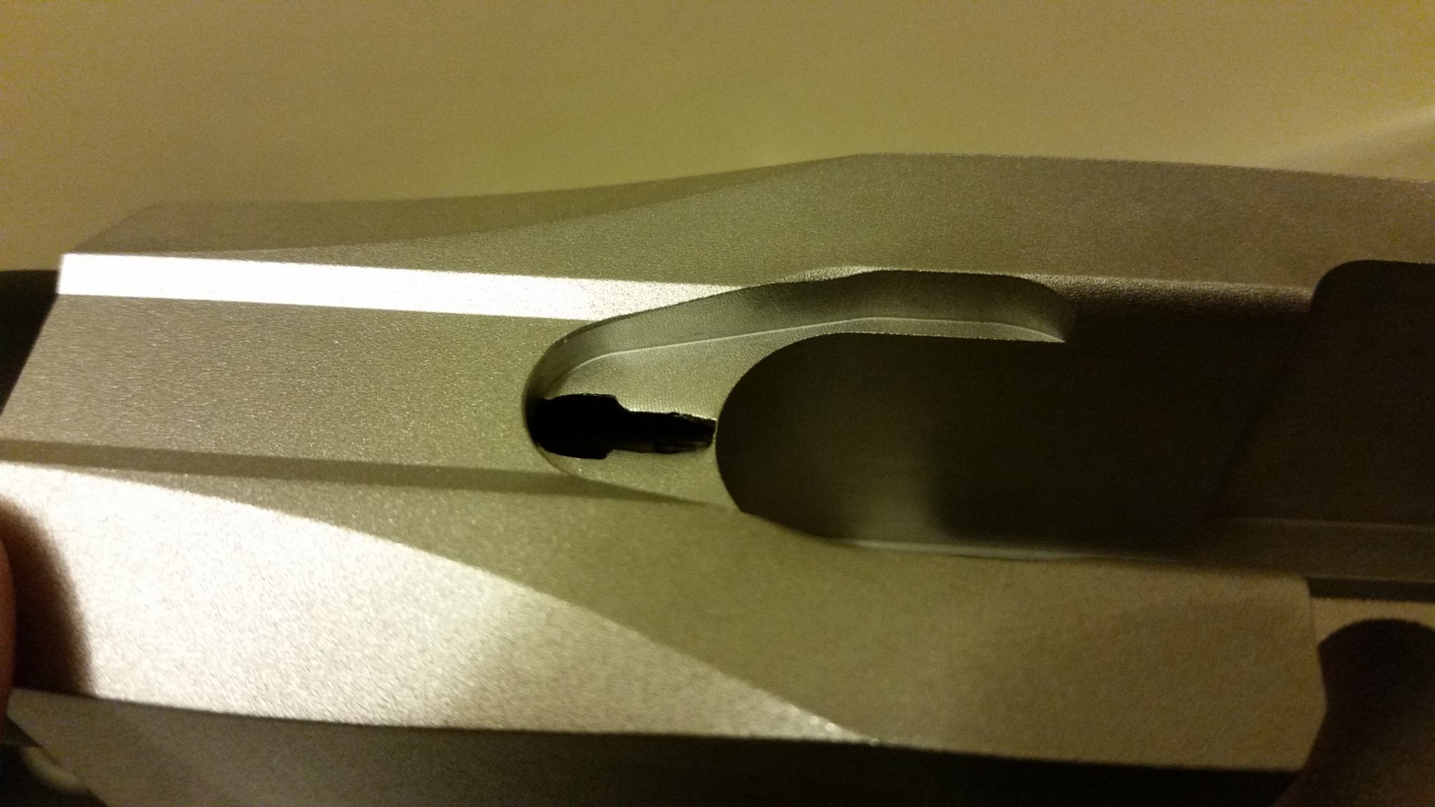

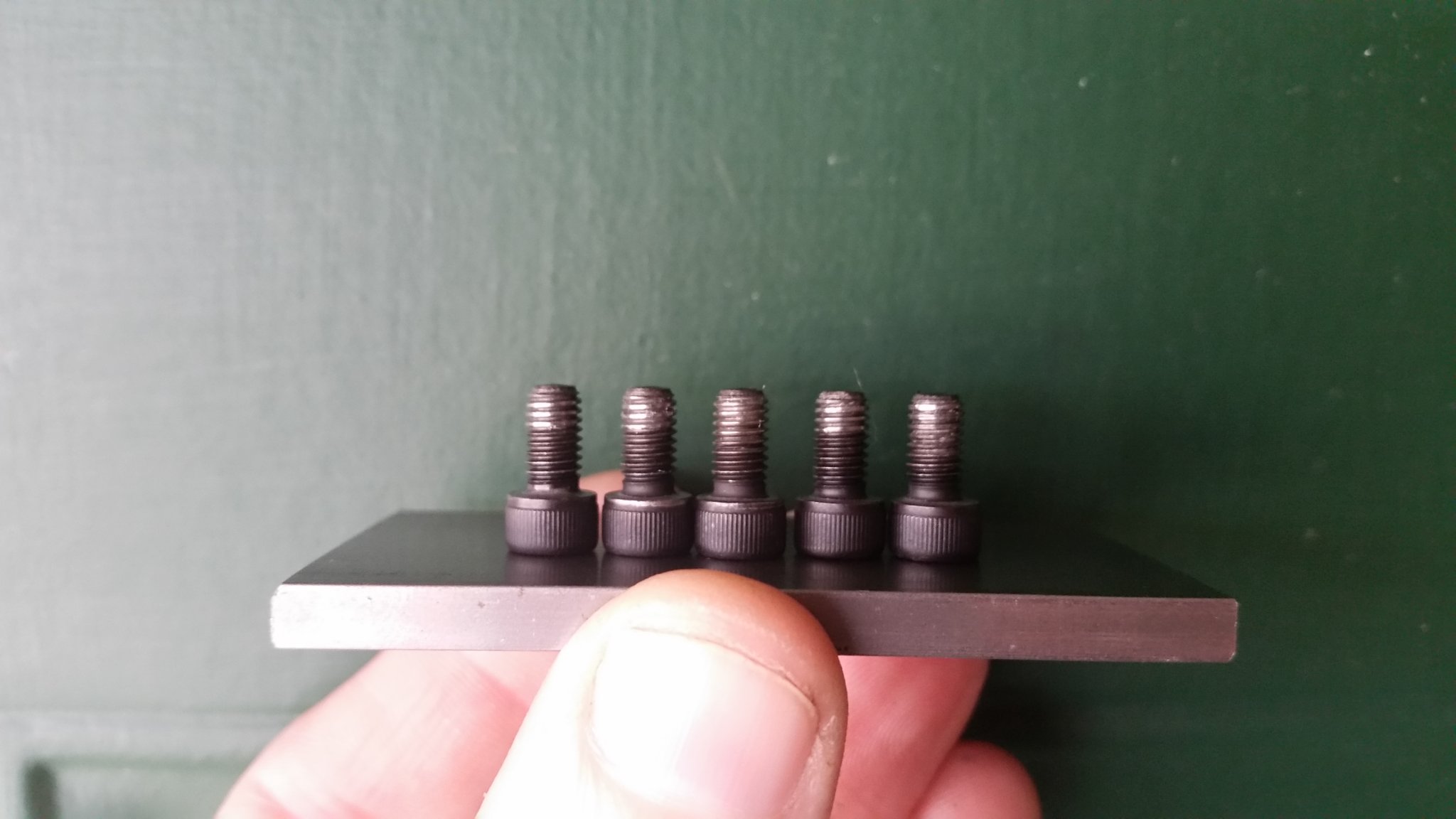

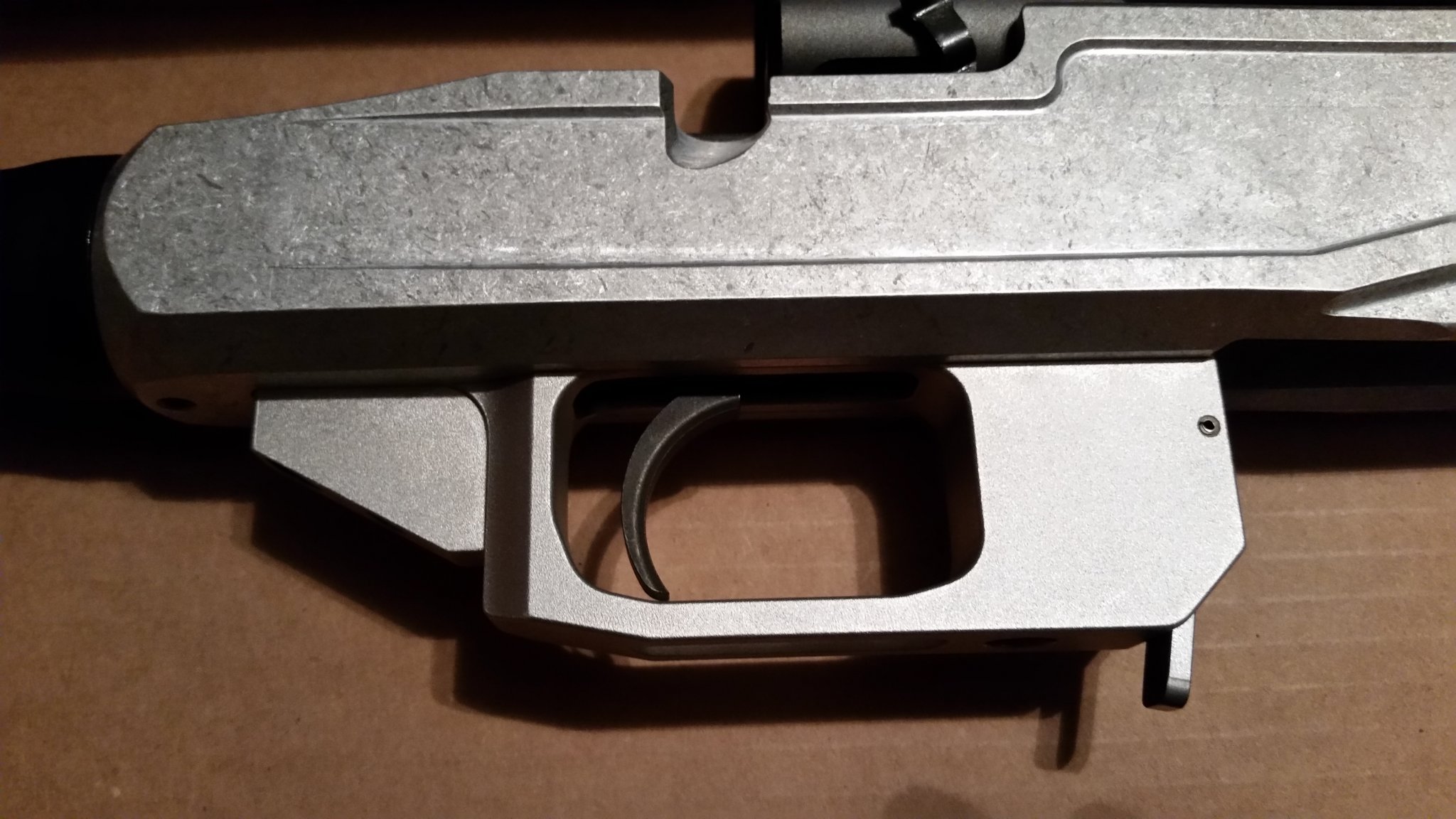

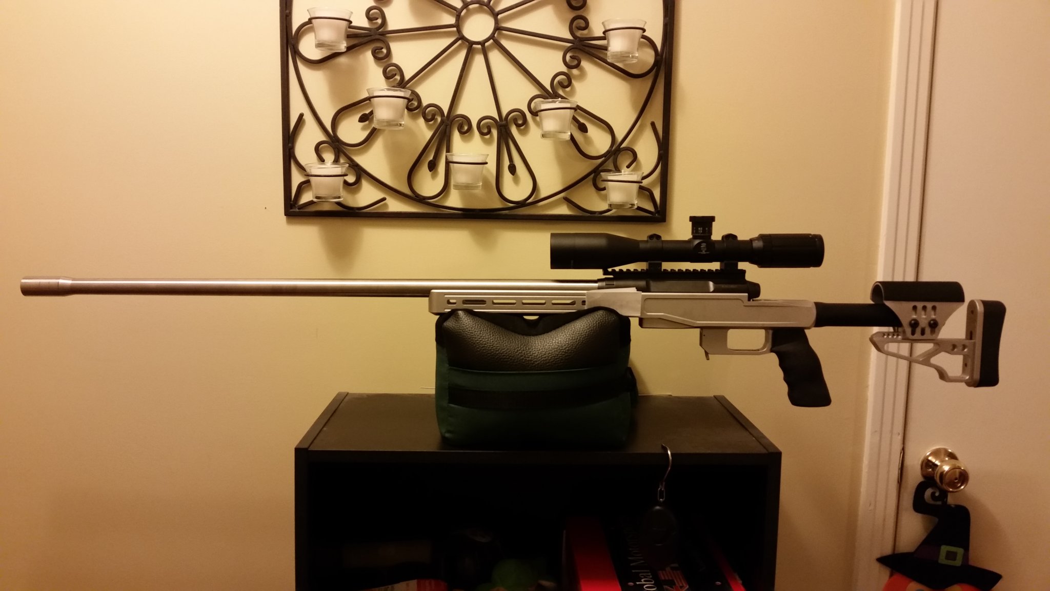

Hello to the hide. This is my first post, and I will try to be as light on this subject as I can. I will leave out all names and company, they didn't seem to be too concerned with the situation anyways so I'm just venting.
To start off I'm very budget minded, so buying a chassis took a bit of mental power to drop that kind of change in the first place. I have owned, and still do several of the Savage Axis heavy barreled rifles. With hand loads and a little time to get the terrible stock trigger down to two pounds, they have all shoot .3-.4s consistantly. That's good dollar per horspower in my world when dealing with under $250 rifles. So I thought why not go all out on a budget rifle.
The build. I started off with a 308 action I had $35 in after the rest was sold off, the heavy barrel being the biggest contributor. I've always love the 7s, just not the all to common belted rem mag, so I decided on the 7/300 wsm. Found an 8 twist lilja 3 grove blank for $200, and a reamer/hs gauge for about the same. I do all of my own stunts as I'm a machinist of 14 years now.
I had it set in me head I was going to drop the coin on a chassis for once. So a year ago I ordered a chassis. These are a bit limited for this platform by the way, and I understand why. Moving on. First chassis comes in with the safey tang area machined into the buffertube well. A couple calls and being talked to like an infant the said they would build me a "custom chassis" as all the rest on the shelf looked exactly the same. The second time it shows up with two different finishes and not grip. After another call and being talked down to they agreed to fix that. The third time seemed to be the charm, minus the greasy prints all over it out of spite I assume. Oh well, bit my tounge and went on.
Fast forward a year to last night. I finally have the action assembled and ready to start load work minus finishing the brake. I throw my floater swfa on it to start getting the stock fitted. Break all the hardware loose and it feels like everything has blue locktite, a bit odd but of well. After I get all the hardware out it's apparent the hardware was ran into the bead blasted holes...still full of media.
Am I the only person that has had a bad experience with a claimed top notch chassis company? I have never heard or read a bad word edge wise about them, which is what sealed my decision. Anyway, that has been resolved with a trip to the hardware store and a few minutes chasing all threaded holes. I hope to get the brake done in the next week or so so I can work up some loads and HOPEfully enjoy being around this thing for once.

I did by straight from the source, yes. After the phone calls I went through the first of the year, I will not call back. I made it clear the chassis was for a rifle that wasn't yet built. In that same call I was assured it would "shoot 10x better than the rifle did from the factory"(another issue), and "it's only a $200 rifle".
My main issue was he was set on replay telling me why the problems didn't matter for my "$200 rifle" rather than trying to work with me. They did resolve the first issues after I asked for a refund if they wouldn't be fixed. Maybe I'm expecting too much from what I thought was a top end company. In the companys defense I did only exchange calls with the one that took my order(yes he is at shotshow). Last night just started the fire again.
Also, the finish is raw blasted aluminum, as ordered. The second time it was sent back was after another exchange of being told the finish doesn't matter since ceracoat would stick fine. I have no plans on "finishing" the surface, that was also made clear when ordered.

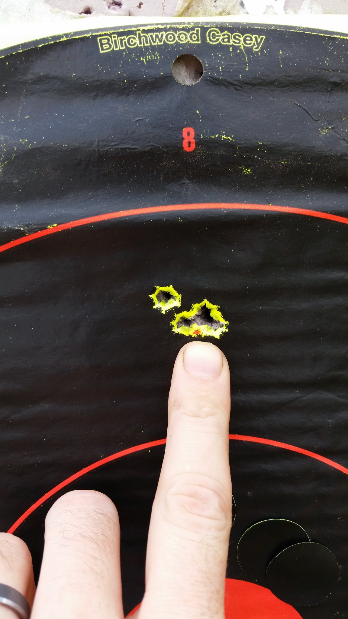

I do have a technical question. I may be better served asking in loading, but I'll save the space if possible.
Has anyone ever lost accuracy going from tuperware to a chassis? I don't know if it's harmonics or what, but I have a load(105 amax over h1000) dialed in to my 243 heavy barrel. Shoots consistent .3-.4 at 100, and 1/2 moa or better out to 675(furthest shot distance). I dropped in the chassis just for giggles and it goes straight to patterning, not grouping.
The first pic is a 5 shot with cold bore(flyer) at 100yd. Second is at 200yd in the chassis, the hpbt group being the 223, the pattern being the 243.
Am I going to have to revisit the 243 loads if it goes into a chassis? This has been a solid load for over 300rnds and a couple steel matches to 500yd.

A barreled action can have different harmonics/vibrations depending on how its mounted. So, yes, it's possible for a "good load" to not shoot as well when the barreled action is moved from a stock to a chassis, or some other combination.

That was kind of my thinking, just not what I'm used to seeing. Being the 7/300s permanent home, I guess I will dive into that issue with the next chassis and the 243.
