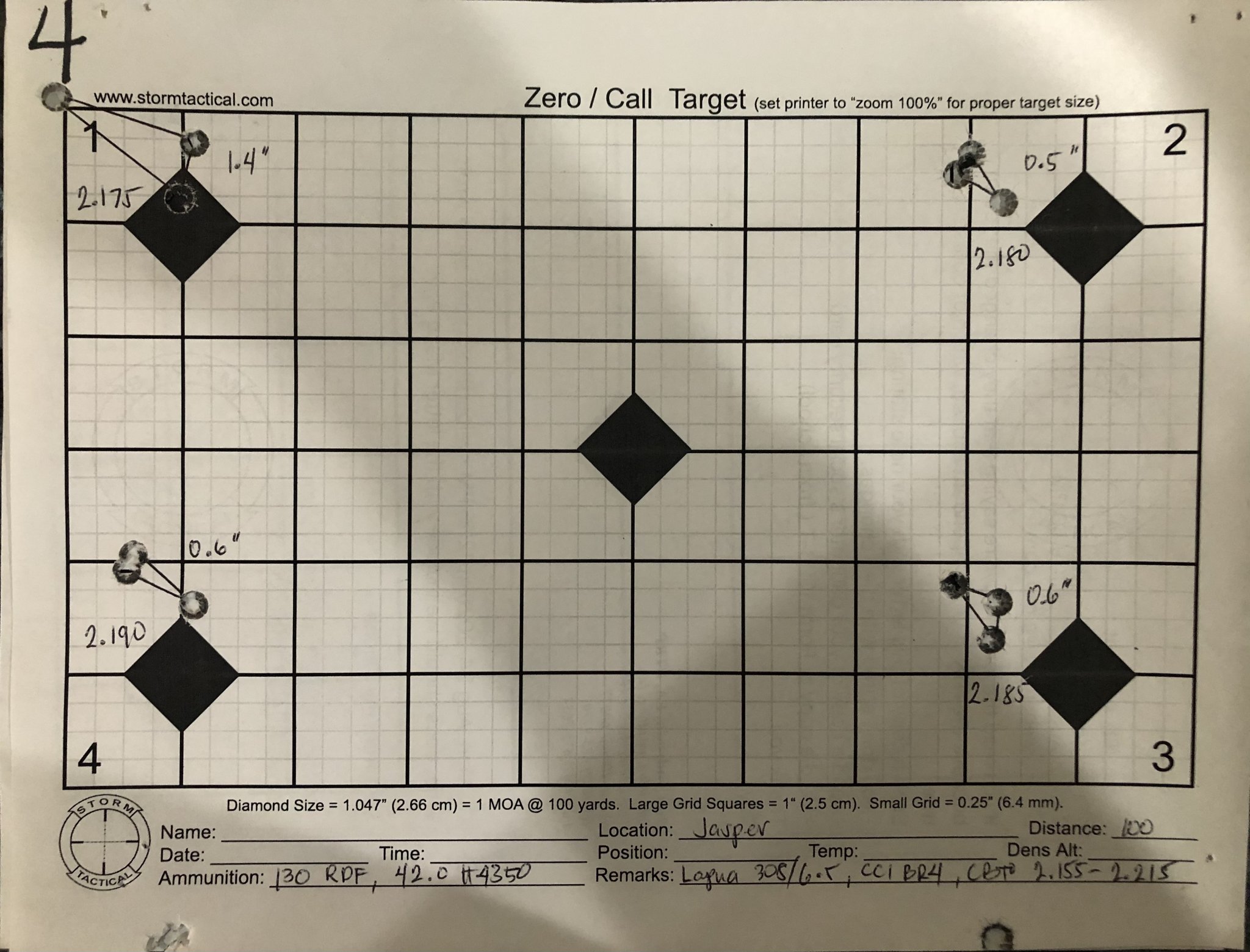

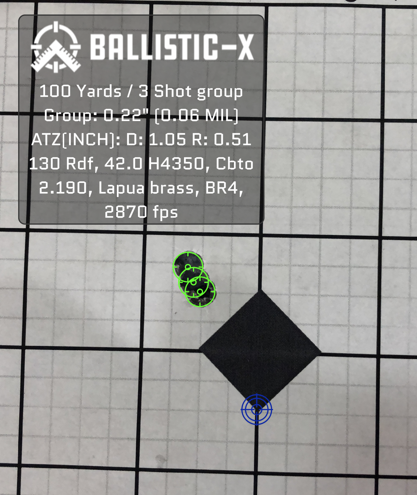

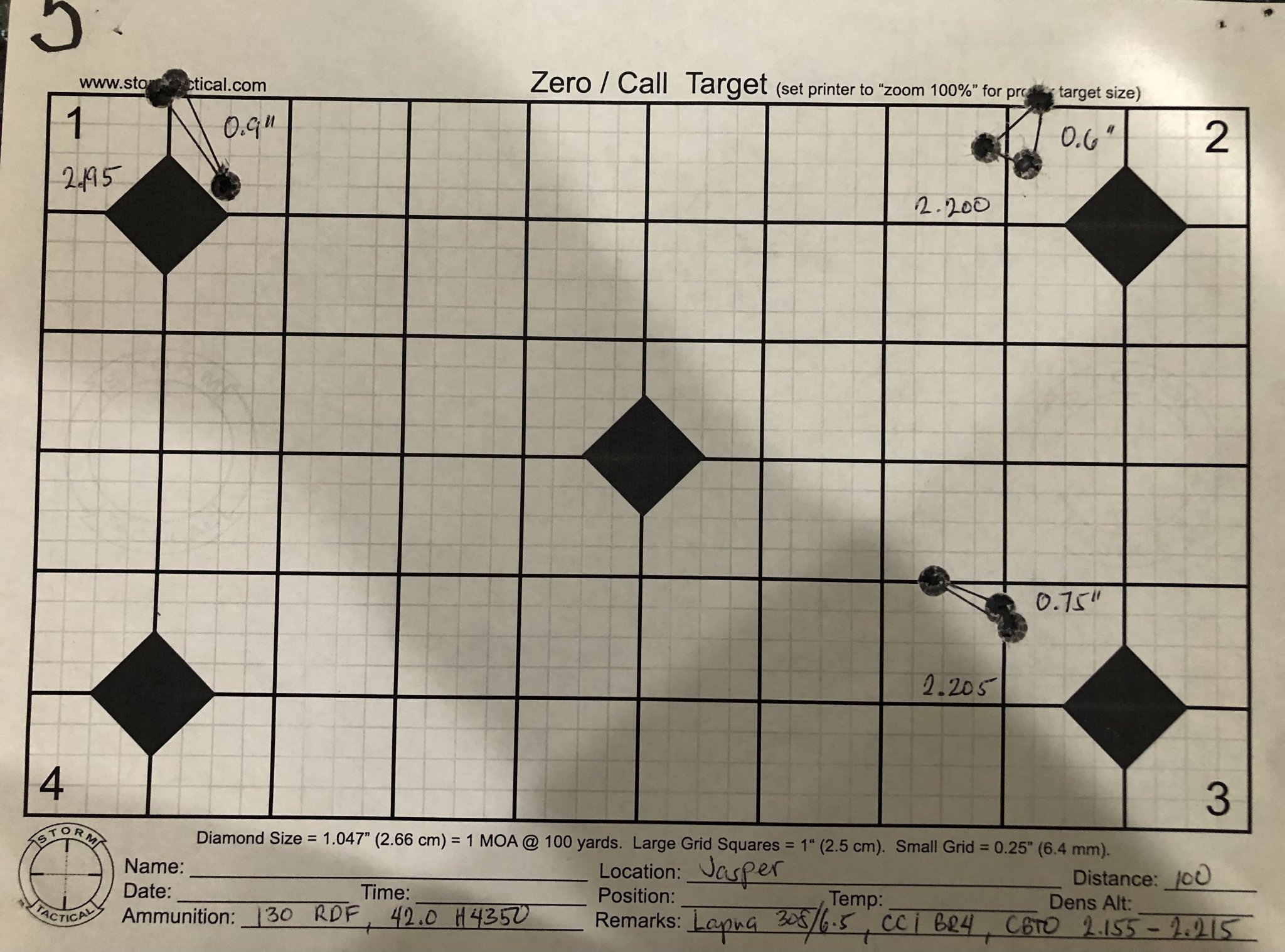

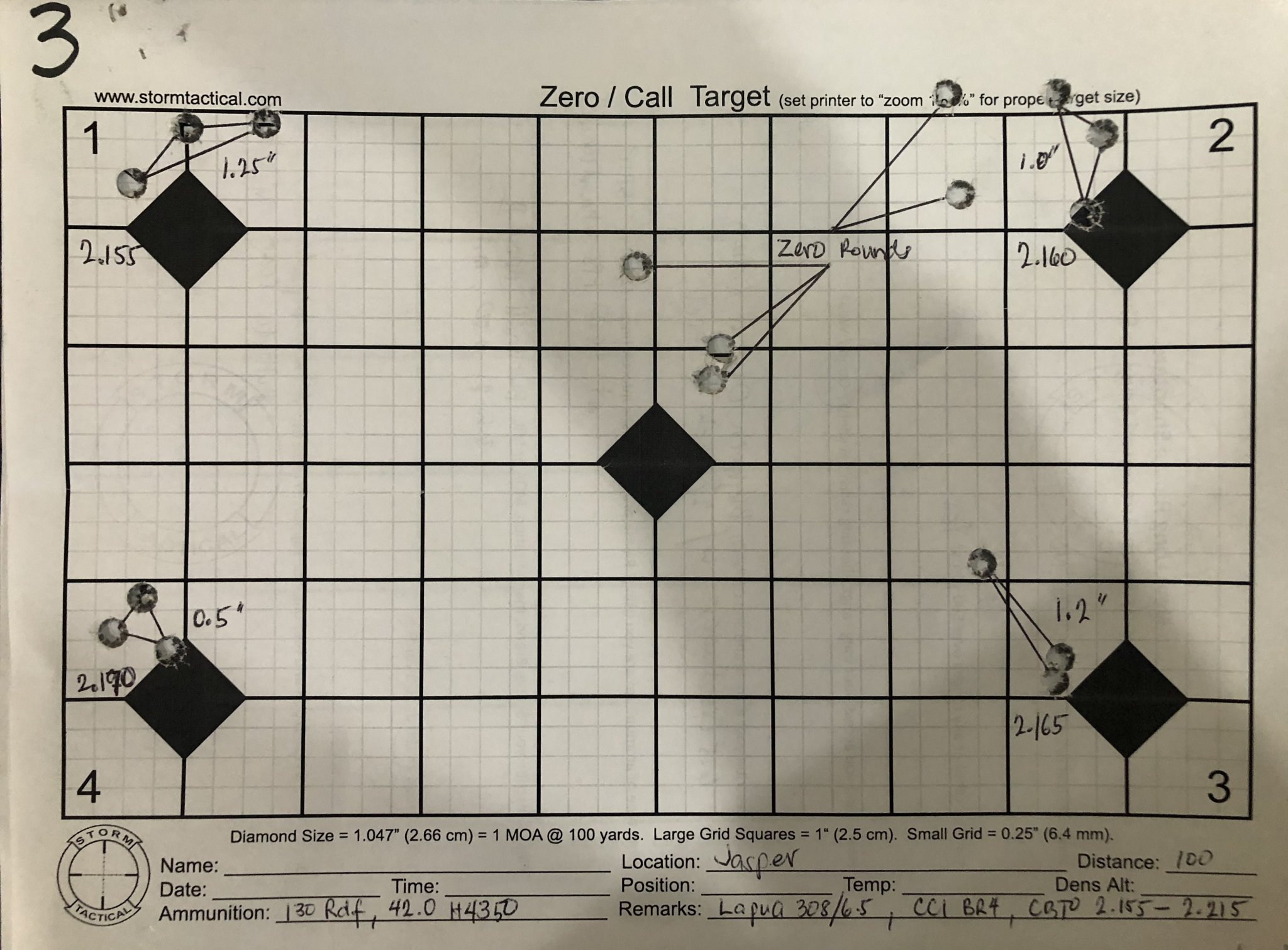

When I did a seating depth test for my Tikka T3x Tac A1, it has a long throat, so seating close to the lands was impractical. I tested 0.030, 0.060, 0.090, and 0.120. I ended up going with .90 because the 90 and 120 jumps shot best. That way, as the throat eroded away, I would have an area of jump that would stay at 90 and erode out to 120. Make sense?
I used the concept of the Berger Seating Depth Test and below were my results:

I did an initial bullet seating depth test with 130Rdf using a light load of 42.0gr H4350. The Cbto into the lands is around 2.200in. Seating appears to be more forgiving at 0.030-0.040 off.
431205B0-A09C-452B-943B-7FACE51C635B.jpeg160D1F54-25FE-4923-8738-57E203B2DF44.jpeg920C36C1-5AC6-49E8-8ECC-93E27646027C.jpeg
With 3 rounds left, I seated the bullet at 2.190 to confirm. Results look promising and will do further testing.
