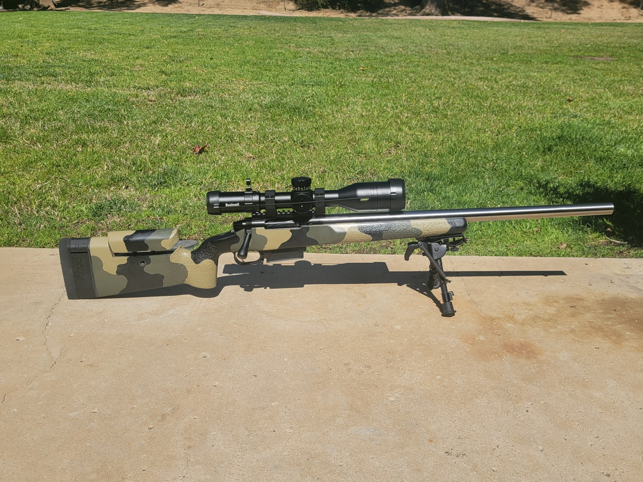

Thought I would update this since I've had a couple people ask me and there's very little information out there about these stocks. I ordered the stock mid November and it shipped mid January. I had them ship it to Terry Cross for his loggerhead cheek hardware install. Awesome guy to deal with and flawless work. McMillan didn't install the spacer length of pull system like I had on the order form so I had to send it back. They got me a label quick and did the work in a timely manner so no big deal, looks good now.
The butt end of the stock feels really good to me. It is a 6° angle on the bottom vs 9° on most other stocks so it allows for a more gradual adjustment on a rear bag. It's also flat so it stays pretty stable. Should be a good cross between a tactical stock and a bench stock. I like the nice wide A5 style forend. Should be good for shooting off various bags. The kmw hardware is very nice and it's all the little things that set it apart from McMillan's clamp bar hardware. I might have to do a separate thread on that as I have not seen a direct comparison between the two.

I really like that paint job…
