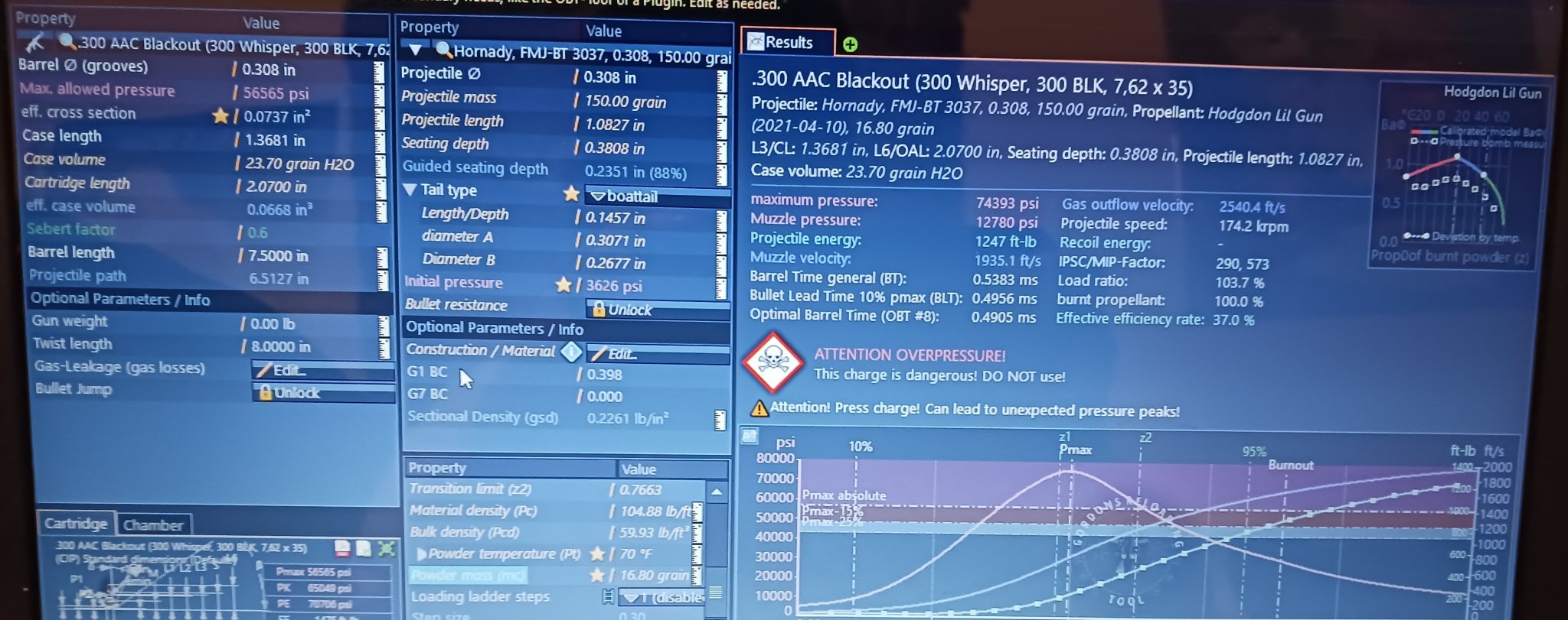

Idk man, I'm inputting book loads into it and it's saying they'll all frag.
  • Wow
Reactions: Jscb1b
Idk man, I'm inputting book loads into it and it's saying they'll all frag.View attachment 8408913
Double check the book value for COAL. QL is showing 2.260 for that same load, which is quite a bit longer than the 2.070 I see on your screenshot. Max pressure is only 40761 and velocity is 2088. QL also shows that load to stop burning before the bullet exits the muzzle on a 28" barrel.
This is why I got QL, to play around with different parameters to learn things
I did, Lyman AR Reloading handbook 2nd edition. 2.075.
Interesting. I checked my Hornady book...for that bullet it shows 2.090 COAL with maximum safe load of 15.7 gr Lil Gun. But it also states a maximum of 2.260 COAL for the cartridge which is what QL is showing. Maybe that's magazine maximum?
Seems to show it's best to look at mutliple sources for information....
Reactions: MO Fugga
The shots start pressure is mainly correlated with where you are in relation to the lands and as long as you stay away from them, you can leave it at the default value.
The vast majority of the time with quick load, I am getting velocities that are way higher than what it predicts, but not getting high pressure. Whenever I have adjusted the start pressure, it did not affect my velocity appreciably it just made the pressure even higher, which exacerbates rather than alleviates the discrepancy that I most frequently encounter.
As others have stated, to get things to line up you have to change the powder burn parameters
I find QL most useful for getting a ballpark idea of what a the effect will be of changing one variable when starting from a known set of parameters. For example, if I’m at 135 grains of H50BMG, no pressure signs and a given velocity, what will the ballpark velocity gain of 2 grains more powder or two more inches of barrel, or changing to RL50 at a load predicted to give the same pressure?
I have NOT found it useful for starting from scratch and predicting results. Whenever I try that, this is what happens: it tells me I can put in 142 grains of H50BMG and be below max pressure and get 2800 fps (Cheytac). But I run into pressure at 136 grains, and get 2900 fps with 134 grains. So I always start well below what QL says will be a max load. This is the opposite of the published reloading data where I can usually start at/near a max load and go higher.
Reactions: johnnyvw
Agreed. It’s a very handy tool if you use it to test things at a pretty coarse level. It saves me a lot of time choosing which powders to test, and gives me a rough idea about pressure and velocity. But it’s not ground truth, only prediction. Sure, it can be tuned to give you more accurate results to the ground truth, but that can take a lot of work and be localized to a single cartridge.
Yeah, by the time you already know what the load does and you’re trying to get quick load to align with that reality, you’re already done. It’s quick loads problem at that point not yours.
