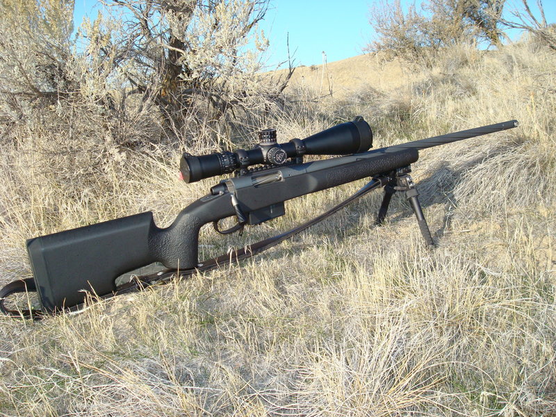

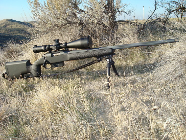

My A5 comes in at 2.25 lbs with the Edge Fill. Fixed LOP and cheek piece. A great long range stock that is easy to pack. Ready to roll rifle comes in at 10.5 lbs.

Bighorn action, McMillan A5 with Edge Technology, Hart 6.5 Lapua barrel, contoured like a Remington VS that I turned all dimensions down by .050. 1.200 shank and .780 muzzle at 25". Saves .5 lbs. and fluted by me and saves another .5 lbs. 2 oz muzzle brake by me. Jewel trigger and NSX 5.5 X 22 Scope. Ready to roll at 10.5 lbs. A joy to carry and shoot.

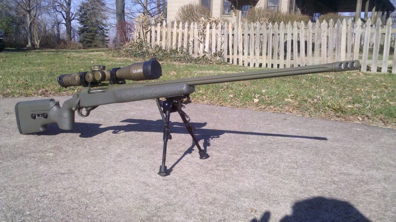

Here you go. My favorite build to date.

338 Edge 28" barrel....totally agree with having a sloped bottom of the stock for adjustments. Rifle has been all over Alaska and Wyoming on my back, Tools are heavy.
I should add that the adjustable comb is useless and would not do that again(hard to keep clean) in favor of the cheap plastic version.

Why is the adjustable comb useless and hard to keep clean? I have never seen an A5 where the comb height is not raised 1/4" to half an inch!
Agree, I always have to raise mine almost 1/2 inch, without it it's impossible for me to get a sight.
Sent from my SM-T810 using Tapatalk
Ok, I shouldn't say useless but the same can be accomplished with the Karsten Kydex cheek piece. For me the added hardware in the stock has to be protected from the elements and we are talking about a hunting rifle subject to rain, snow etc.. Not debating the need to raise the comb height.
I own 2 of these stocks and it's just something I decided I didn't need along the way.
