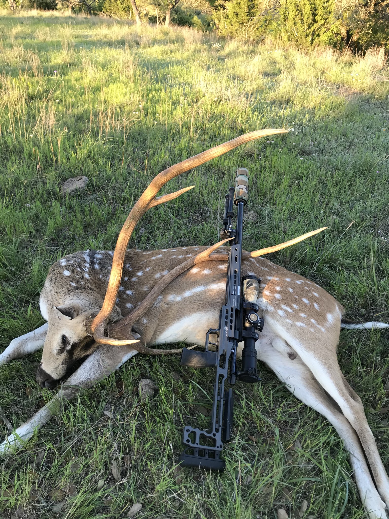

I have a TL3 in an MPA ultralite. I run a WTO switch lug and have a 22” 223 barrel for a light and fun trainer and an 18” 6.5 Creed Proof carbon barrel for killing deer. The rifle weighs 10 lbs with the Proof and a 4-16 ATACR. 223 is a blast and super easy to swap barrels with the WTO SL.
