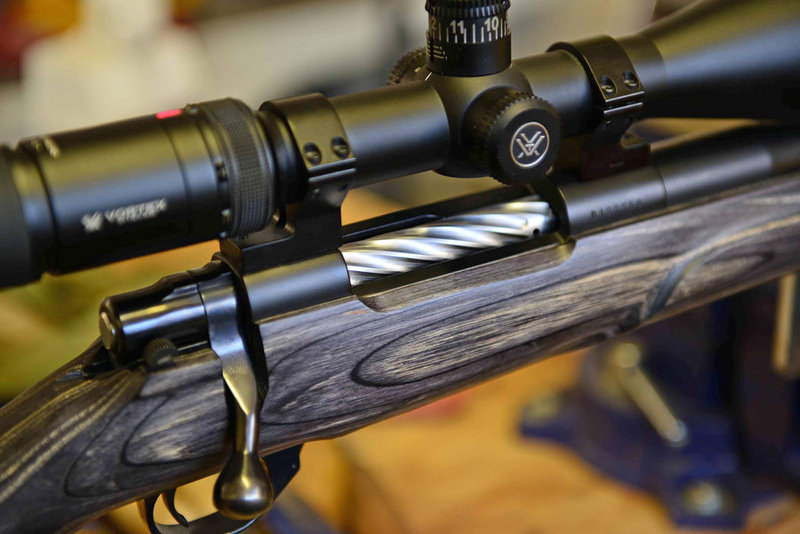

    SH Fellers,
    I got my Howa Mini bolt back from Paul at Pro Precision Rifles and thought I'd share some pictures. He was able to Vortex-flute my bolt, although due to the smaller diameter of the mini-action (compared to a short-action) he did have to build a new fixture. Also, due to the hardness of Howa bolts, he only offers Vortex fluting at this time.
    [IMG2=JSON]{"data-align":"none","data-size":"full","src":"https:\/\/farm5.staticflickr.com\/4641\/38606342865_b50257dc0a_b.jpg"}[/IMG2]IMG_6203
    [IMG2=JSON]{"data-align":"none","data-size":"full","src":"https:\/\/farm5.staticflickr.com\/4729\/38793613164_fbdd006820_k.jpg"}[/IMG2]
