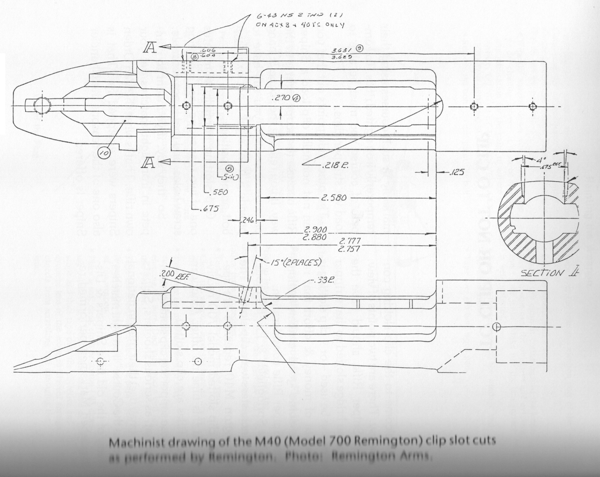

I'm doing an M24 inspired build and managed to get my hands on a set of Redfield Palma irons. Both rear and front.
I got the mounting plate that screws to the action. Even got a 1975 era Rem 700 rifle that came factory drilled and tapped for side mount peep sights.
Problem is that the head of the screw that came with the action is too small to hold side plate on.

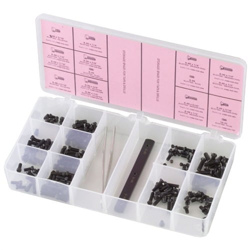

You're looking for a 6-48 fillister head screw. Brownells has full kits and 12 packs. You can always cut them if they're too long.
