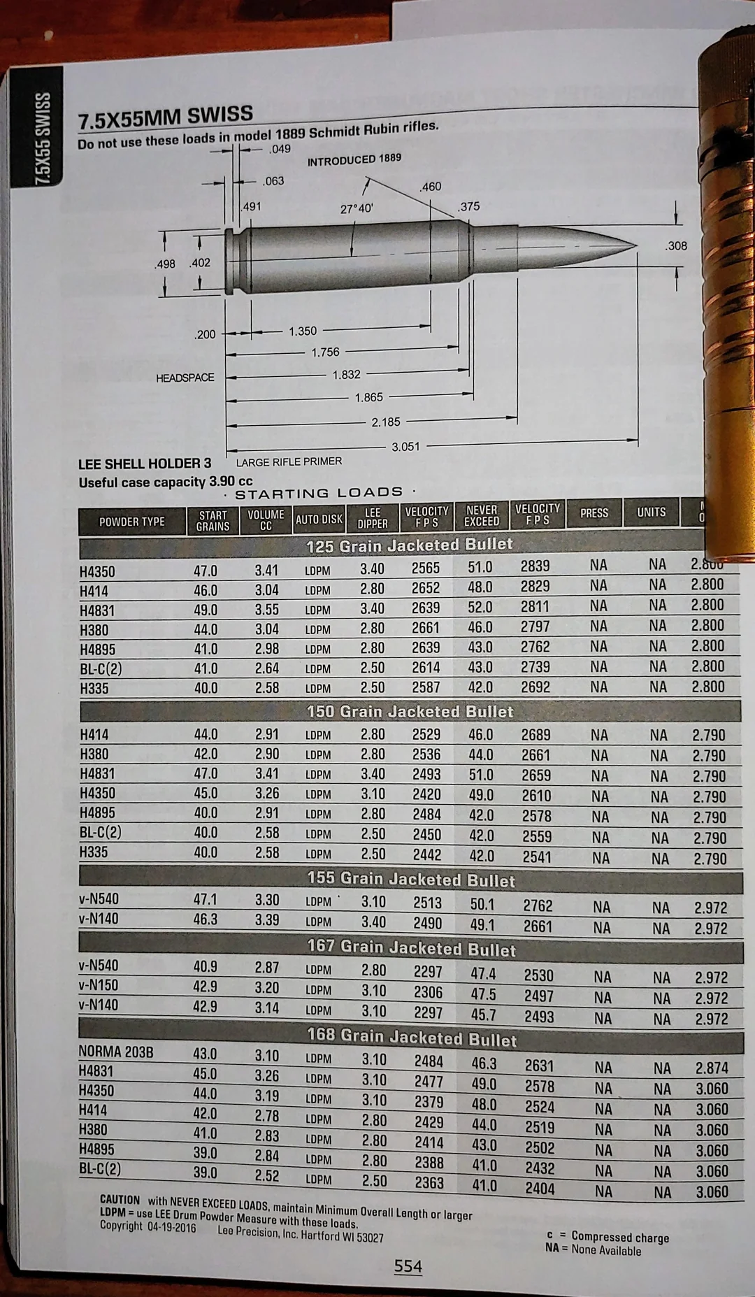

Looks like RL17, IMR 4350 and IMR 4064 are the go to's. I've got no data for RL17 in my books though, and none of those powders on the shelf. Yet.
Any hide favorites to start with?

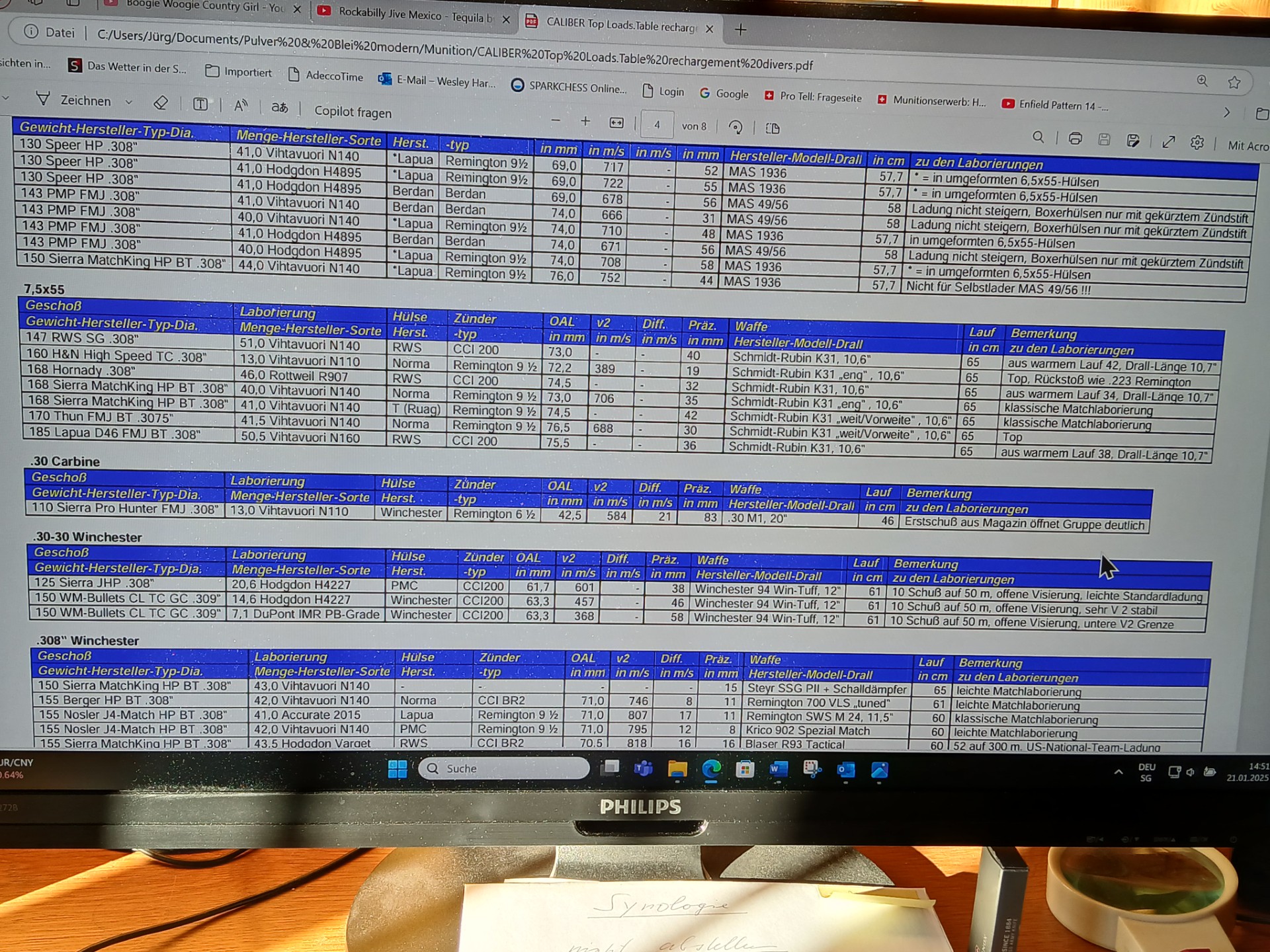

I literally dug my 1911 and K11 out of the safe yesterday. Dusted off the load notes. Dug out the dies. Prepped some 3 year old cases.

I promise this isn't this way because I collect Swiss guns... But the 174 ELD-VT ended up being surprisingly close to the GP11 bullet and should be a good fit for 7.5x55 and probably even.30-06. Should be available in a couple weeks, we're just wrapping up the final testing on these.
When I get home, I’m sure it is listed in several older reloading manuals and I’ll try to dig up what they have with powders still in production.
I've been through, Sierra, Hornady,older Hodgdons, and an old Lee manual. 7.5x55 Not even listed in Nosler nor some of the Hodgdon.
RL17 isn't in any so far. My Lyman manual is pre RL17 and not sure if the cartridge is even in there.
Mine go back before any of the manuals you listed even existed. I’ll still look. Gonna be a week though.

Hmm... There was in a European gun-magazine some 7,5 xx5 mm Swiss-Reload-Data.. A while ago...
I do not reload but sometimes i work together with reloading colleagues and range-neighbors. The 7,5 x 55 mm Swiss is an interesting cartridge, technically, ballistically and historical seen. And for me too the very first rifle-ammo at all. In other words it's my Hometown-Equipment, yes.. .
In the above mentioned reload-data I saw quite different bullets, powders and charges in comparison to here.. I'll have a look and if I find that.. :p
If that's ok ? ;)
Perhaps a foretaste.. ?
