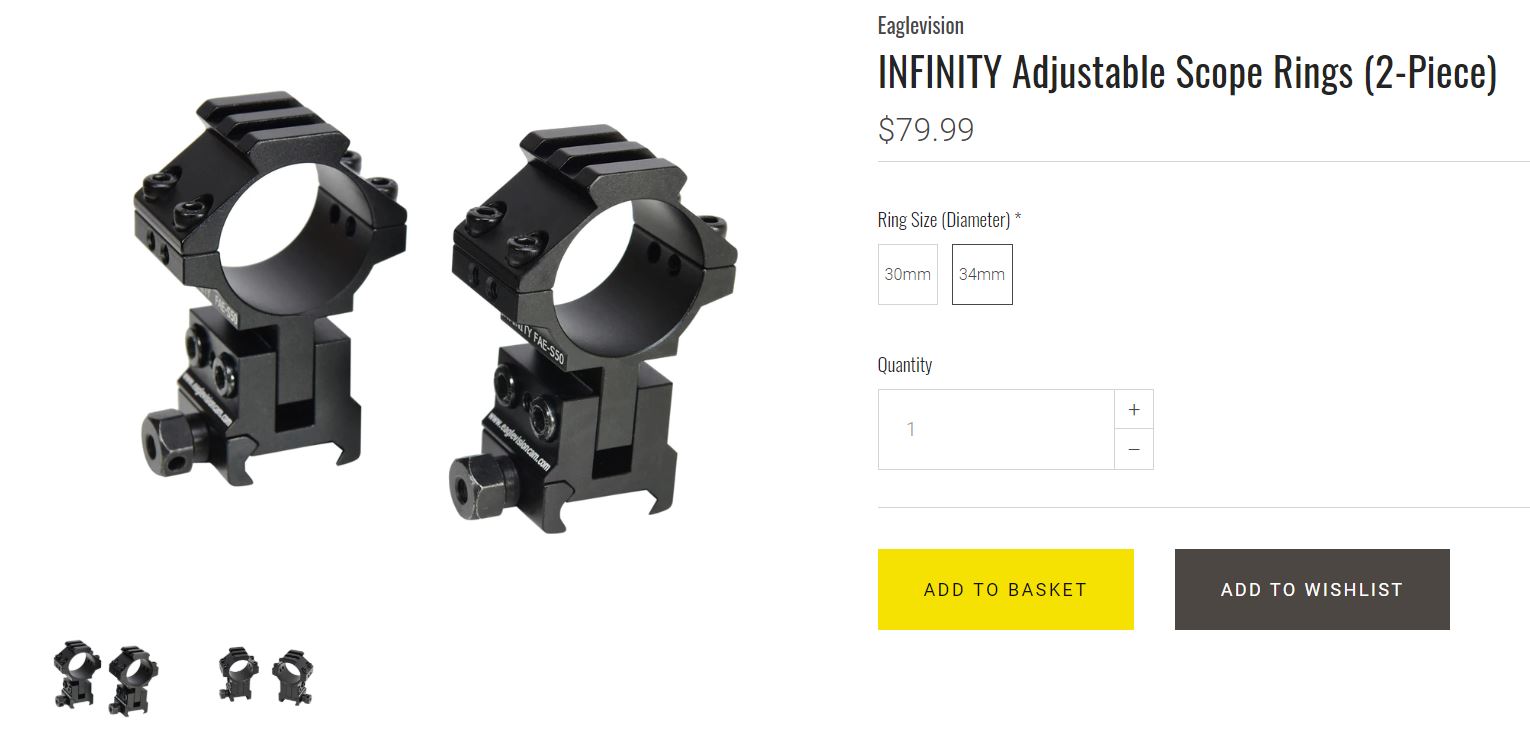

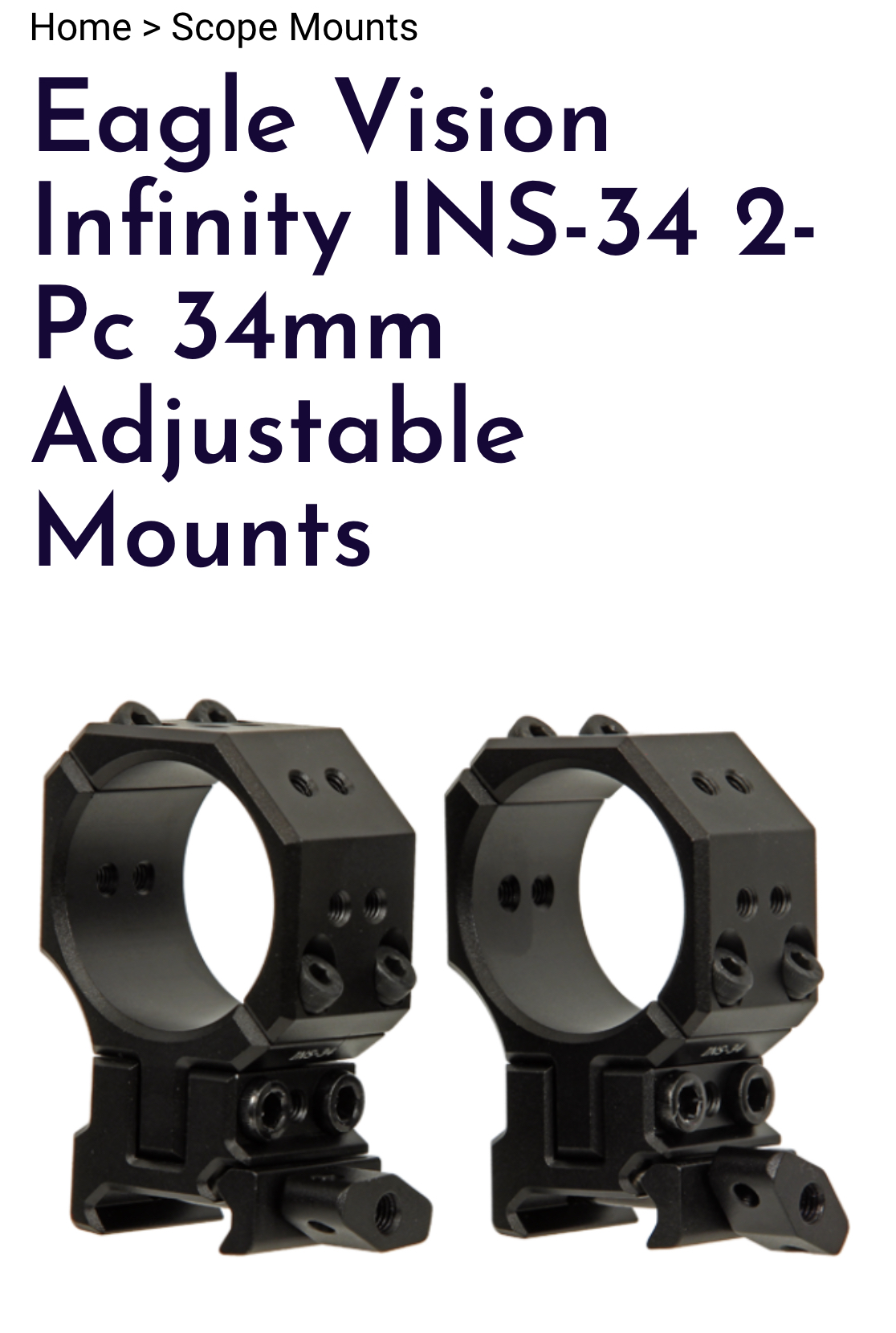

Airgun’s of Arazona sells 34mm adjustable rings I just got a set for my 22lr that I’ve been shooting at 430 and 500 yards. I think eagle vision makes them

Awesome find! Thank you! I found them at Utah Airguns as well.
They would probably work ok for an air rifle that doesn't have recoil which is what I would buy them for. I don't think I'd trust them to hold zero with a powder burner.

I have them on a 22lr and they are fine for that but definitely not going to use them on anything bigger then that. They are pretty high and thats a bummer but made it to where I can shoot out to 500 yards with my 22lr.

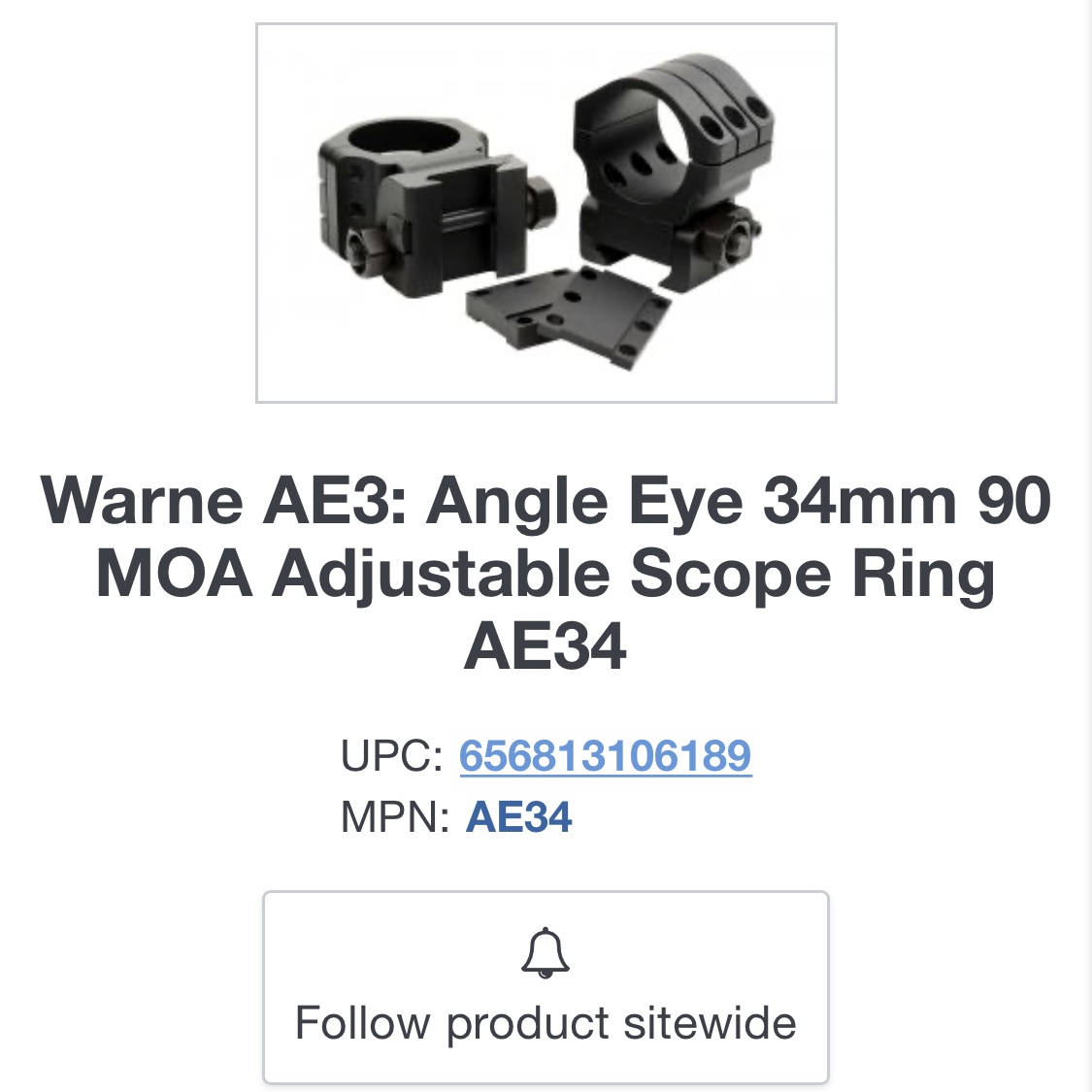

Apparently the first half of my reply didn’t post so I edited it. I would try a ring with 20 moa or more built in
Not sure what we can link to. So here is a screenshot of some from an article about taking a 300 prc to 2,000. I don’t know any details like height, etc.
