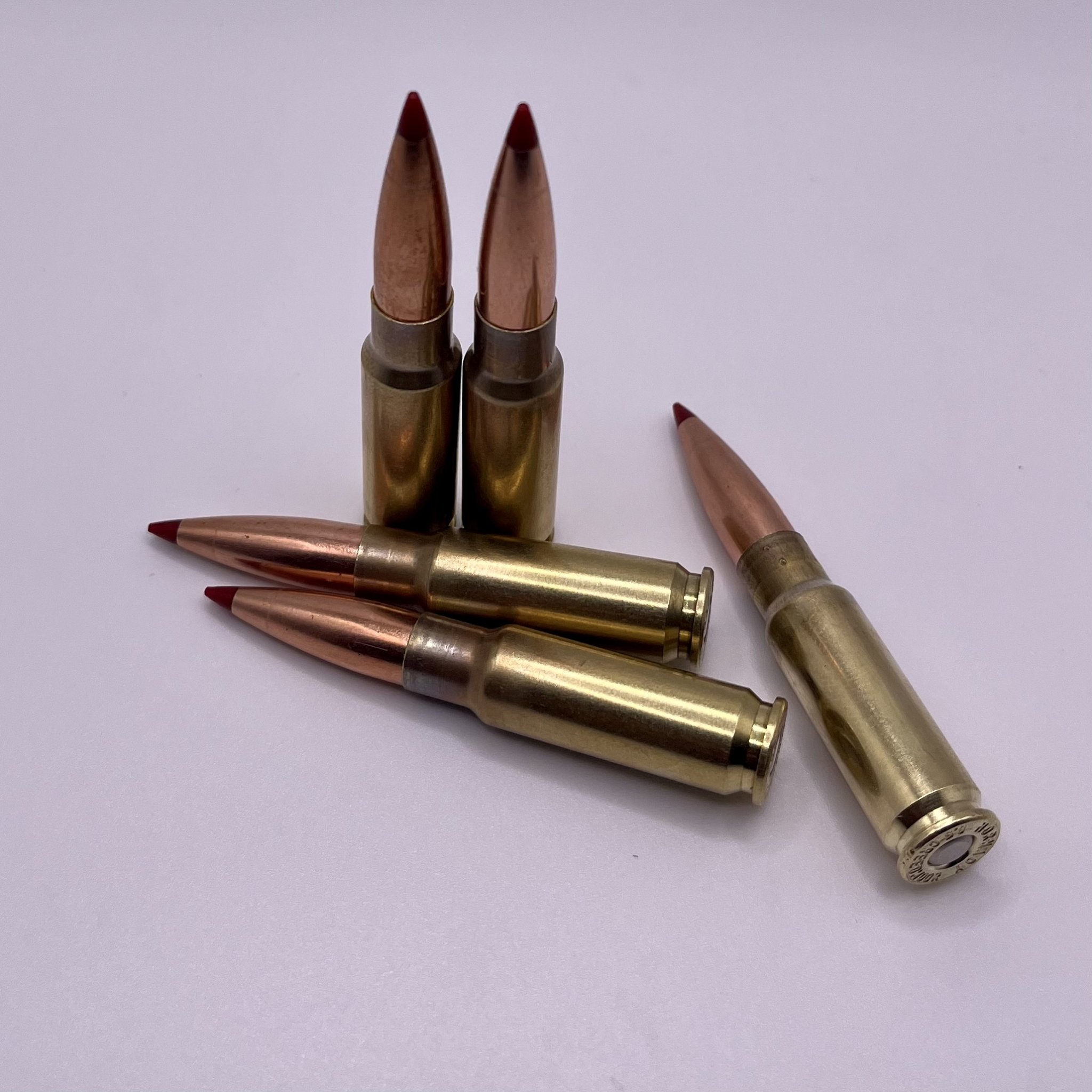

I also manufacture 8.6 Blackout ammo. I use once fired Hornady 6.5 brass, I anneal them in a AMP annealer, then size, anneal again, then final size and trim in a Honey Badger Case Trimmer and load with Maker 350gr Rex for hunting and Hornady 285gr ELD-M for target. All subsonic. I’m a licensed FFL manufacturer. Before I ship out I check them in a Sheridan case gauge. Ammo comes in a white 20rd cardboard box with styrofoam trays with my company logo and caliber.
EDIT - forgot to mention, if you save your brass I can reload it and it’ll save you money.
