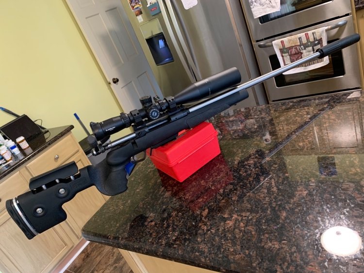

Finished breaking in the Savage 6mm ARC in GRS Stock. Over 100 rounds now thru it and starting load development. Originally a Savage 10 6.5 Creedmoor. Re-barrel to 6mm ARC and changed out the Bolt face to a PTG PPC Bolt Face. 24" 1-7 twist Shaw Barrel. Using MDT Metal Mag SA-12 Round 6BR Magazine. The 224 Valk Magazines will also work. Savage GRS 1.jpg
I'd be tempted to switch a Mini I have. As far as why a bolt gun in 6mm ARC, the same thing was said about all the "lesser" cartridges on same caliber. Kinda like why bother with 6.5Creed when there is 6.5PRC. I truly enjoy my 6.5Grendel and even with all my friends using Creedmoor I have not felt lacking for my needs. To each there own. Ying vs Yang
