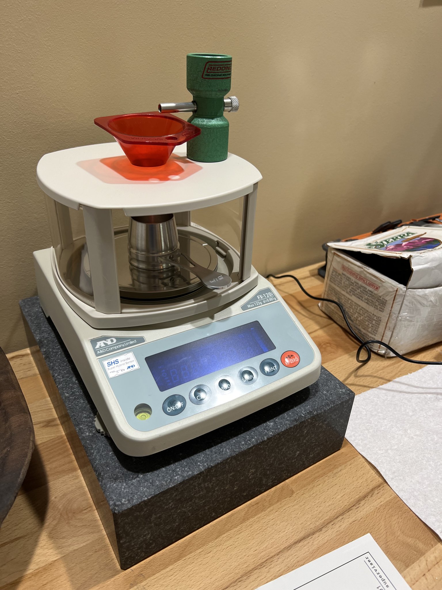

I've got the FX-120i, as I mentioned before and I've had the Ingenuity Precision Powder System order to go with it (ordered it about year ago and am expecting it next month). Also, as I had previously mentioned, here's a picture of my current setup, which I find faster, more accurate and more consistent than my ChargeMater-1500:

Note: My Frankford Arsenal Powder Trickler you see in my picture mounted on top of the FX-120i hasa clear plastic tube attached on the end so that I can actually see how many kernels are about to drop. To drop a kernel or more, I simply tap the turning grip, either lightly, heavily or multiple time to get the amount of trickle I need for the exact target weight. If, on occasion more than I need drops in, I've got that little yellow scoop to take out what I need for the correct weight; it doesn't happen very often. That clear straw on the end really helps with controlling just how many kernels are dropped; it's a time saver.
I’ll more than likely do something like what you have done because I’m cheap. Did sitting the trickler on the scale like that not effect the weights or anything?

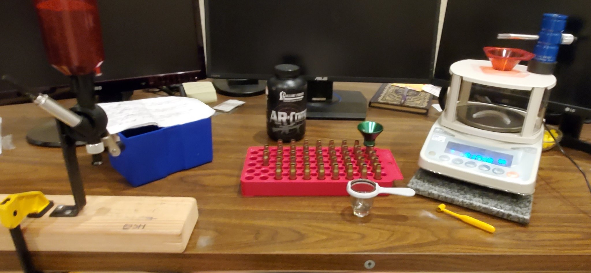

Manual trickler setup I used (and no, the trickler sitting there on the lid doesn’t affect the scale because the windscreen and lid don’t contact the platen of the scale, they contact the scale housing):
IP Trickler setup I’m currently using:
The manual thrower is mounted to the press.
What’s the block under it?
