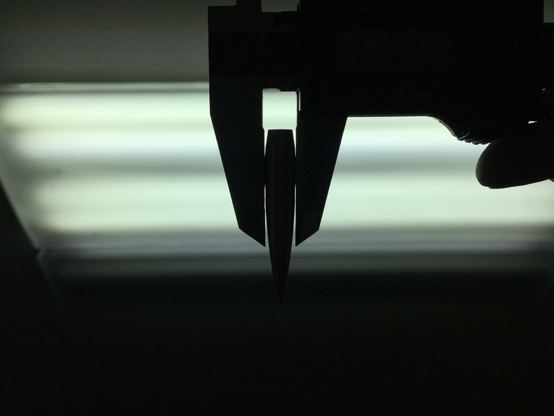

You can see from the caliper photo that there are several contours along the bullet. The nose, just forward of the major diameter, engraves partially. Whole lotta nose on these things.

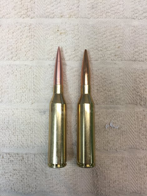

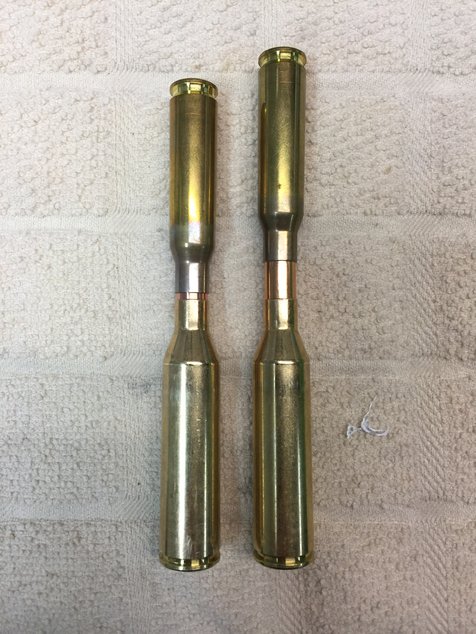

The other photos are 300 norma dummy's I put together before ordering a reamer. I'm only posting these so you can get an idea about the bullet profile. The two cases pressed down on the bullets are fl sized .308's. Graphic example of how little full groove depth bearing surface they have. The 230 berger looks pretty underwhelming next to the 198. If I magazine lengthed a 256 in a lapua, I might lose the bullet down inside the case LOL. Never tried seating them short.
