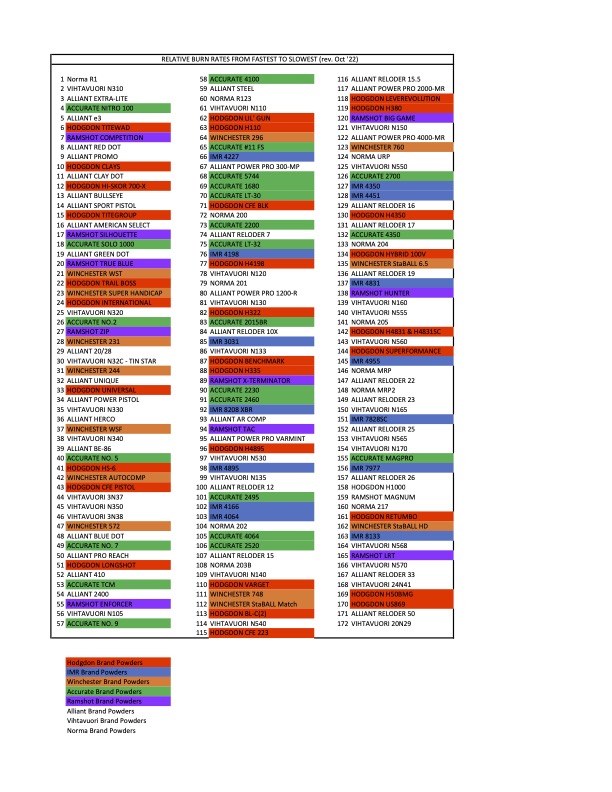

So, looking at the chart and what I can get locally, Varget, Staball Match & 6.5 should do well for replacing H4895 and RL-15? Both shot lights out with 120g TTSX, but I’m out and can’t find either powder now.
That chart is straight from Hodgdon's website, so I'd say it's pretty accurate.

I thought so, just contemplating the benefits of which one to run with. The problem comes in with having 5 different 7-08’s to load for. Even with good labeling, it gets messy when Memsahib, Jr or Mom just grabs ammo.
StaBall Match is supposed to be the same burn rate as Varget, but in a spherical ball powder compared to an extruded (Varget) powder. But if you can get Varget locally, I'd stick with Varget since we all know it's been proven to be temp stable over the years. I just ordered another 10 lbs. case of it because most of my target rifles use Varget (.308 Win, .260 Rem, etc...) and I have some great loads for 7mm-08 and others with it. But if you can find StaBall 6.5 locally, grab a pound and see how well it works. Or, grab an 8 lbs. jug just incase it does work great, then you're covered for a while. But with only a 120gr bullet, Varget would be about the best option. Pushing something in the 150+ grain category, I'd say step up to StaBall 6.5 for the added velocity and slower burn.
Well, Varget will be fine from 120-180gr bullets if you wanted to. Hell, I've got a few loads for .308's with 210gr bullets and Varget, and they shoot amazing...But they're SLOW (2,300-2,400 FPS range). But you will get max performance with 150gr+ bullets using StaBall 6.5 in the 7mm-08.
Well, I have a pound each of Match and 6.5 to work with. Will just have to see which works best with mono-metal bullets. The joys!
