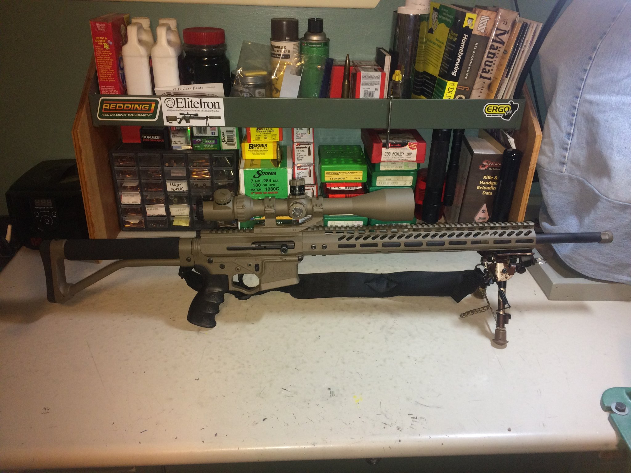

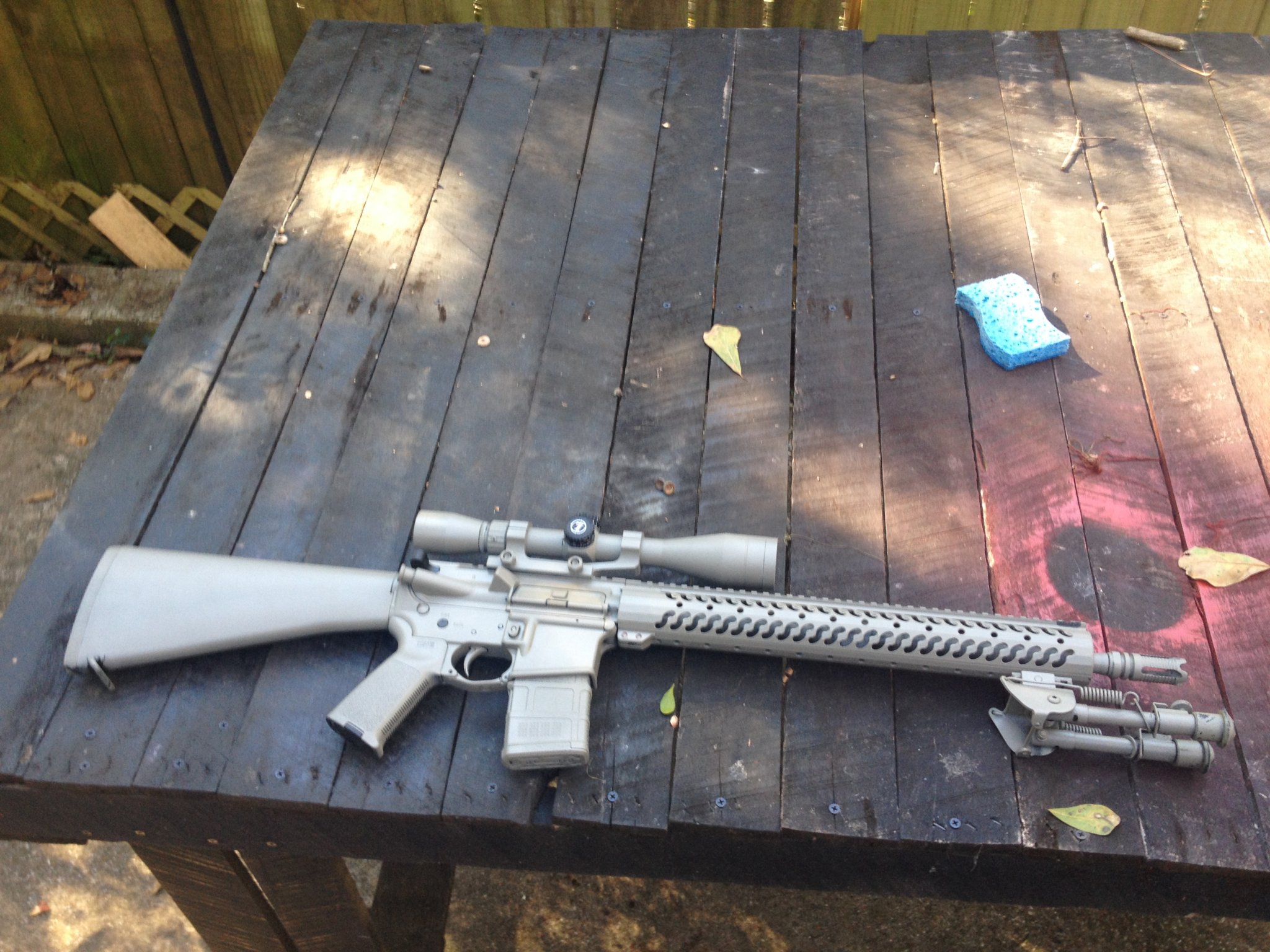

A couple OD Winchesters, the long action sitting on the can of spray has the metal done in Parkerizing Gray
Coyote on the frame and slide.....it isn't as gold as the picture would imply.
All stocks pictured have a light coat of truck bed liner under the paint for texture. As with the paint, allow it to fully cure, then apply color.
