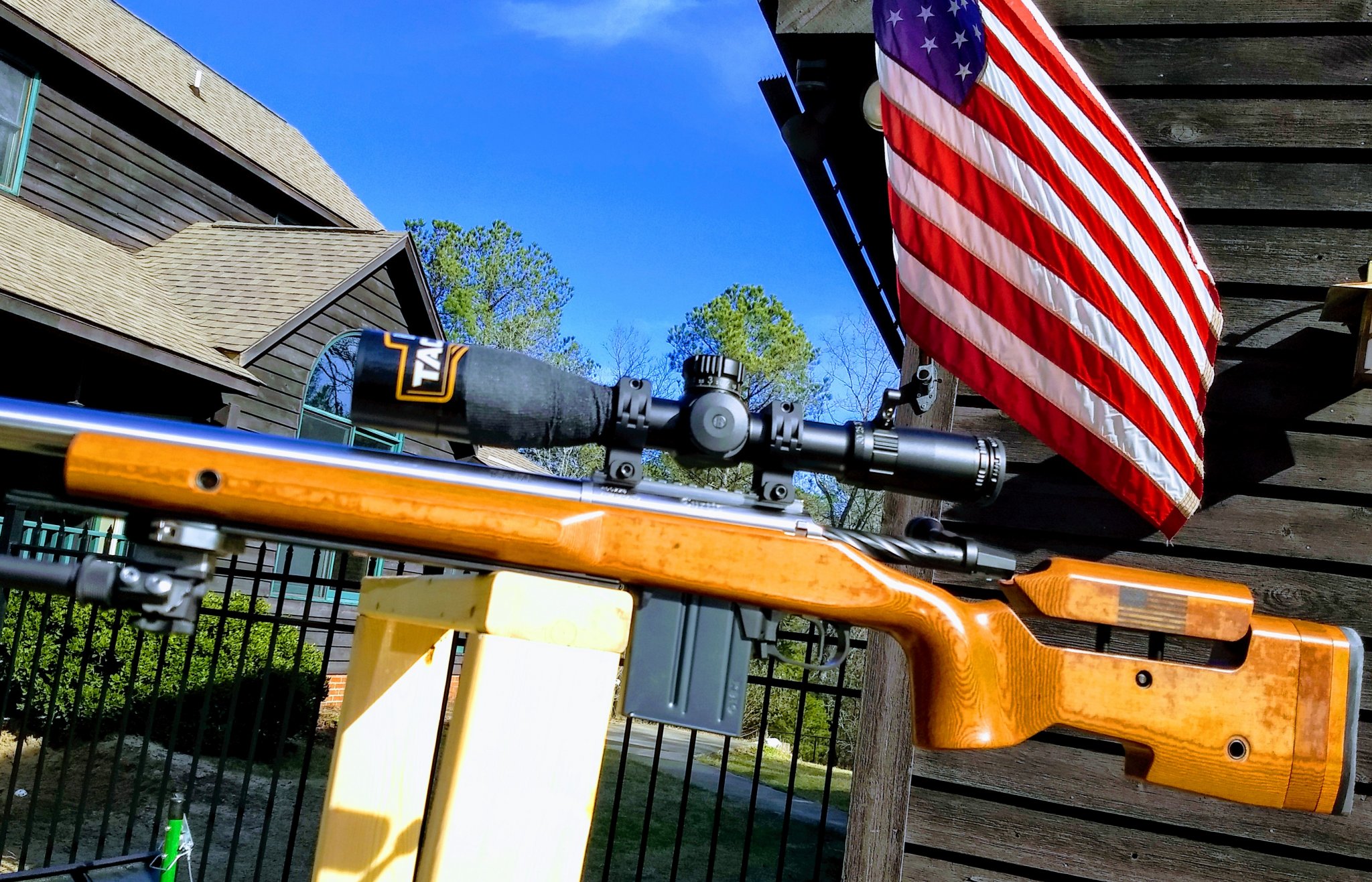

    Just got my rifle together the other day. Plan is to run 130 Norma diamonds with H4350. Making up a velocity ladder today, to shoot tommorow.
    Thought about testing 40.5-41.5, but unfamiliar with this caliber so curious what range you guys might suggest testing.
    Also wondering what velocity you suggest trying to shoot them. I've read old post online saying anywhere from 2800-2950.
    Thanks for any thoughts.
