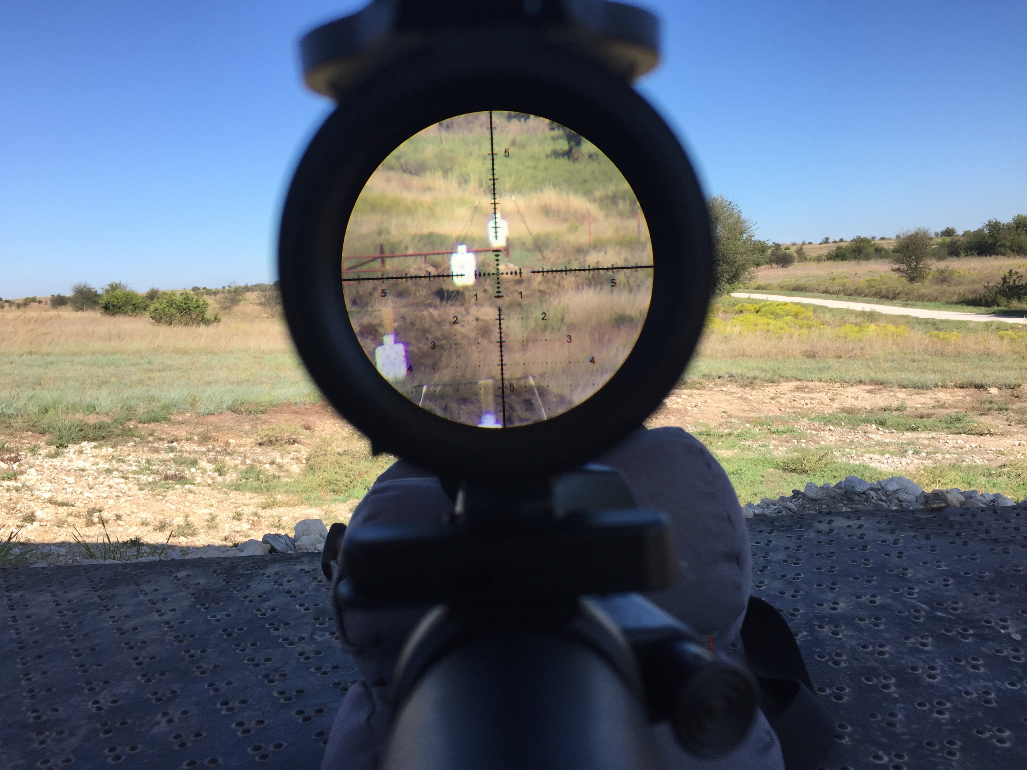

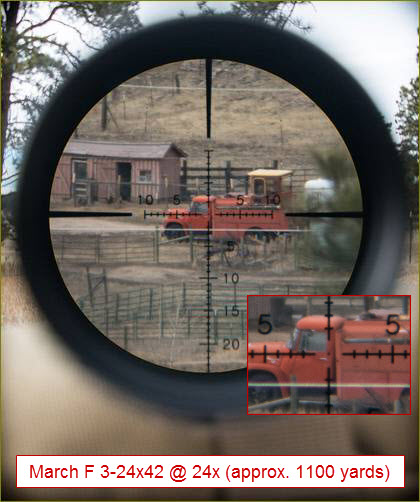

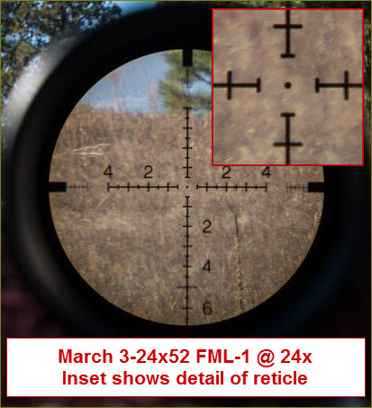

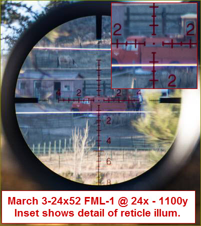

3-24x52
<a href="https://imgur.com/7e2OPyd"><img src="https://i.imgur.com/7e2OPyd.jpg" title="source: imgur.com" /></a>
Note the size relative to the Bushy 3-12x44
<a href="https://imgur.com/wmj4r7H"><img src="https://i.imgur.com/wmj4r7H.png" title="source: imgur.com" /></a>

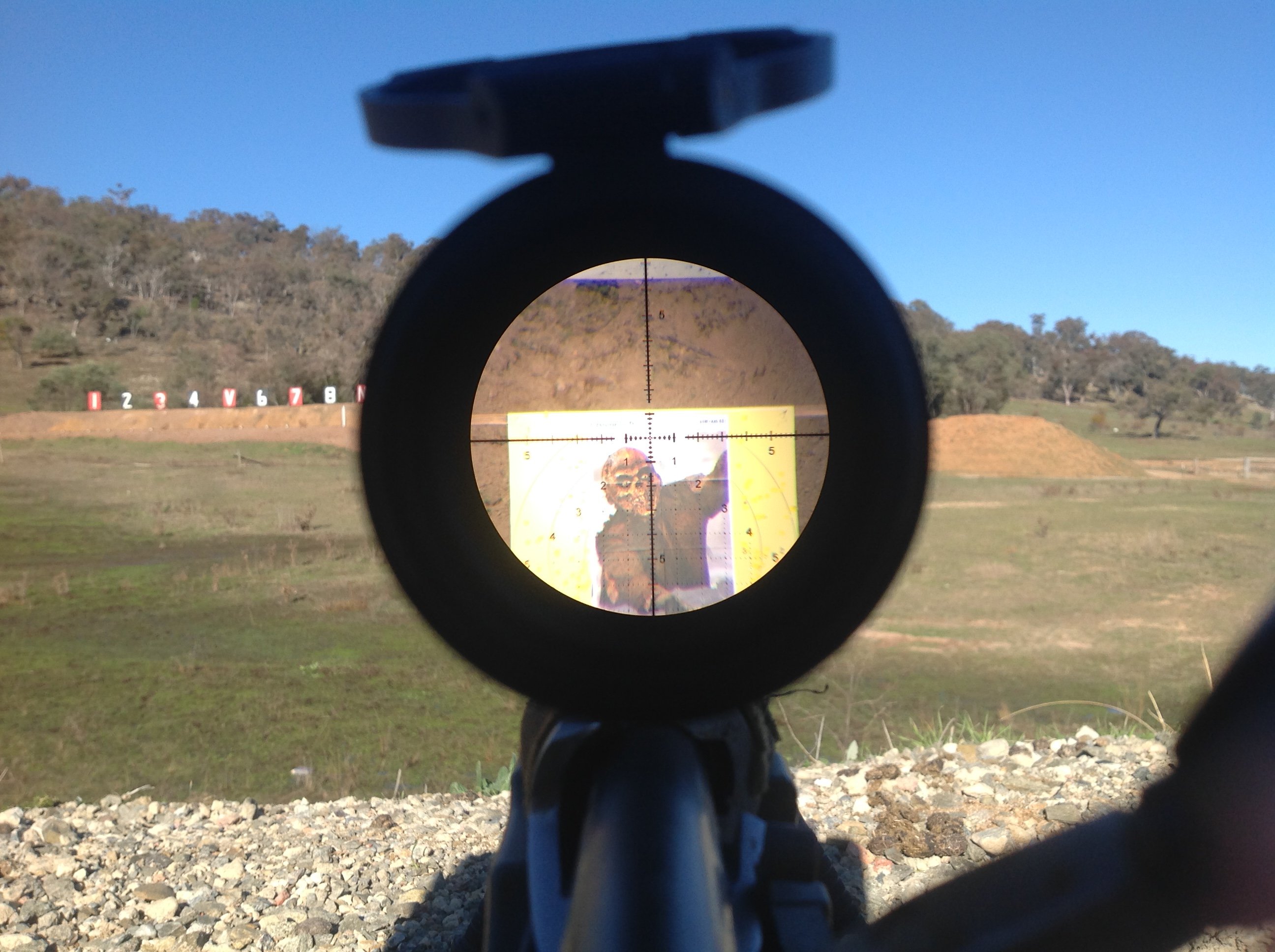

5-40x56
<a href="https://imgur.com/t8AU6HU"><img src="https://i.imgur.com/t8AU6HU.jpg" title="source: imgur.com" /></a>

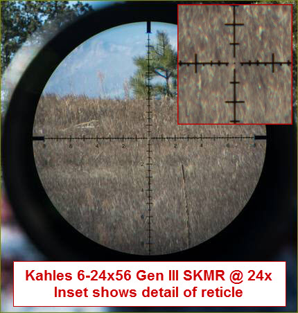

I actually like the FML-1 a lot. I tend to spend a lot of time on lower mags (especially with the gun I have it on) so I appreciate the thickness. My other rifles have scopes with .2 mil hashes but for this one I'm glad its only .5. I tend to shoot a lot of movers with this gun, so having useable holds at 5x or even lower is really nice. The only thing I wish it had was a thin Christmas tree.
For those that spend more time at higher magnifications, I can see how the reticle may be too thick.
The T1 is noticeably thinner the the FML1; the open dot on the T1 is nearly half the size at .06 mil and its crosshairsare .07 vs .25 mil.
I do agree, the FML is a tad thick, but the T1 is a very nice reticle.
Serious, when I saw the specs it looked like everything was the same thickness as the FML-1, now you got me thinking again. Does anyone have any through the scope images of the FML-T1 at 24x and at 3x?
Here was the FML-1 compared to the SKMR, I was hoping to find something in between

My first March was a 3-24x42 with the FMA reticle and it was definitely thinner than the FML-1
View attachment 6869595 View attachment 6869597
