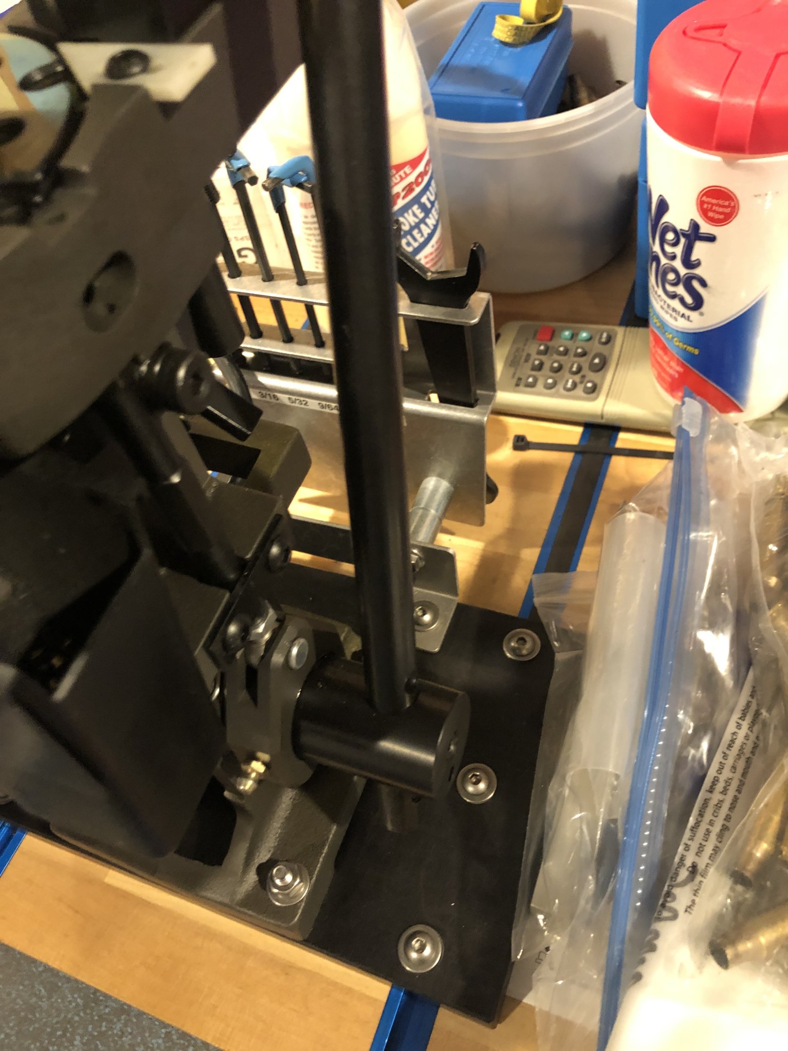

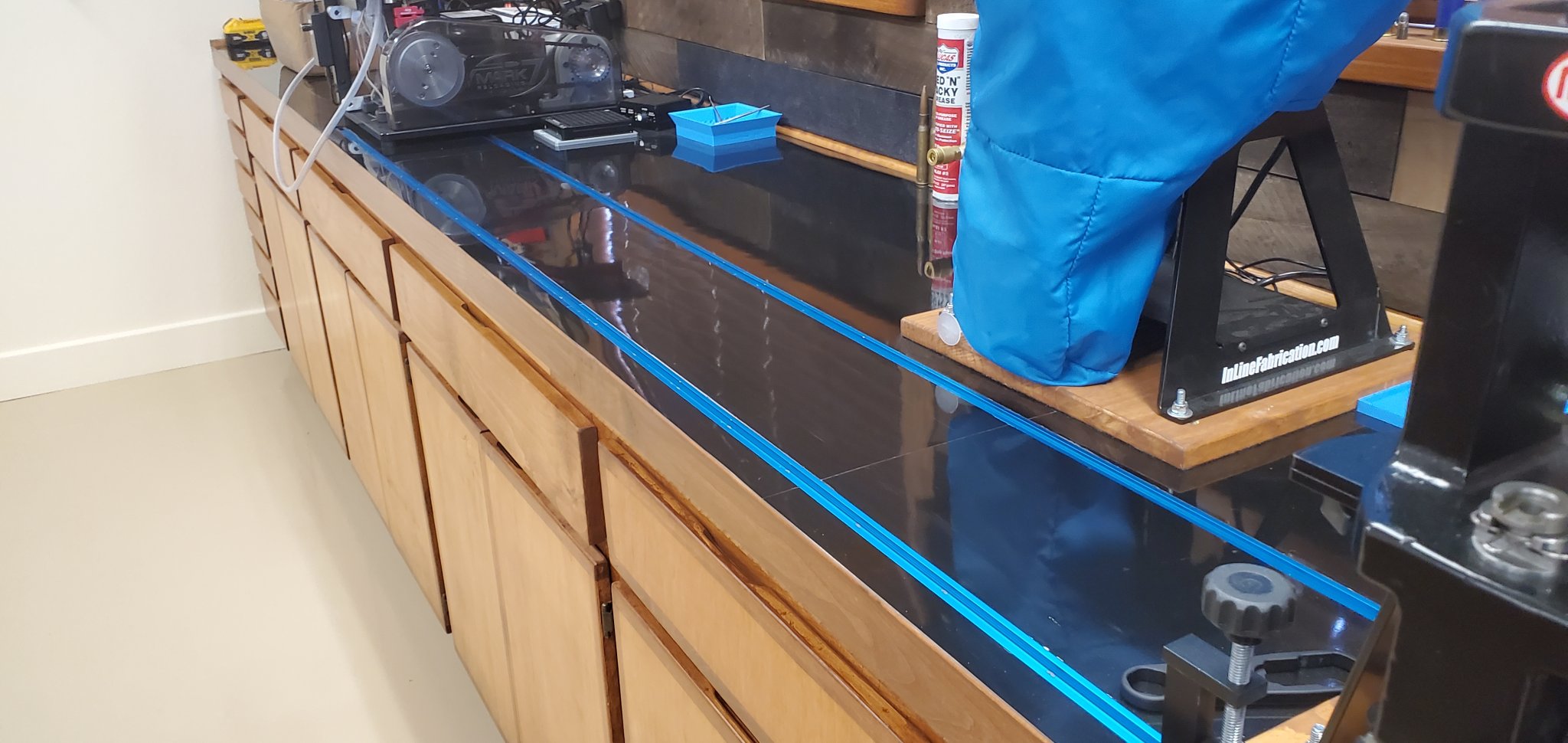

My bench has T-track and I love it. It runs the entire length of my bench and has two rows of track. My Dillon 650 has I believe it’s a strong mount and that is how far apart they are spaced. I use MDF board and bolt other presses to it. I would not go back. Only thing I would do differently would be to purchase something that covers the track so things don’t fall into it. But most of the time if it happens it’s easily retrieved.

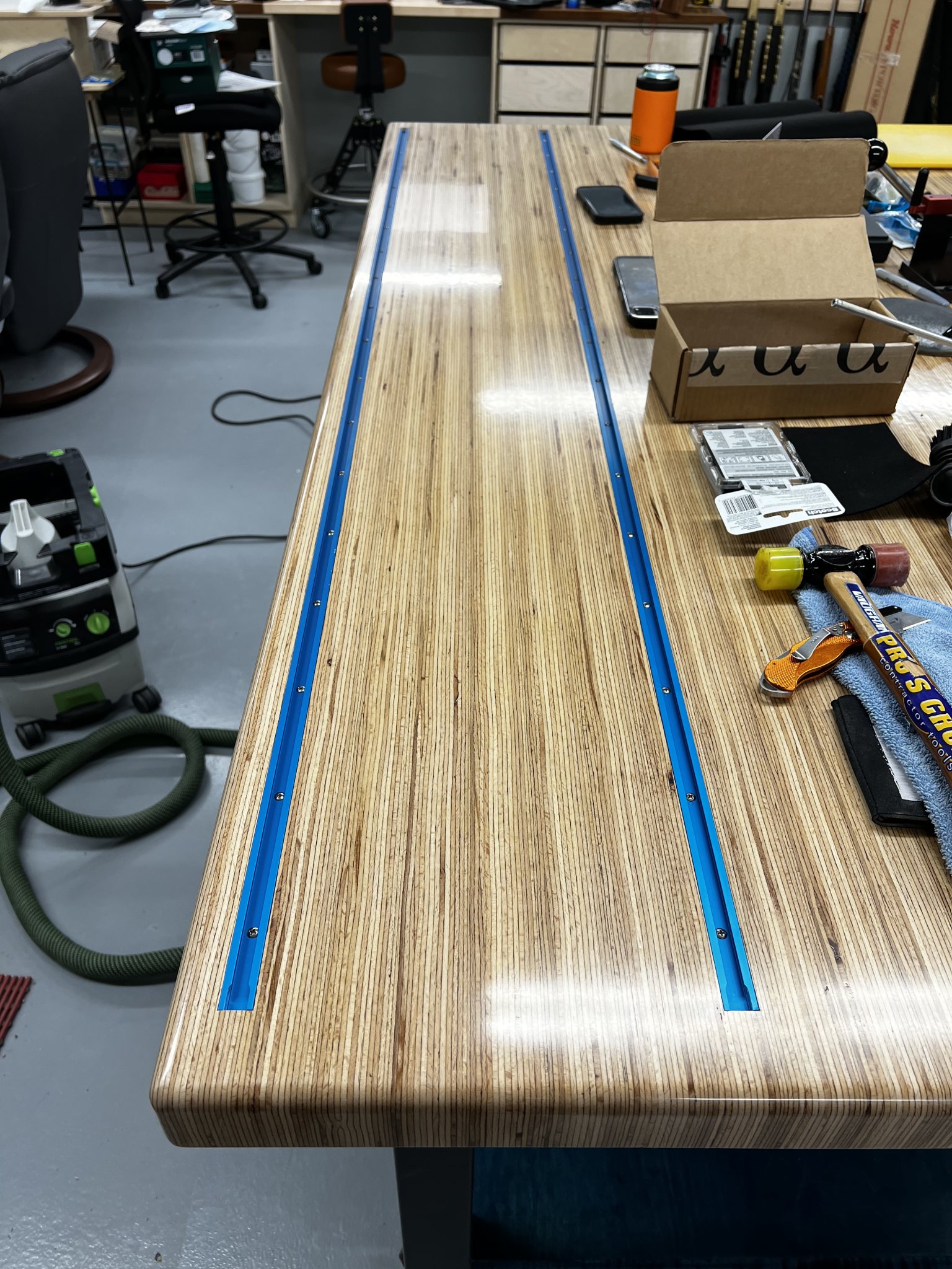

If your using MDF for your workbench surface w/T-track, consider longer screws that can go thru the top and into another underside solid wood board/plywood. Make that underside board wider than the t-track to increase clamping/spreading load of those screws/t-track. Consider using epoxy under the track for extra holding power as well.
I’m building a small 30-36” reloading bench using a solid birch wood top and zero need for underside extra support. Will be routing, glueing & screwing aluminum t- track flush.
Don’t care about being able to pull up the t-track or reusing it. Screwing into solid wood workbench surface will provide clamping power over MDF. Epoxy glue will be extra insurance.

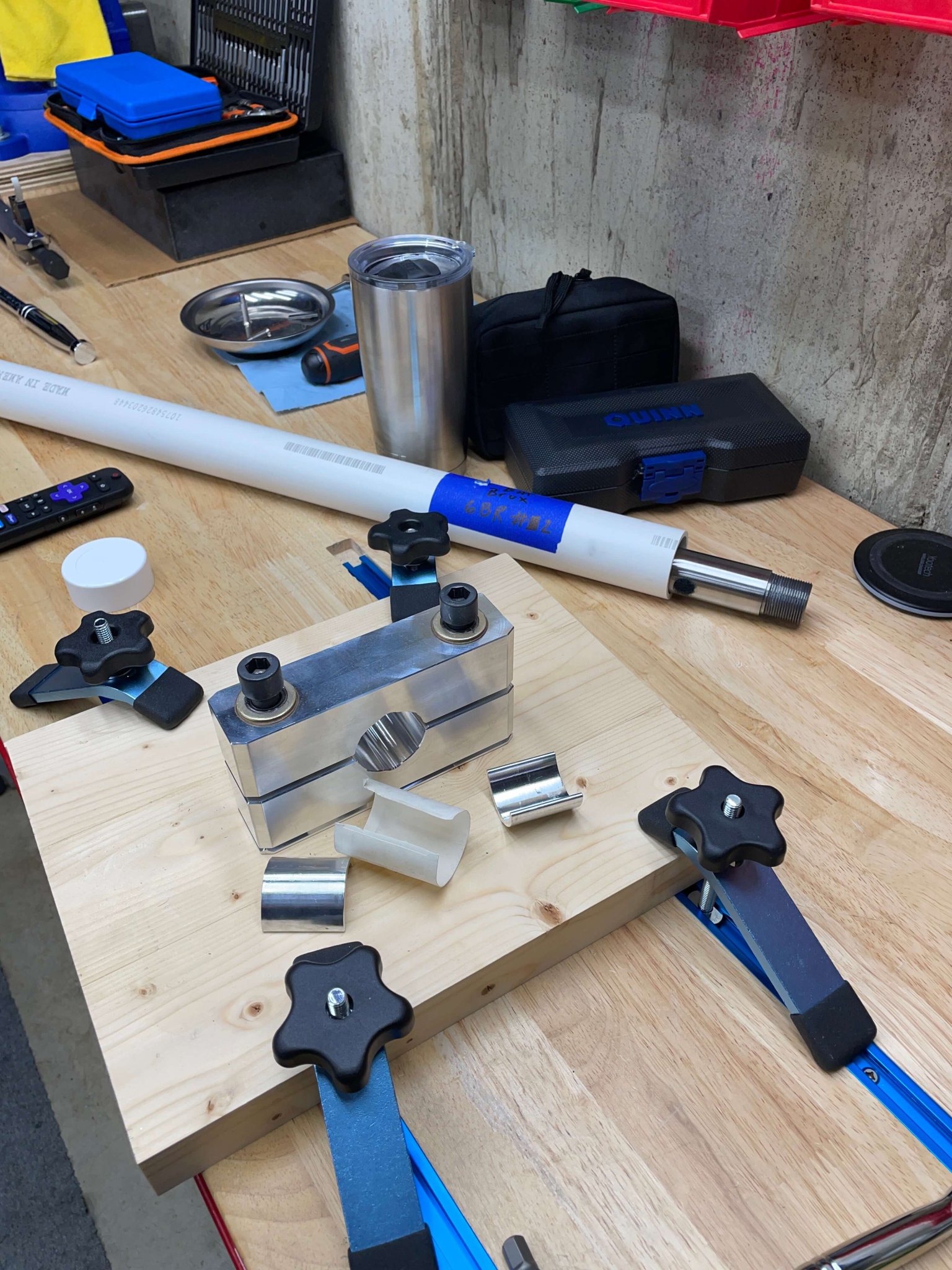

I glued and screwed mine; they're not coming out. T-track allows me to clamp my inline fabrication base/forster coax and an area419 barrel vise as needed and then remove when not in use freeing up space on the bench. Another option is to use a "T-slot router bit" to route a t-slot into your bench top. I'm a big fan of Powertec T-track and their accessories.

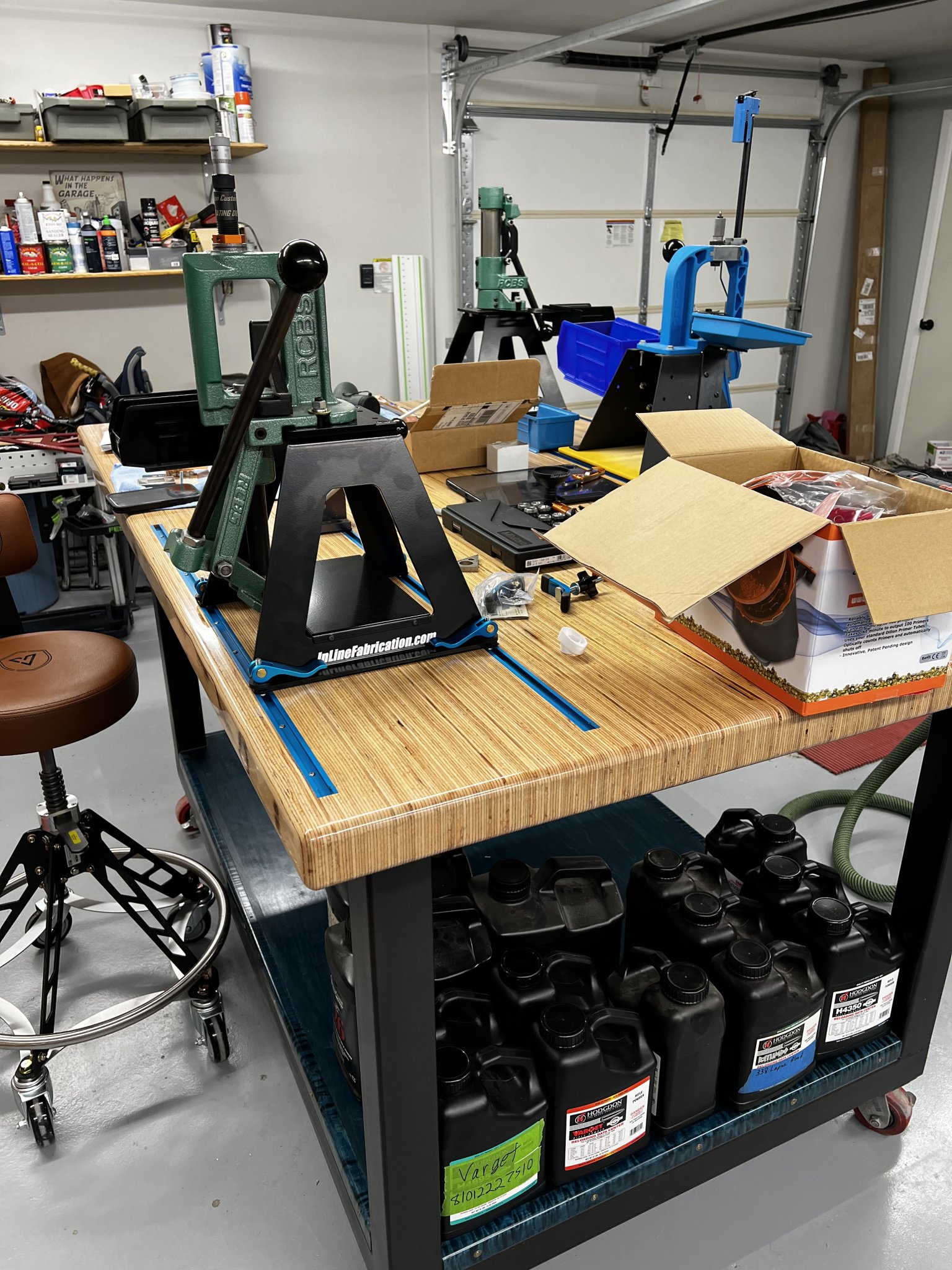

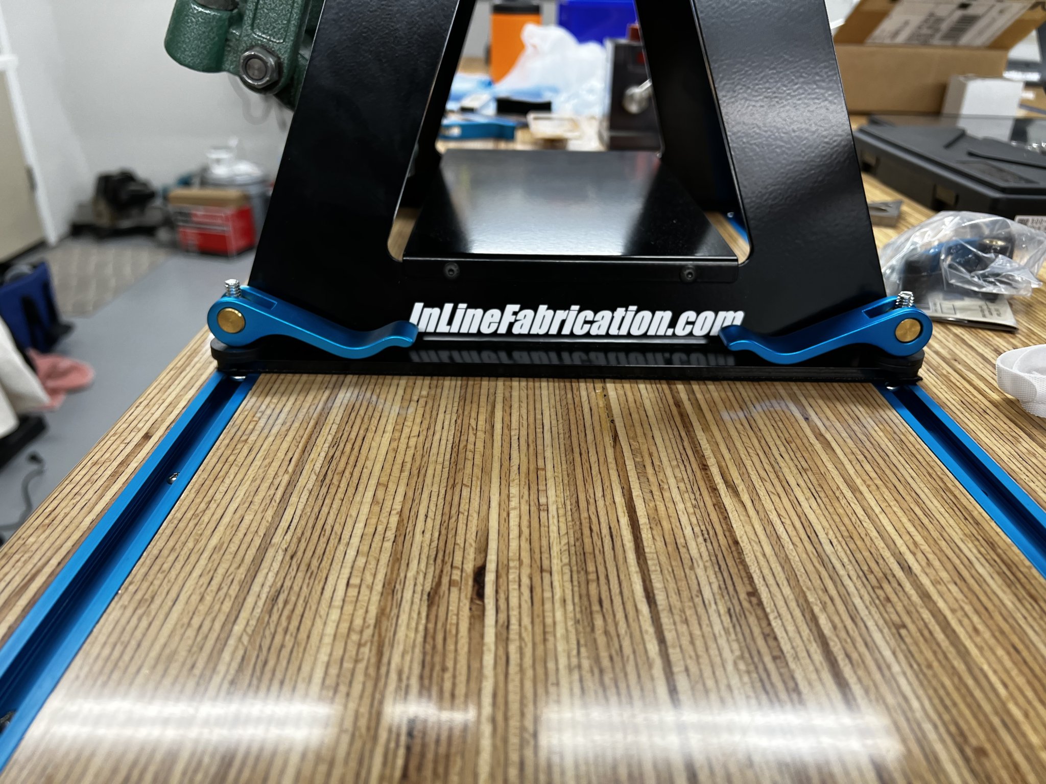

I used the inline fab flush quick change mounts and have them mounted 2' apart. I can remove any equipment and have a flush bench surface. I did not want to fish stuff out of the T tracks when working with small parts.
Reactions: Maurygold
I’ve looked at Rockler and the miscellaneous ones on Amazon. I have an 8 ft piece of Bowling Alley to make into a new top. I used the Inline Fab mounts on my press and have an Inline Fab flush mount as well.
I kinda rethinking the flush mount as it was really only for the vice. I do want to be able to take everything off and have a mostly flat surface.
Would you skip a flush mount and just do all t track?
T-track allows you to secure more than reloading related components compared to inline fabs flush mounts. imo rockler is materially overpriced compared to powertec (https://powertecproducts.com/powertec-t-track/) although I haven't priced stuff lately. powertec is equivalent-to-superior when compared with rockler quality in my experience (i started with rockler, converted to powertec). t-track also gives location flexibility whereas the flush mounts are always going to go in the same spot. my tew sents.

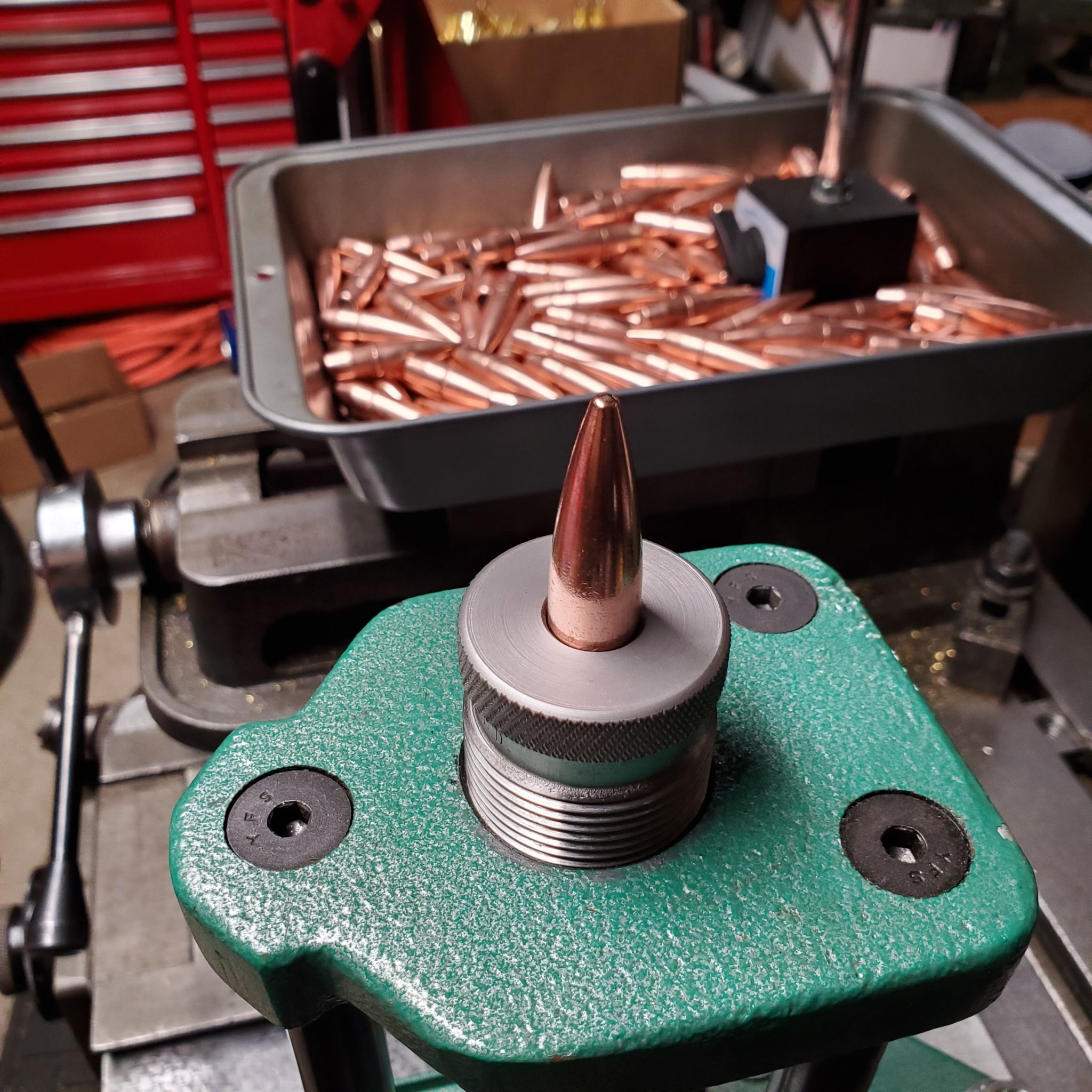

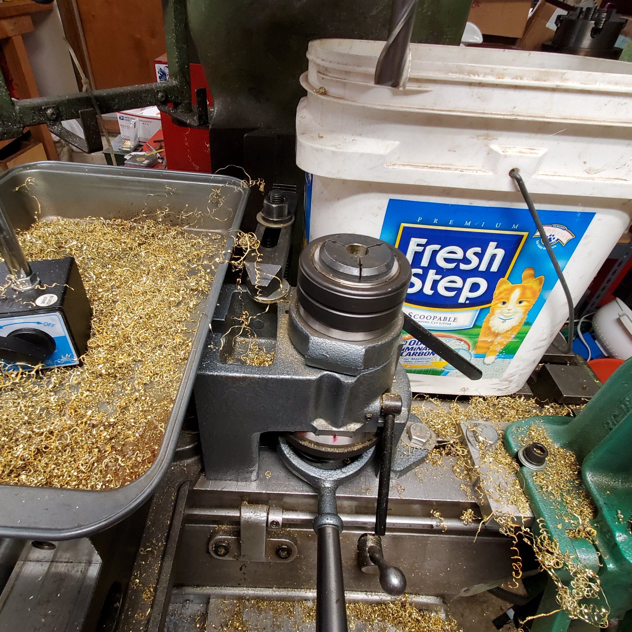

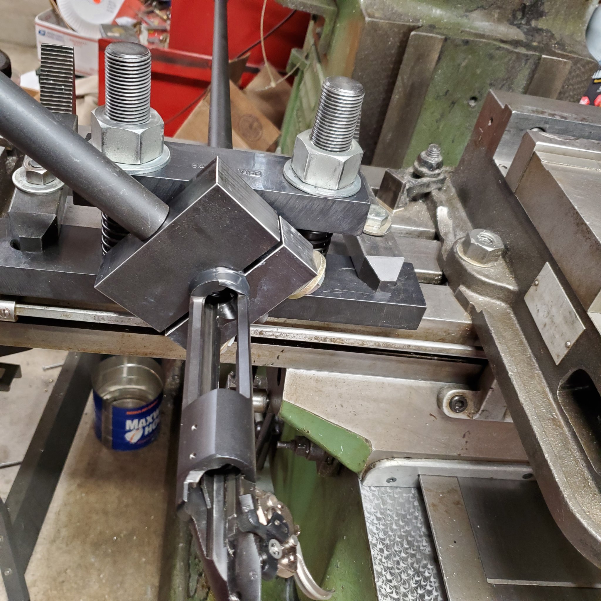

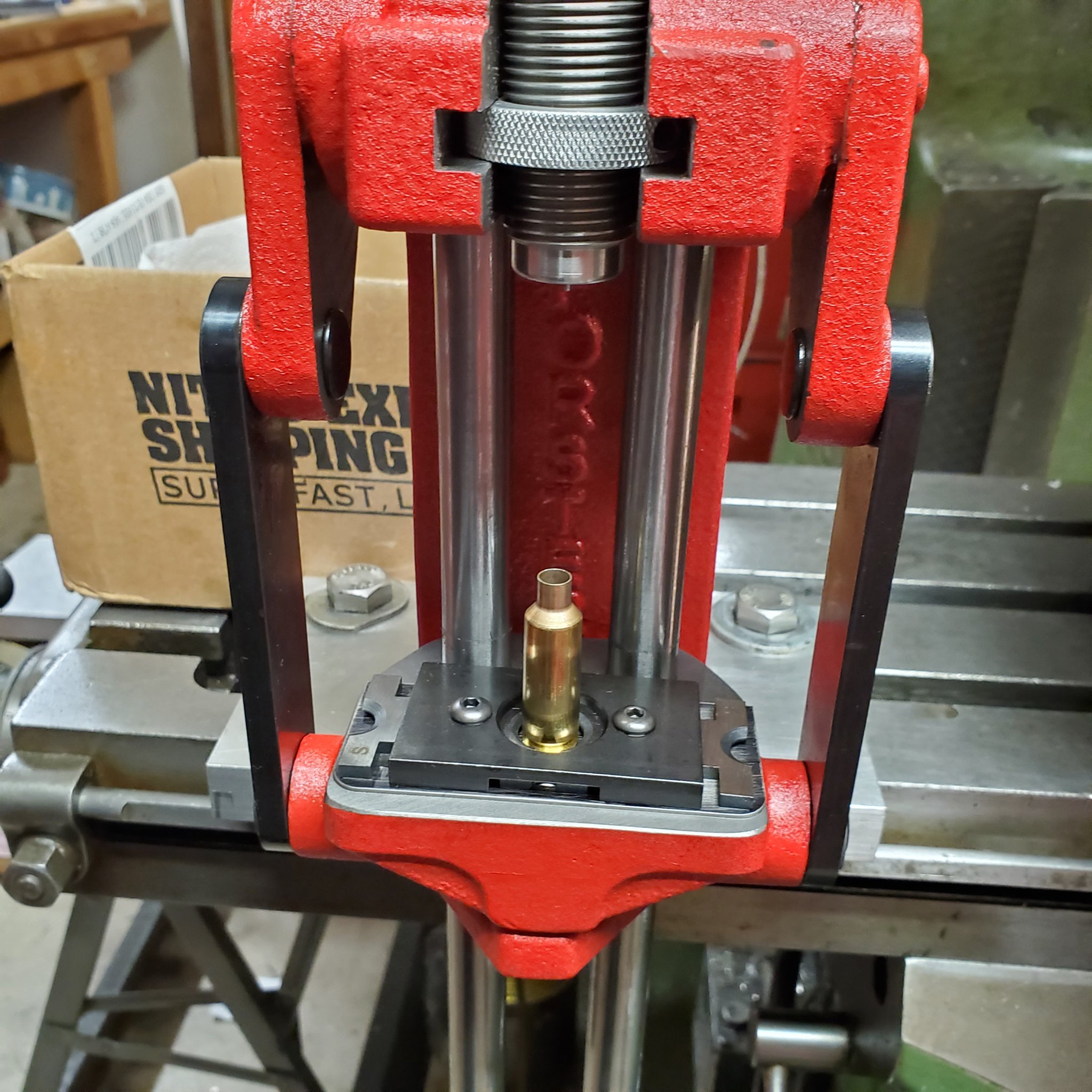

I use a Bridgeport mill table for alot of loading. No worries about heavy case forming or 50BMG case sizing or jacketed bullet sizing.
Heavy bolt down 3/4 & 1 inch thick aluminum plates for each press with 2, 1/2" bolts, mill T slots move anywhere, plus adjustable table height for each press.
Quick, easy, extremely sturdy will break any press before ever flexing.
Barrel removal and barrel extension removal and installation, 4 ft cheater bar no problem....plus it can be used as a milling machine, and super fast case trimmer, when really taking off alot of brass like a 1/2" in a second or two...get ya one.

Dumb question, but is there a "standardised" spacing between the two slots? If so I'm assuming Inline Fab's
mounting holes are based around this?
Or...you can decide what works best for you and mount your stuff on "plates" that coincide with YOUR universal decision. Inline Fab reloader mount? Check. Radial arm drill press? Check. LCD porn projector? CHECK OFF!!
Reactions: eric90503
I spaced my rails based on the inline fab hole spacing which I don't know that I'd do again as I mount everything (reloading press, barrel vise, mechanics vise, etc) on plates secured by hold down clamps in the tracks.
