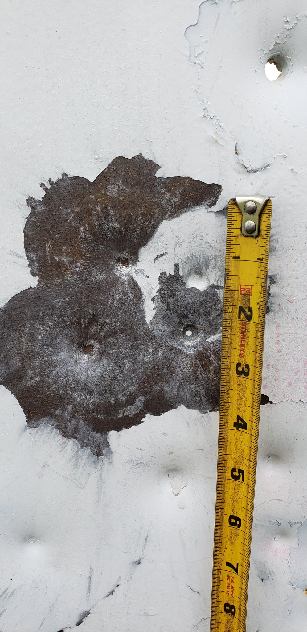

Bc was spot on in my 22 creed at 942yds. Shot well too.
Reactions: Edgecrusher
