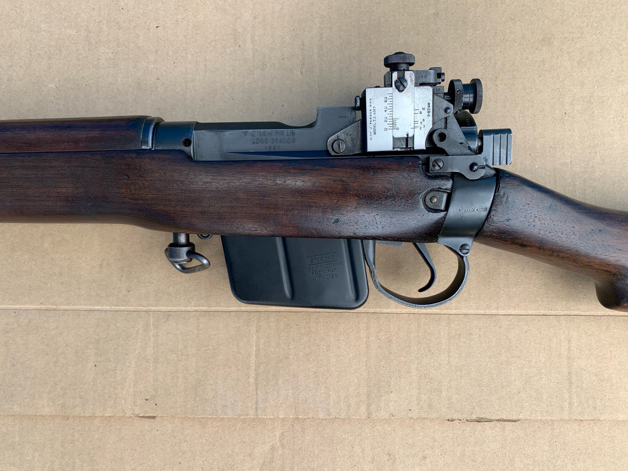

I often shoot a pair of nice old Enfields using cast bullets out to 500ish yards. One is a 4570 and the other is 303. Both are fitted with the old early 1900s parker hale sights, model 5a i think it is. Click adjustable windage and elevation, adjustable aperture etc. Functions just like a scope really. Very slick, but can be expensive and hard to find. Totally worth it to me though as they are so enjoyable.
The adjustments on nice sights like that are repeatable and i marked for distance, so i can hit very well with them.

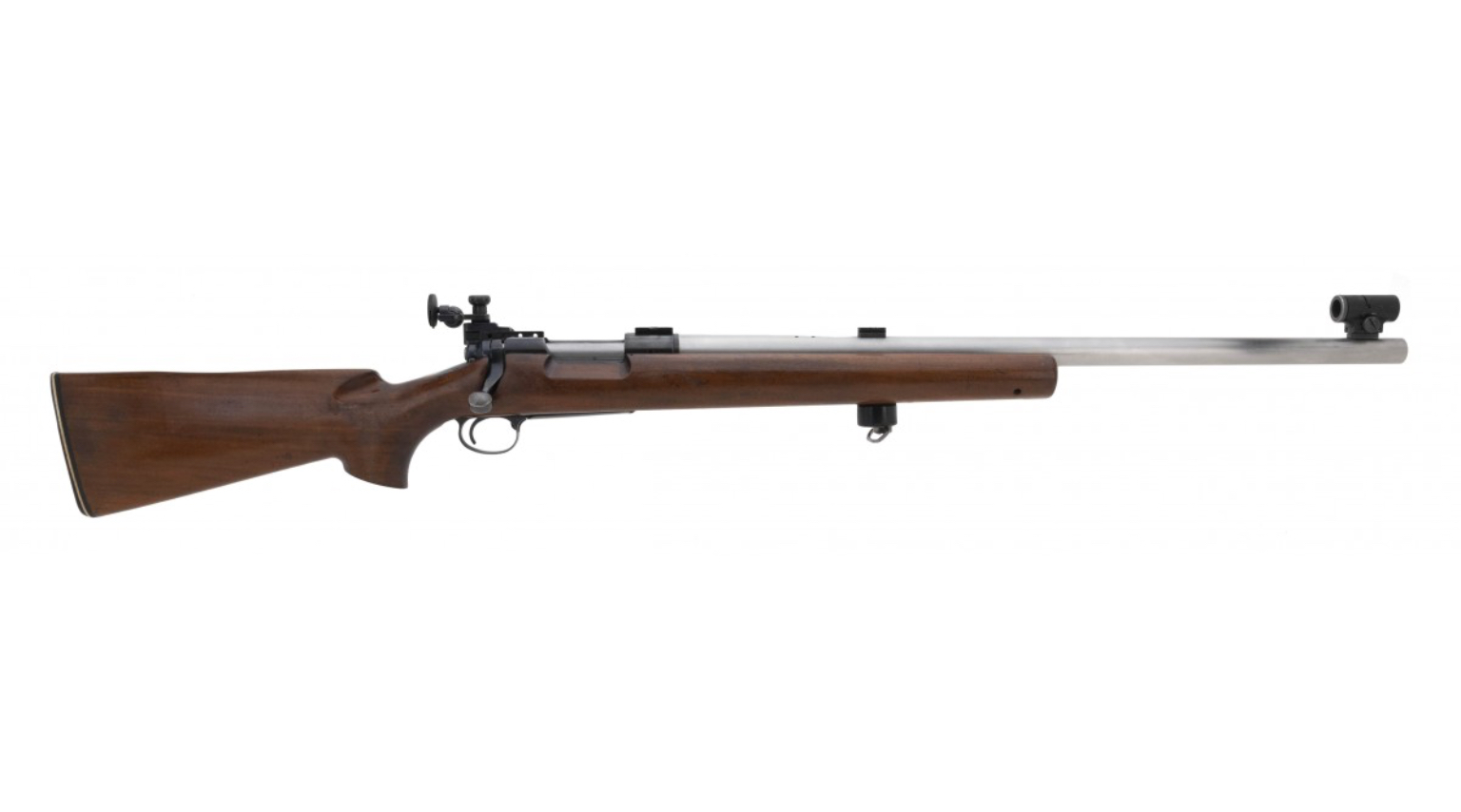

I have an all factory Remington 40XB in 7.62 with redfield arperture sights it’s sweet. @168BTHPM knows a bit about this style of shooting. I think he’s waiting for me to die so he can get mine.
With a scope and some thrown together(light load) hand loads my first 3 shots at 100 We’re real lucky and looked like 2 shots that were almost perfectly stacked. If you search you can pick them up cheap(ish) lots of gun shops in my experience don’t know what they are, and look t you like a moron when you mention one. You can get a real nice one around $1500, but I’ve seen them for Several hundred less and it’ll do competition and hunting great. Even the triggers feel nice stock.

My set up was/is a Remington 40-XC in 7.62 NATO out of the box with a Redfield International rear sight and a Mid Tompkins front globe sight with spirit level.
A back up to that rifle is what started out as a Remington 700 barreled action with a .308 varmint barrel on it. It went to a gunsmith who basically mimicked the 40-XC in stock, barrel configuration and overall weight. It too has a Redfield International rear sight and Mid Tompkins front globe sight with spirit level. That rifle is used as my 'back up rifle' whenever the 40-XC is being re-barreled or has other work being done on it.

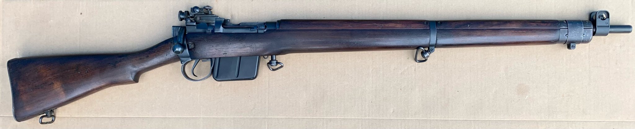

In regards to you being in Canada, AW24,(our Big Brother to the North) and me being in the States I am not familiar with Canadian laws, regulations and ordinances so would be hard pressed to suggest how to go about acquiring firearms and/or sights. That being said if you can find a SMLE like what S12A posted that would be sweet. It served the ANZACs well.
