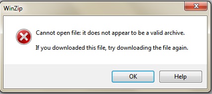

Hi,
That URL (certainly for the non-Bluetooth) is wrong (extra bracket on end). But even when it's right, the ZIP archive seems corrupt.
Later: now I see the URL is right, it was wrong in the email extract, but the archive still seems corrupted.

I figured I would update the software on my kestrel 4500 with applied ballistics. Can you guys possibly make this anymore difficult? What a pain in the ass. I am not a computer guy that goes without saying. I am running windows 8.1 and I go to choose the com port and all I get is a white box with no options. I couldn't be happier with the kestrel and the applied ballistic software is great I don't have a bad thing to say about either they are SPOT ON!!!!!! You just need to make this a little easier to pull off and I am sure a computer guy thinks its simple. But not me. And I am sure I am not the only one.
Ok after printing the How to upgrade your kestrel software using the NK bootloader program and reading them (more pictures than words) Success!!!!!!!! Without those directions forget it I wouldn't of made it thru it. I am glad the kestrel unit is easier to use than it is to update. And if I made it thru this I would say its a good test for your directions.
So the update software is done. So now the device will connect for about 5 sec before disconnecting. I updated the software using Bluetooth connection. It will find the device connect and then drop the connection. Its not the computer there were no setting changed. I even removed the Bluetooth mouse and speaker that were paired to the computer. I just want to get my rifles back on the unit. For the money that I paid for this unit it sure as hell shouldn't be so buggy. So how do I connect the device now? It shouldn't take instructions to connect a Bluetooth device. Find device pair device add password. And it pairs. And it should stay paired. As you guys can tell I am pissed!!!!!! The update was painful enough now this. When the unit is powered up it says ISS 4.8 so it is the latest version.
" all of your user guns will remain on the device." No they won't. Glad I backed up my info with pad and pen.
Talked to a guy at kestrel this morning he looked into the issue and called me back this afternoon with a RA#. Said they would get it taken care of. I cant ask for more than that.
But I will still say that this product would be even more successful the easier it is to connect to a computer. The unit is easy to use now make it as easy to connect to a computer and update software or manage rifles.

Ok it is way better now. Thanks to Joe at kestrel. I can connect via Bluetooth now. The profile loader still doesn't work with Bluetooth it has a fault. Now you need the profile loader build #29 not #24. If you click the help button on the profile loader it will tell you the version. But the great news is I was able to load guns with the usb cradle.
I'm running a mac - windows 7, parallels. I'm able to connect with bluetooth on com 4, selecting com 5 though for the connection in the software.
When I run the newest version of AB Profile Loader, clicking connect on Com 5, and getting "Device Connected" that seems to run fine.
The issue is when I attempt to "Get Profiles from Kestrel" I get the error "Could not determine state of device...Check connection"
