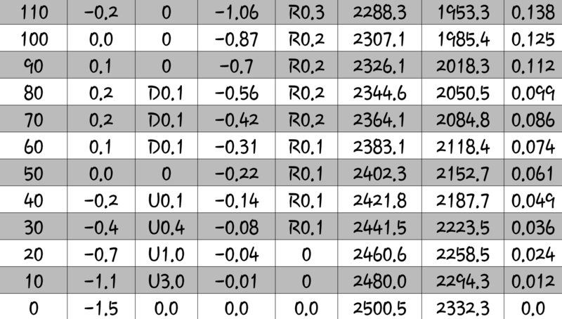

So I'm running the Applied Ballistic app on a Samsung Note 4. So I have a Labradar for muzzle velocity. I have created my platform then selected bullet from library. Which Fedeal Match HPBT 168gr. So I enter in a 10 group average 2566.5 and a 6ftps dev. Then in went to trajectory and at zero it starts out wit 2500.5 for the velocity???????
Screen shot
G1 or G7 doesn't matter as long u pick one. G7 is better (IMHO). Is the velocity different because the current atmospherics are different than your zero atmospheric?
I must have something fat fingered because I have reloaded the same bullet and pretty sure the only thing I changed was G1 to G7 and where the bullet go sub sonic went for like 840 to well past 1500 yds.?????
So I solved 1 problem but can't quite figure that out either. 66fps went to the power temp being enabled. After turning it off the trajectory read right. But as I went out of that bullet and back in. It was on again. And why it keeps picking 59 degs?????

So I would start over. After building your rifle and during ammo selection make your ammo temp the same as zero temp using G7. See what that does.
when I did this then made my current atmosphere same as my zero it lined up exactly.
You said you entered 6 FPS Deviation? MV Variation is FPS per Degree. I am assuming you input it into the MV Variation slot and that's why your MV shifted so much. Check out the user guide: www.appliedballisticsllc.com/abmobile on how to use the inputs. Start from scratch, and go slow.

Nope Doc just Checked and on TD's advice I deleted both the G1 and The G7. All I entered was was the muzzle velocity. I'm going to use the G7 and take it out and see how close it comes. And go from there.
