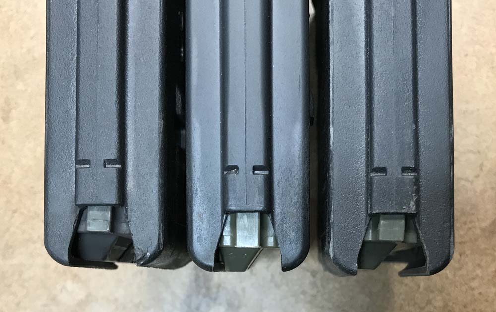

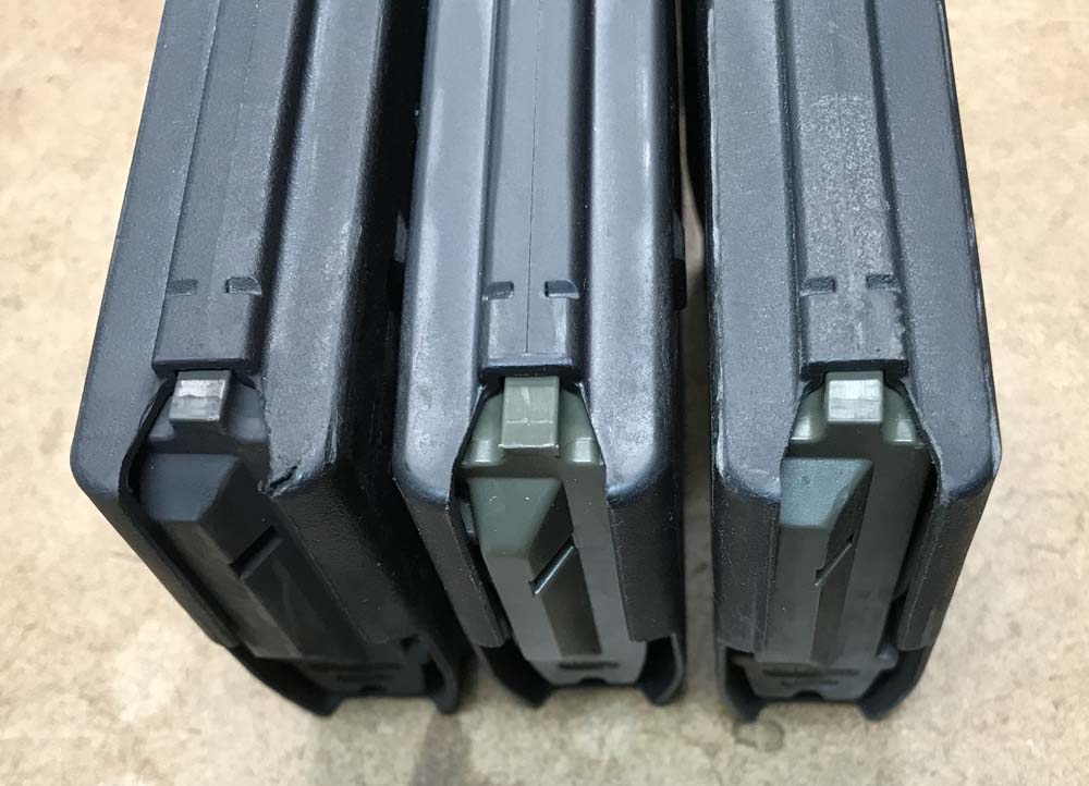

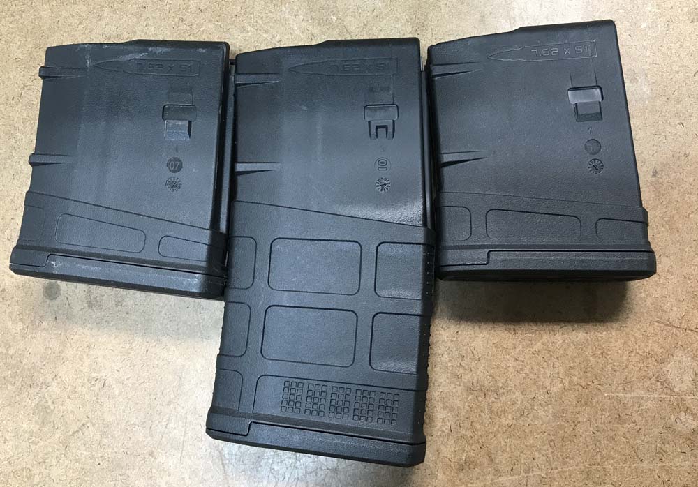

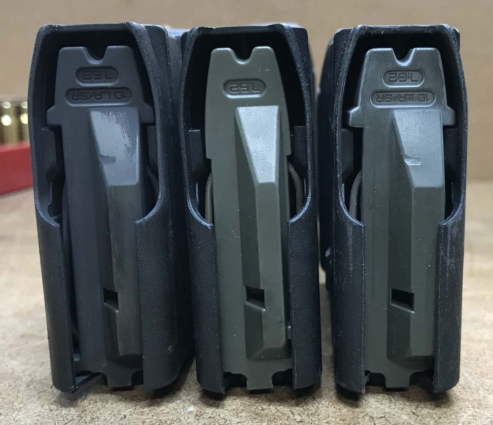

When I got back to my shop I started checking my P-Mags. The one I've been using looks like it has a small bite out of one of the flanges on left side. Not the only difference. Gun shipped with a twenty round P-Mag but as mentioned too tall. When I compared the ten round with the twenty round was shocked to find out not the same. Both are Gen3 but the followers are quite different. I'm attaching some photos to show the comparison.
The mag in the center of each photo is the twenty, two tens on each end, one is used, the others are new. Lets play a game and see how many difference we can find.

I had trouble with the pmags in an ar10 build very similar to yours. Swapped to steel duramags and issue was fixed.
I run pmags in ar15s all day no issue but something with how large the lip is around the top causes fail to feed issues. At least in my experience. Buy some steel mags and call it a day.
There have been many changes with the 7.62 NATO PMAGs over the years. A lot of this was to accommodate the variations in rifle manufacturers with their bore datum relative to the mag catch location on the lower receiver, the different bolt catches, and just how different large frame guns perform.
Nobody but a few are on the same sheet of music, and there is no TDP with supporting armorer’s gauges to check BCGs, receivers, extensions, bolts, extractors, firing pins, upper receiver dims, gas tube locations, carrier rail lengths, etc.
The 1st Gen 7.62 PMAGs worked well in some guns, but didn’t in others, so Magpul made changes. The DPMS GII was notorious for not working with the Gen 1 mags because the bolt was smaller, with smaller bottom lug engagement. People modified followers to locate the last round cartridge in presentation in a more ideal orientation.
What really needs to happen is that a rifle manufacturer build the rifle around a specific magazine dimension set, and make that known.
One magazine that usually solves large frame feeding problems is Lancer.
I have zero expectations of any type of reliable performance from any of the race-to-the-bottom assemblers though. Let them address the problem.
