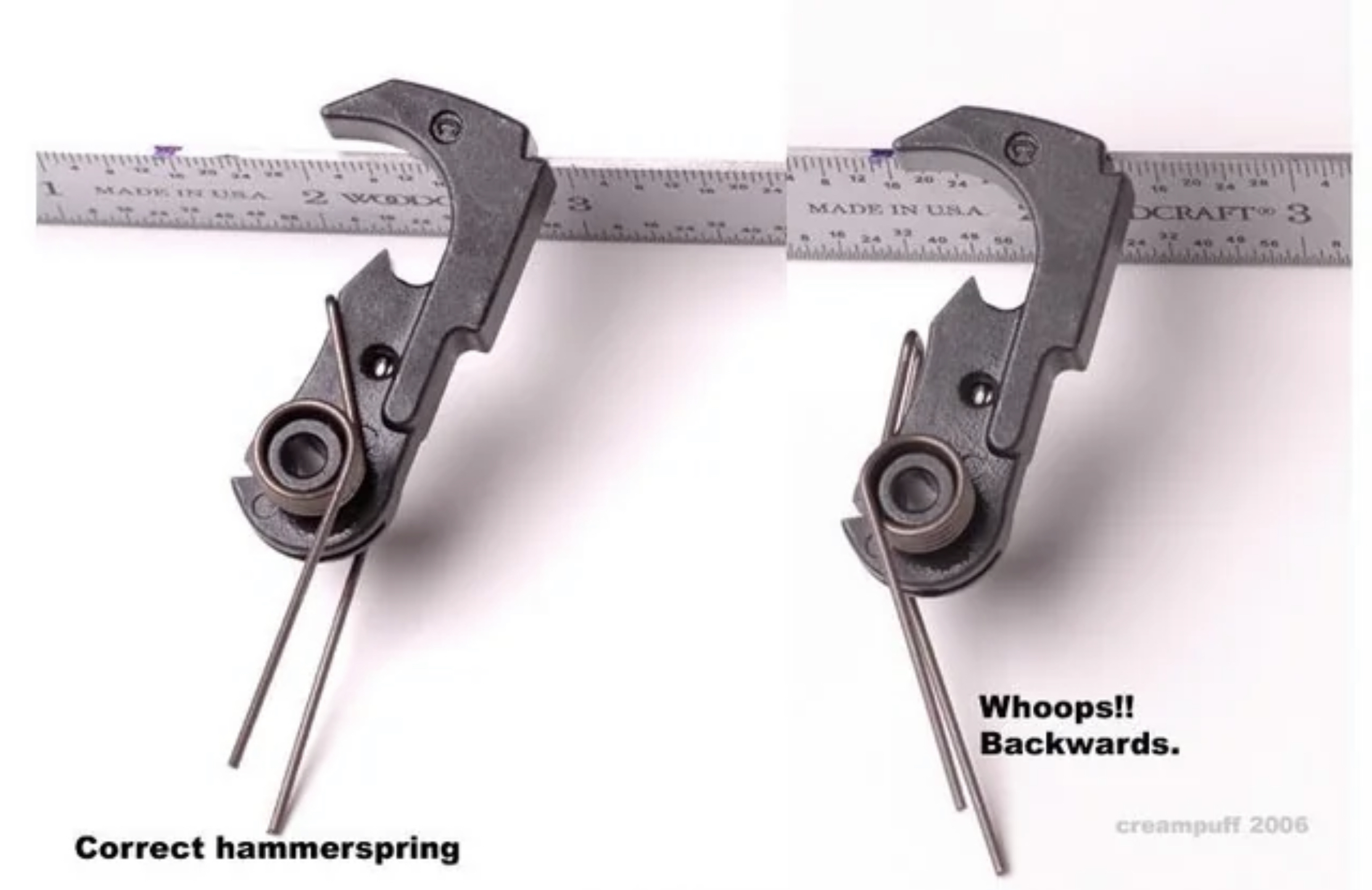

Is this a possibility?
Sure its all the way in battery?
Does the click when it doesnt fire seem different than the good click when it would fire?
Couple weeks ago a friends ar would randomly click, leave a tiny mark on the primer, but not fire. Swapped several things around, then found the hammer was falling to almost like a half cocked. It was a drop in trigger that was faulty.
I dont know if the SSA-E would do that or not.
