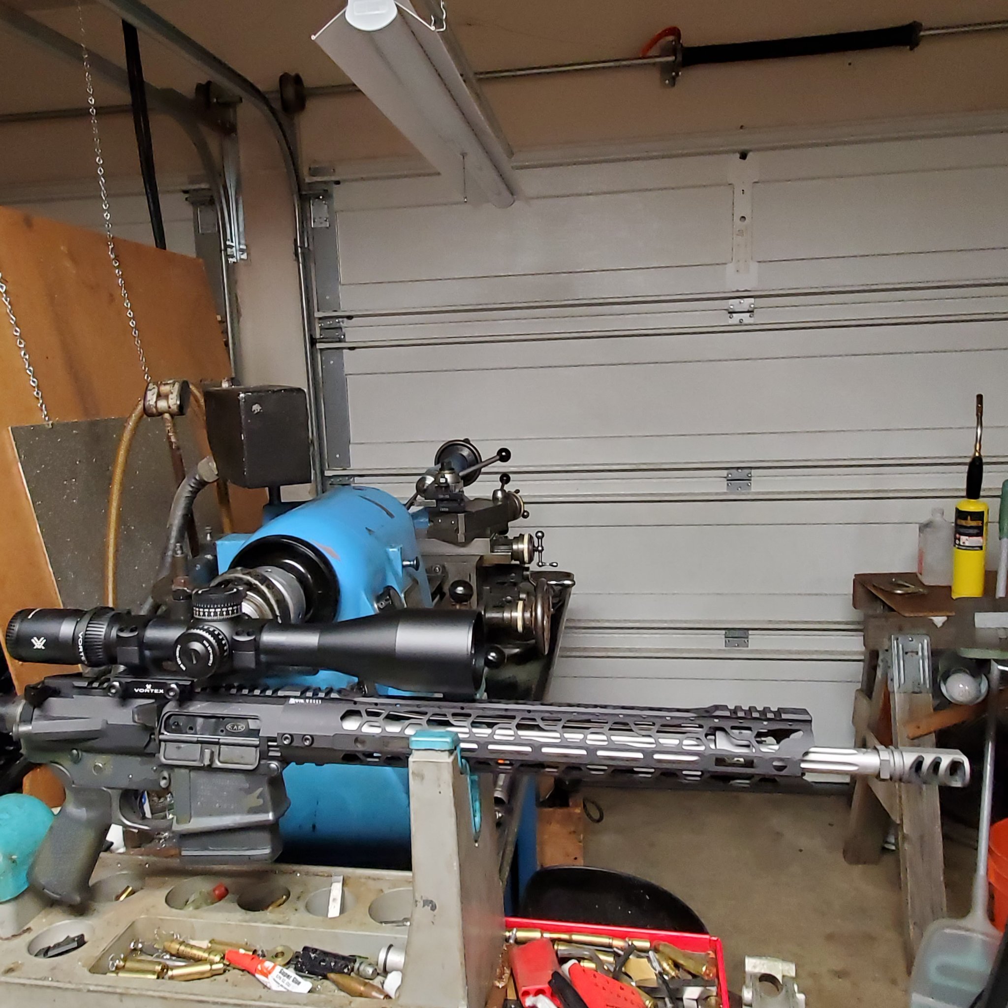

So someone mentioned the 338 RCM, would be an interesting build for an AR 10.
So why not I have the tools, except a 338 RCM reamer, which arrived before the barrel.
Chambered a lighter barrel, adjustable gas block, magnum .535 bolt carrier, and upper reciever.
Put it all together and the 338 RCM weighs in at 7 lbs 11 oz without scope.
Took it out today to see how it would preform. First round was a moderate load with 200 gr bullet.
All the rest were loading book maximum loads, including sight in loads, with various hunting bullets bullets 160 gr copper Barns to 250 gr Speer GS.
To see how the AR 10 handles the 65,000 psi magnum pressures.
It did well, function well and was accurate, especially for hunting bullets. 5 3 shot groups averaged .506" the 5 shot groups were right at 1".
Brass was made from 6.5 PRC, 4 different manufacturers or names on the brass.
I did notice the weight difference.
The Barns already had loose primer pockets, the Lapua was 50 fps faster, Nosler required an extra annealing as it was brittle. But Norma, Lapua, and Barns all used the same forming steps...the brass does make a difference, on targets, big game is a big target, so not so much.
Most loads were getting around 3200 ft lbs of muzzle energy from the 18" barreled AR 10 with only two powders tried.
A 200gr at 2700 fps seems like a good balance, or 225 for 230 for heavier big game. The 250s at 2400 fps would be for close range smack down.
The 338 RCM is a good hunting round in the AR 10 platform, for those interested.
At least its unique.

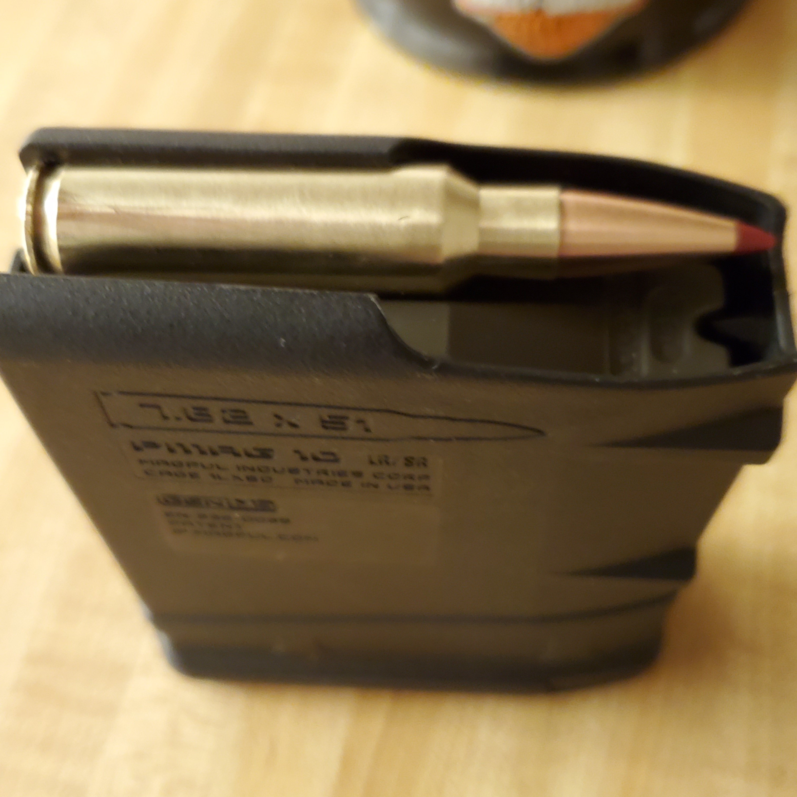

What are you using for magazines? Are you having any feeding issues? I'm looking to build a RCM AR and started wondering about the .532" case alignment and feeding from my standard Magpul magazines, but I can't find any special magazines for Magnum diameter cases. I'm hoping it's not an issue.
The Magpul will feed about 3 without modification..if memory serves correctly.

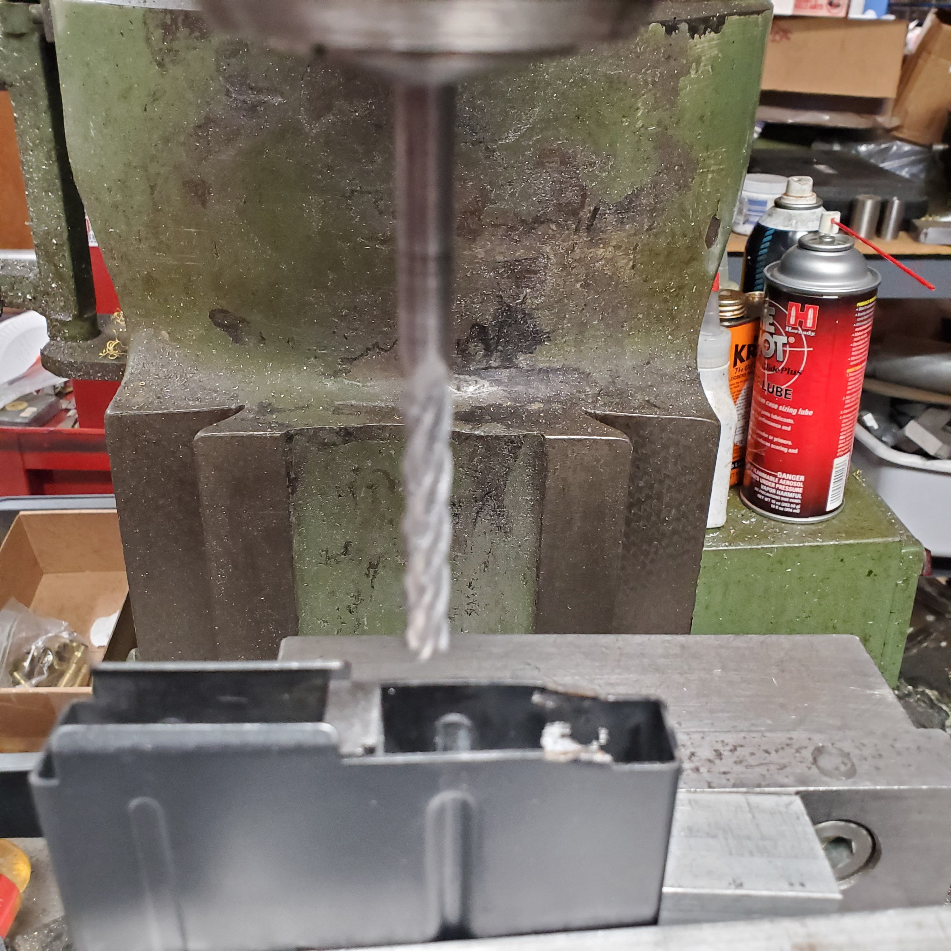

They must be modifed in the bullet and cartridge guide area, and add a cutout dip in the front of the mag.
The pic of the area of a metal mag being modified to accept larger dia cartridges.
Relieving the areas where they bind up.
This can be done with file or hand grinder for many, who do not have a milling machine.
