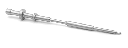

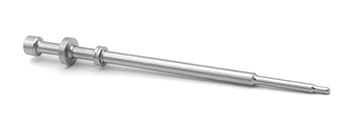

Interesting, when you say you changed to the JP BCG, which one ? , the HP version with the JP proprietary firing pin ?
Like this...
https://jprifles.com/buy.php?item=JPFP-308HP
Or the more commonly style used firing pin like this...
Like this...
The Fulton Armory with the JP bolt and small diameter pin. I couldn't find the complete JP BCG and I needed the bolt to have it headspaced to the barrel. I have since bought one of the complete JP BCGs for the next build.
FA/JP HP BCG
New build BCG
JP Rifles HP 308 BCG

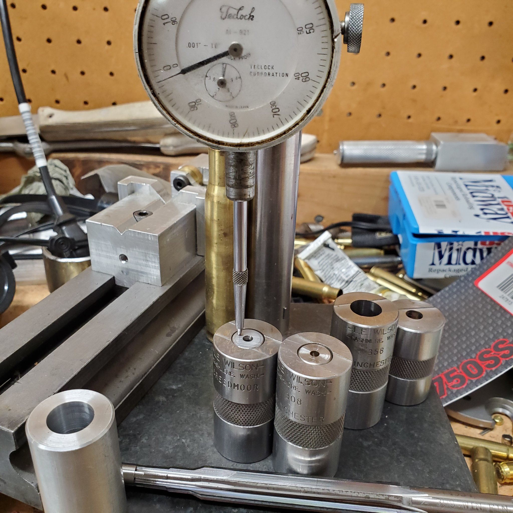

CNC manufacturing has made AR parts and even some bolt guns with barrel interchangeability possible.
Quality parts, inspection, and good personal help all of that to happen.
But every so often a few crap parts get through.
One should have gauges to check the accuracy of what others have made in your build.
Being into precision, I check everything. And that helps get small groups.
In this picture I use a chamber "go gauge" to check the accuracy of the Wilson case gauge, which is .002" off.
The aluminum gauge is made with the Wildcat chamber reamer, and brass case sized to fit. Then used to chamber the rifle.
So I like precision, and knowing where to size the brass case precisely for multiple rifles of the same caliber, and of course less case stretch and reworking the brass, after each firing.

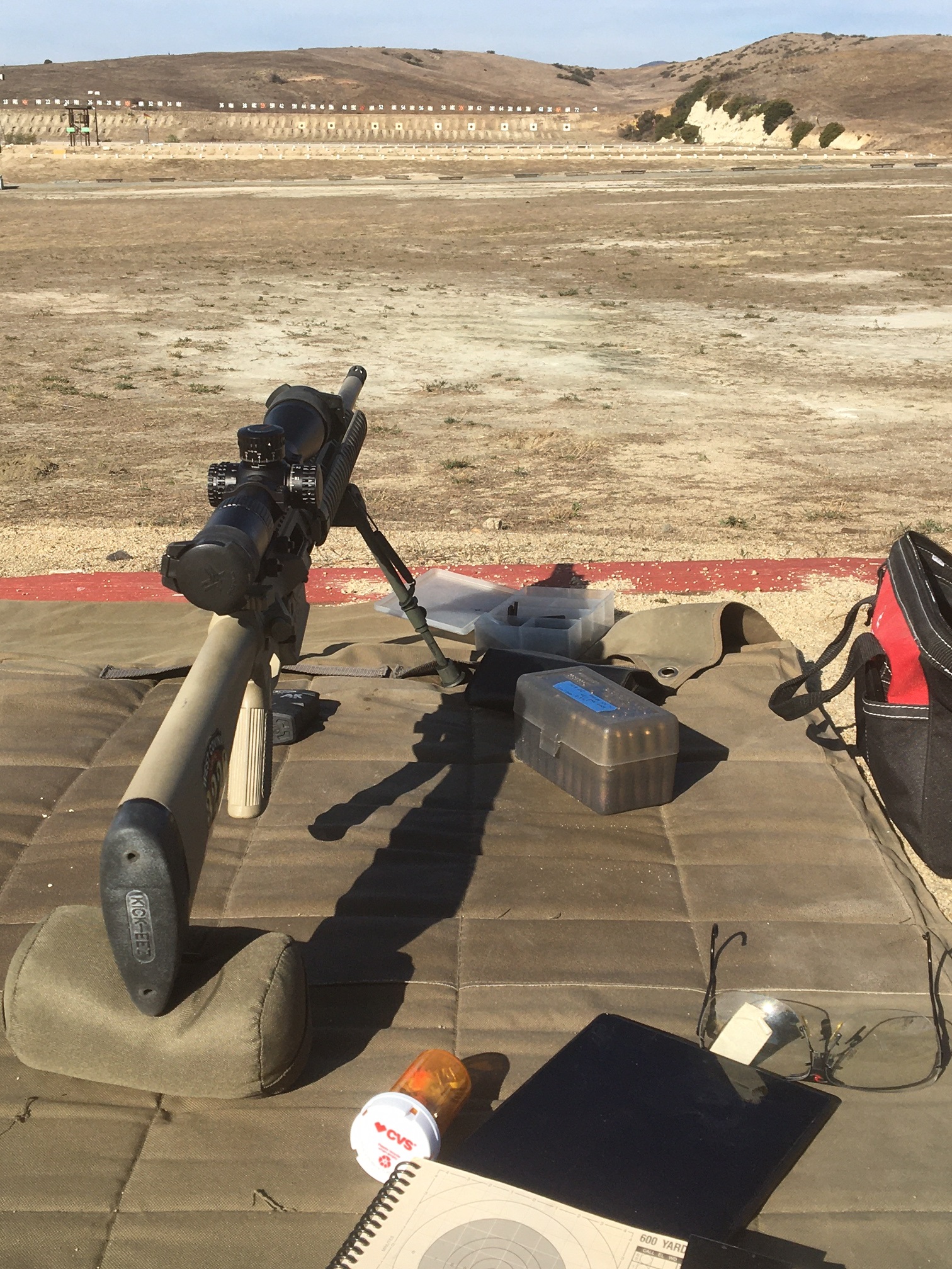

Nice! Got the same here M5 with Criterion medium wt 20" bbl. Practice day at 500yds with Nosler 168's & IMR 4064
I got some imr 4895, hopefully it does well behind some 168 eldms

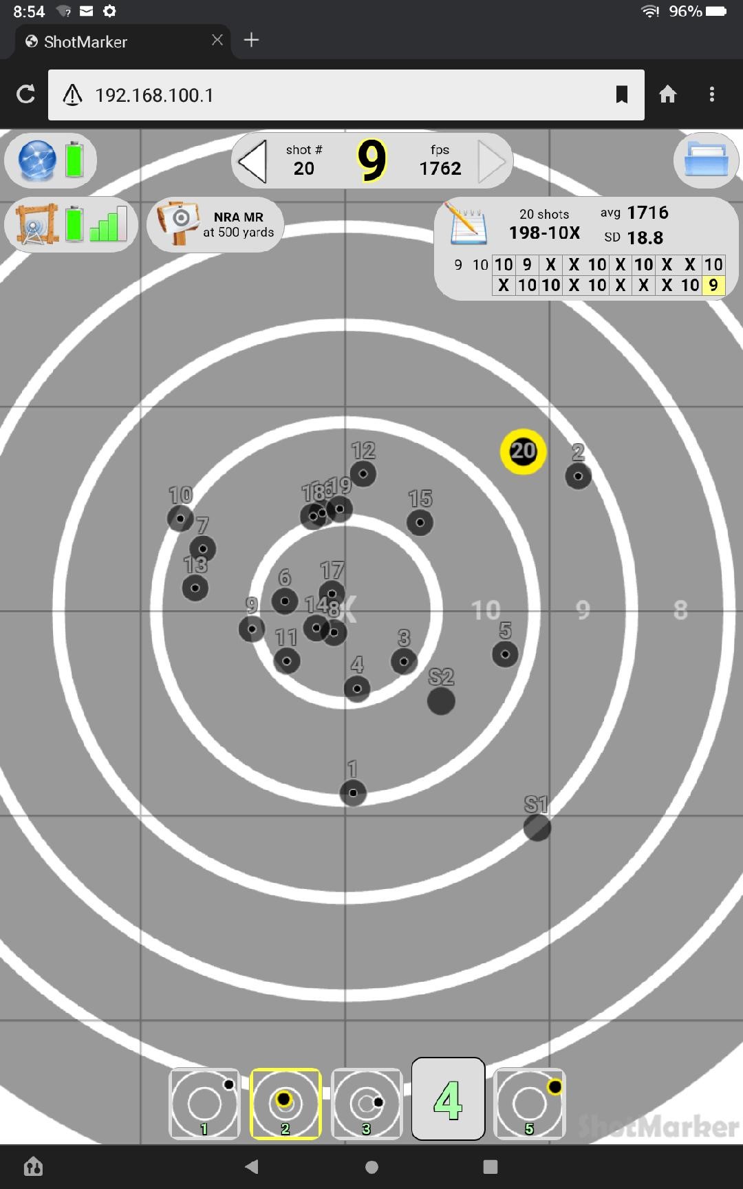

What groups do you typically get with the Criterion/RCA combo (I know there’s a ton of variables involved in that question)? I’ve been shooting some 175 FGMM and some 168gr Hornady Black with the AMAX bullet and have yet to get a group under 1.5 MOA. What would you recommend?
Realistically, both those ammo should do well in your rifle. A lot of it is the 308 AR is dependent on fundamentals: Consistent pull into the shoulder, sight focus, managing the bipod, etc. My background was NRA service rifle (sling, glove & coat) and now re-learning with a bipod; F-class T/R, this rifle and a Mk12 Mod 0.

that it’s just me who needs to step it up?
I mean sure, wind and mirage can definitely affect group size. So in theory my rifle could be MOA capable or maybe sub-MOA, and yours could be too. But it's not like distance magically multiplies mistakes. Like I mentioned, the large-frame AR sitting on a Harris bipod is just more difficult to drive straight and true. At first I was shooting about 3 MOA at 5 or 600yds, but after the video training I'm at 1.5 MOA.
