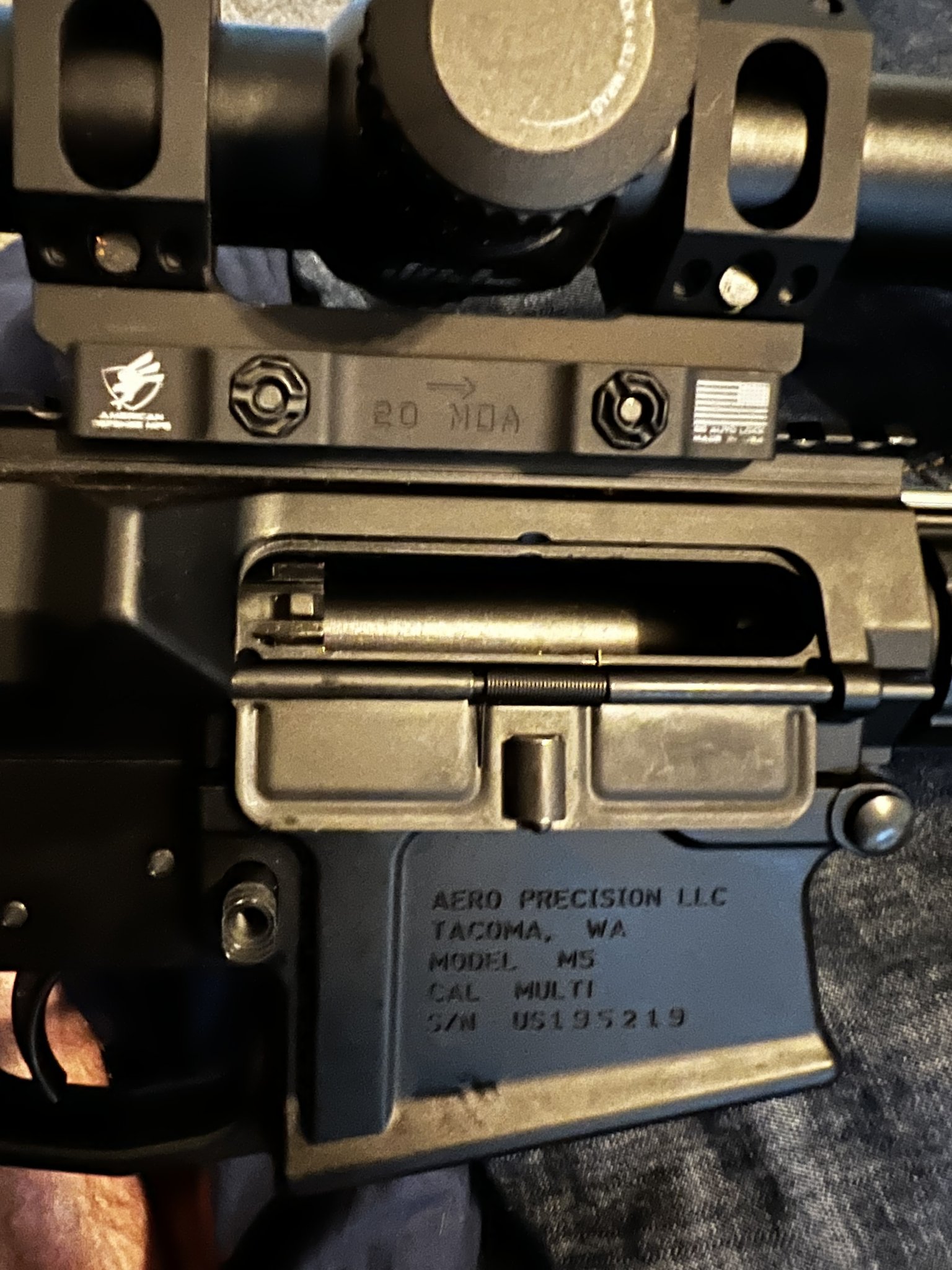

The bolt on my AR 10 build isn’t going back far enough to pick up a round. Aero upper and lower, Wilson Combat BCG and barrel, geissele carbine buffer tube spring and buffer. I have switched buffer springs with a BCM out of another rifle and even another buffer. Still only goes back to a certain point and stops. I did try a different lower that had a rifle length fixed stock on it and it worked fine. Everything I have searched says a carbine buffer tube will work. What am I missing?

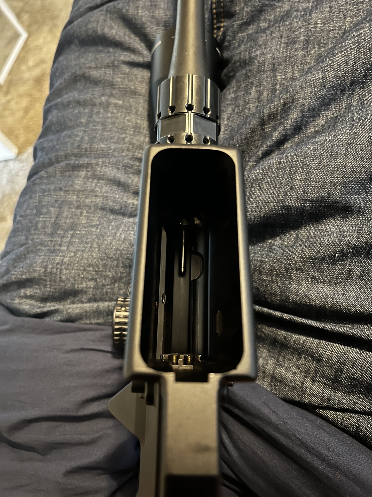

Also, it may be deceiving from the pic, but the gas tube should end in the middle of the cutout in the upper receiver. Your gas tube may be too long. Something to check.
Thank you for the feedback. It is the picture as I checked to make sure the gas tube fell in the cut out as I had found that in another post.
