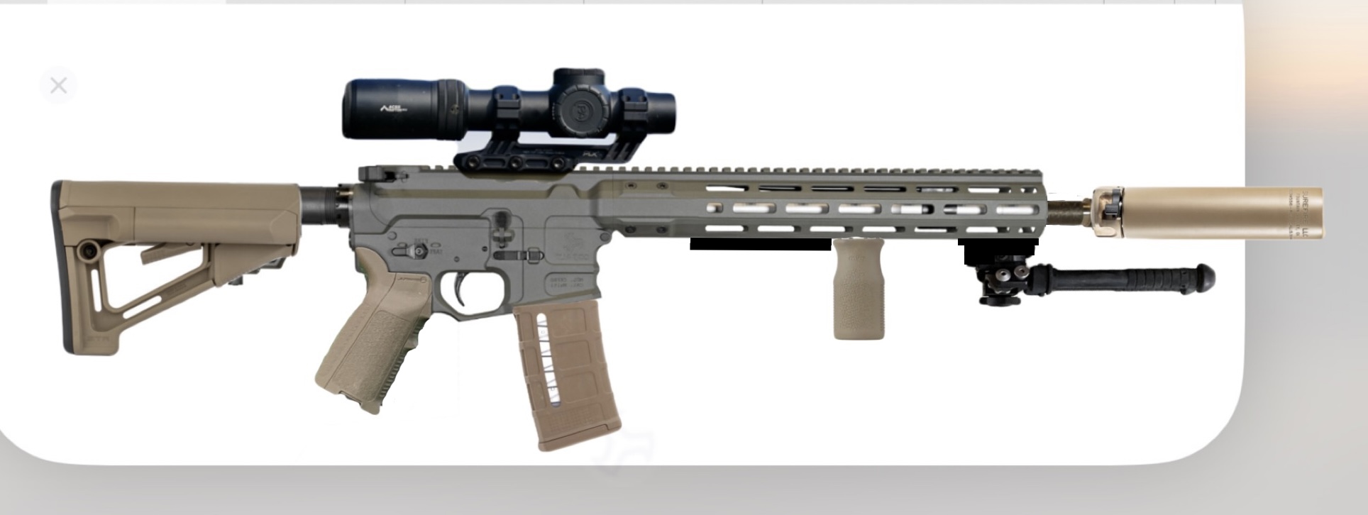

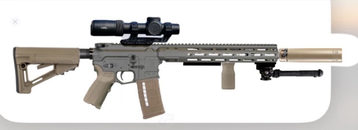

Very similar to how mine is setup.
LMT 13.25" MRP upper, LMT lower (NFA)
Proof Carbon 1:8 14.5" barrel
AAC Mini4 suppressor
Vortex Razor HD Gen II-E 1-6x
Very similar indeed
What ammo does yours like?
Any other insights?
Mock up was all on Snapchat actually haha
Cut and paste mash up
I’ve gotten decent with that

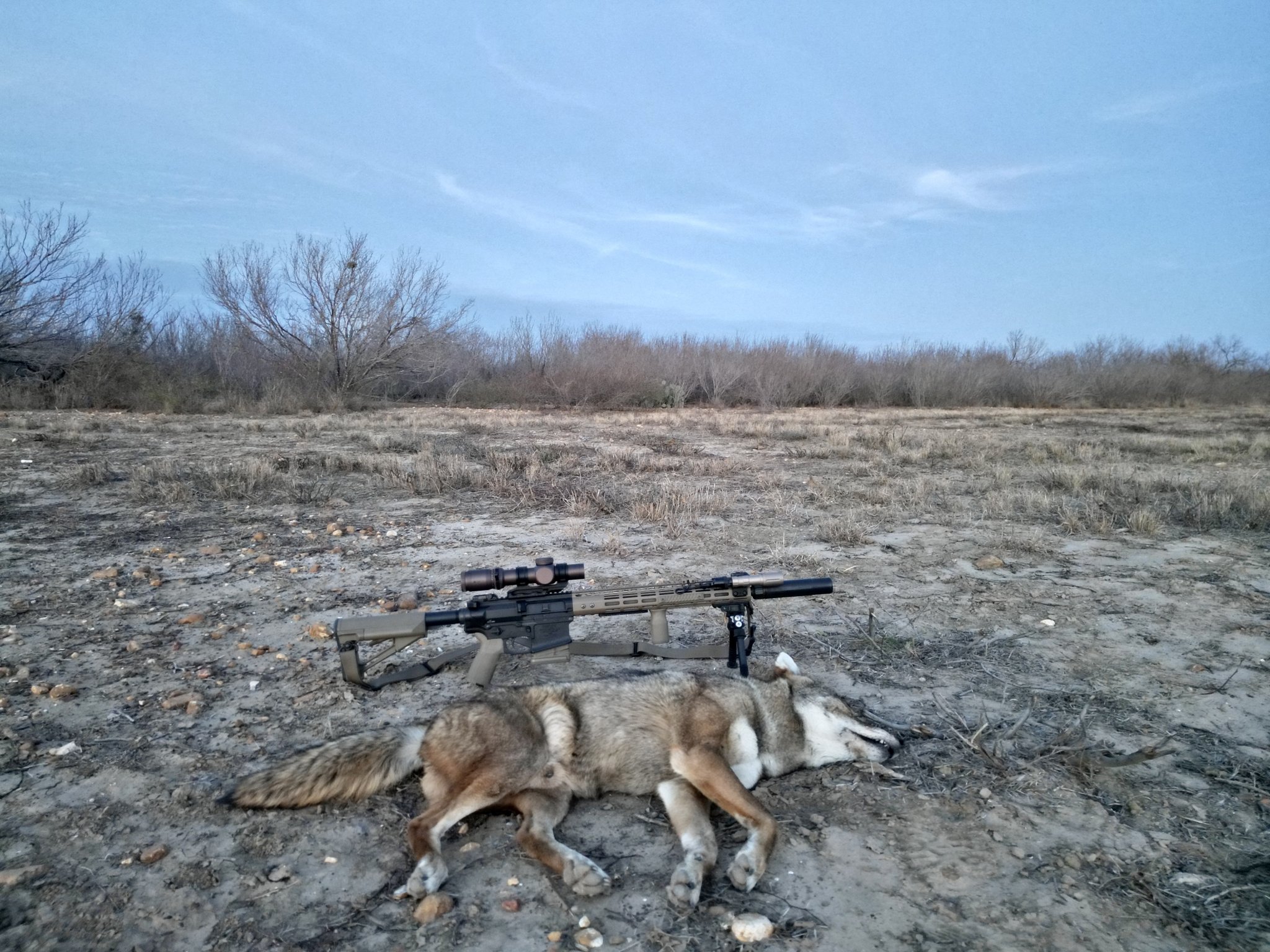

I know what I have seen from firing 20,000 rounds at varmints what works for me and what does not. I tried every bullet from 45-77 grains and none were consistently effective until I got to 16” barrels. 18” barrels are clearly better. After that the changes are incremental.
I have experience and theories about why but I doubt you are interested. Your experience may be far different. I notice people who shoot very few critters seem to learn a great deal from each one.
I don’t “do battle”, I just kill varmints daily.

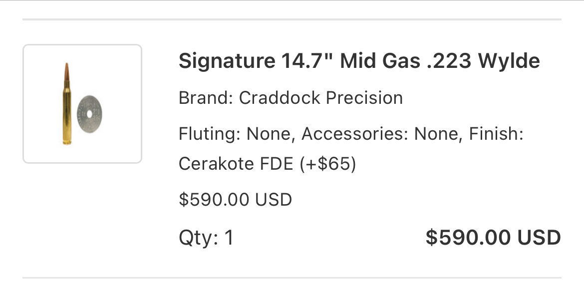

I appreciate everyone’s input! Really got me thinking. I’ve made a decision
I spoke with Paul at Craddock Precision and pulled the trigger of this:
(Craddock will cut barrel down to 13.9”)

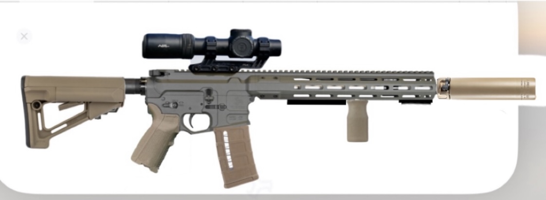

Cobalt Kinetics is building it and it will ultimately look something like this:
