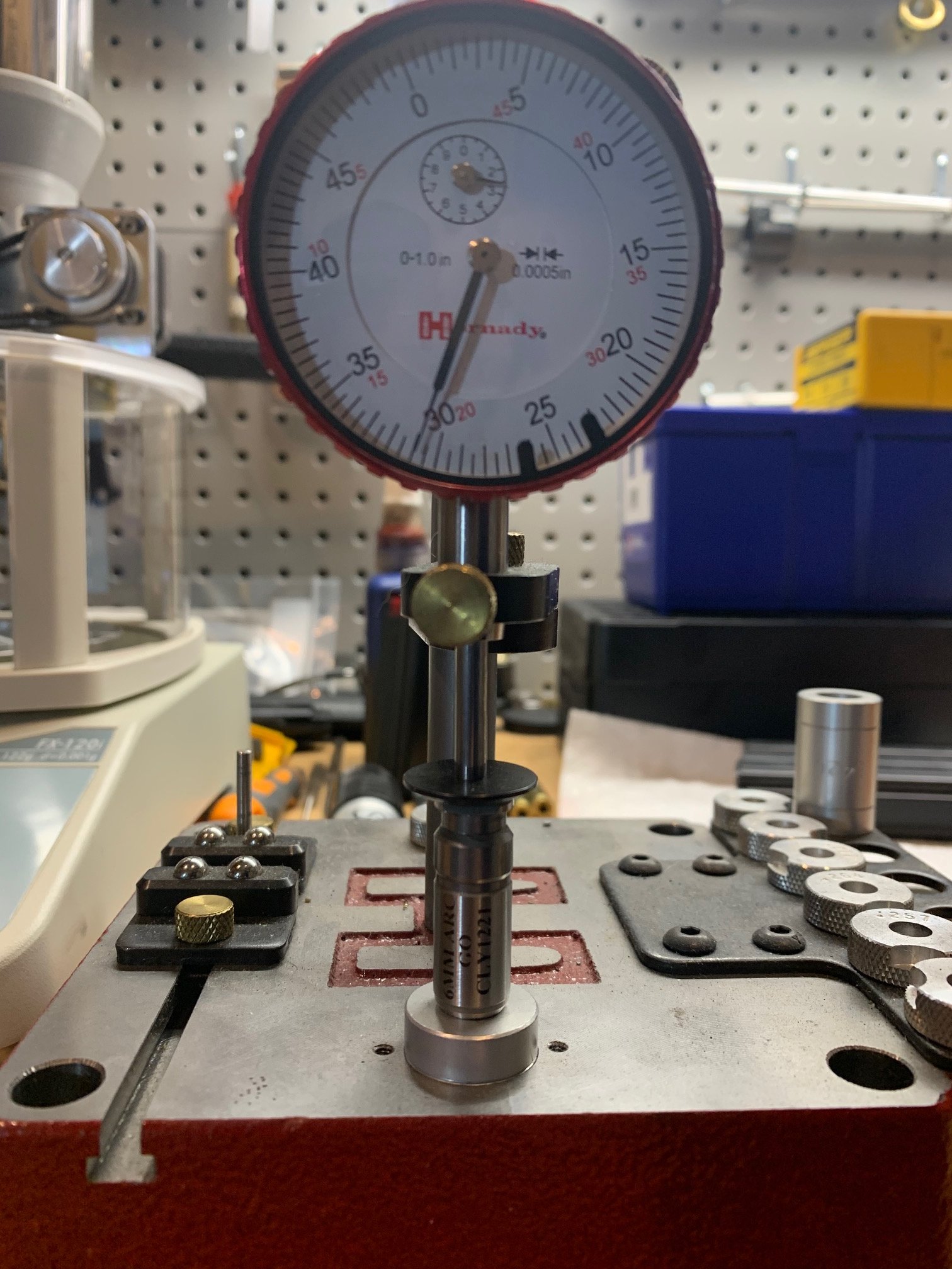

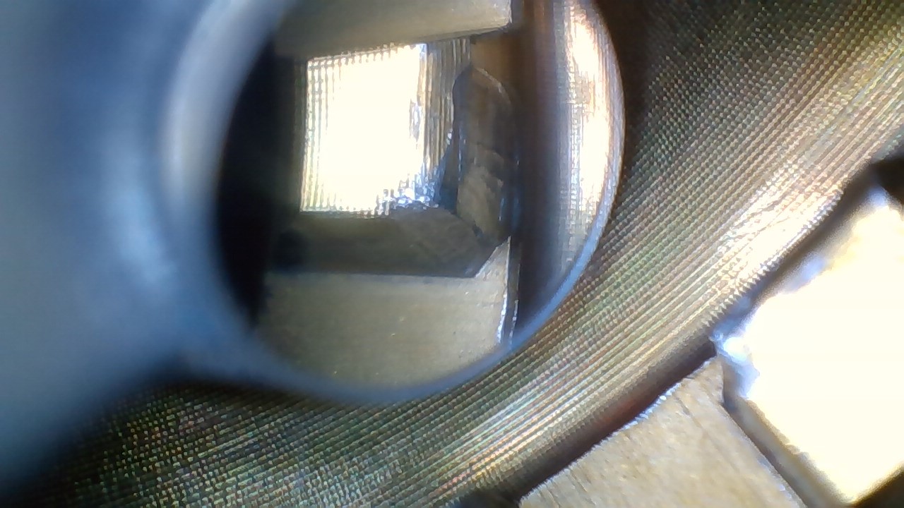

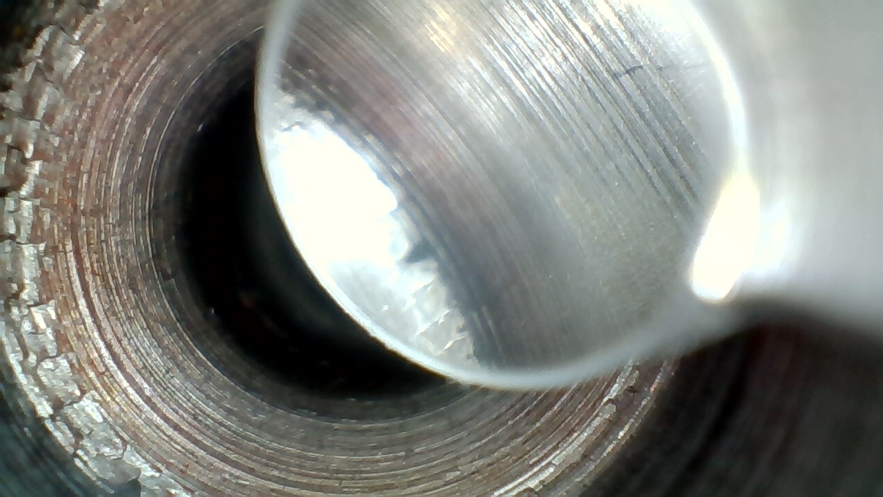

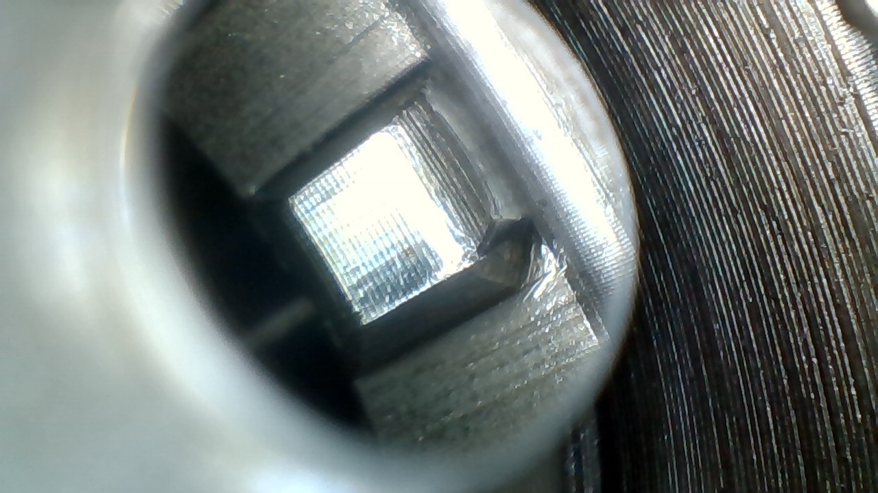

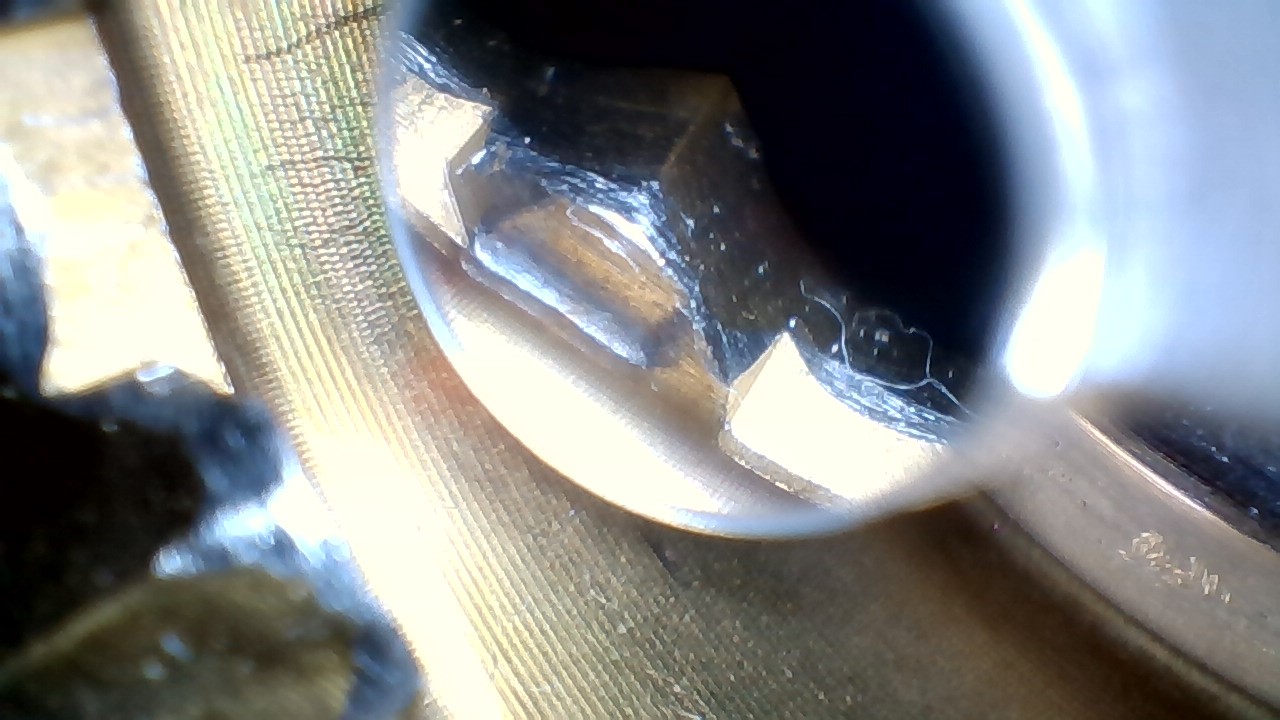

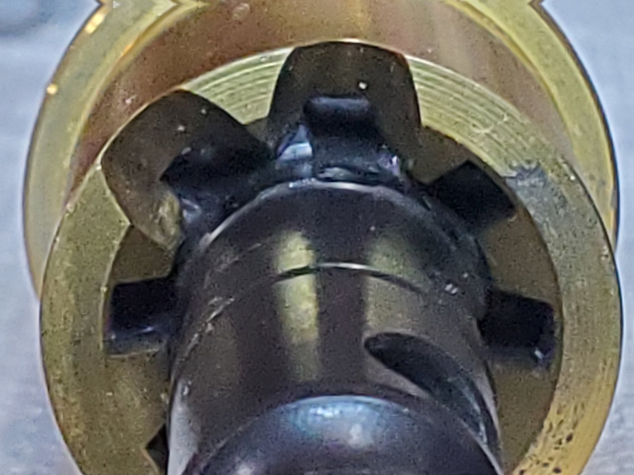

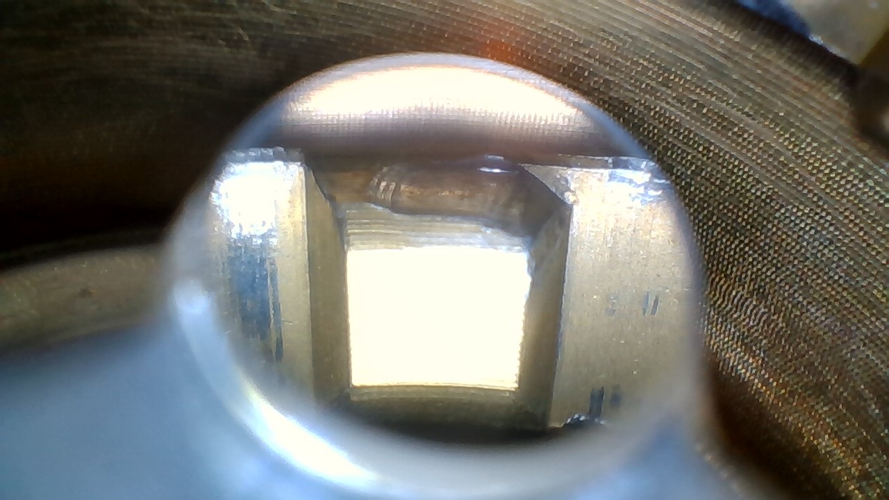

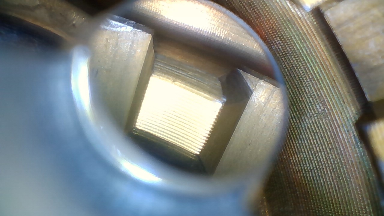

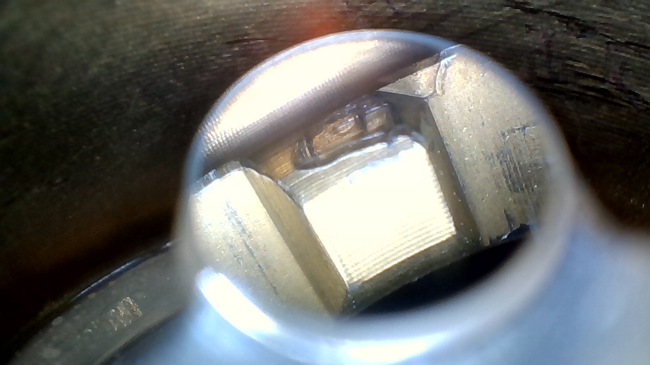

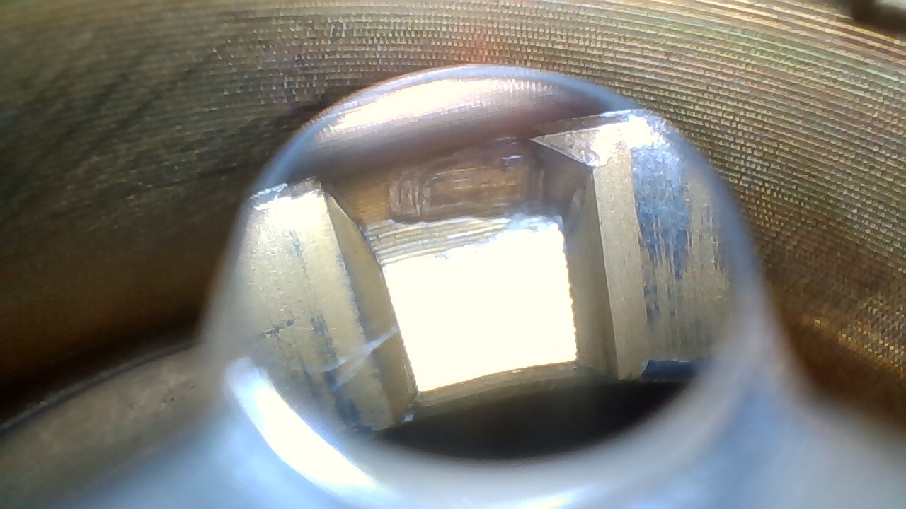

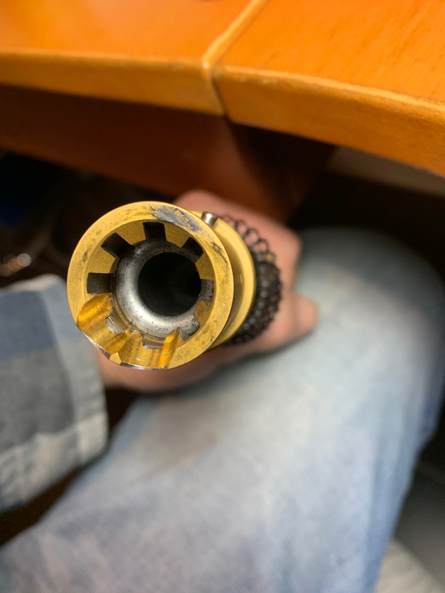

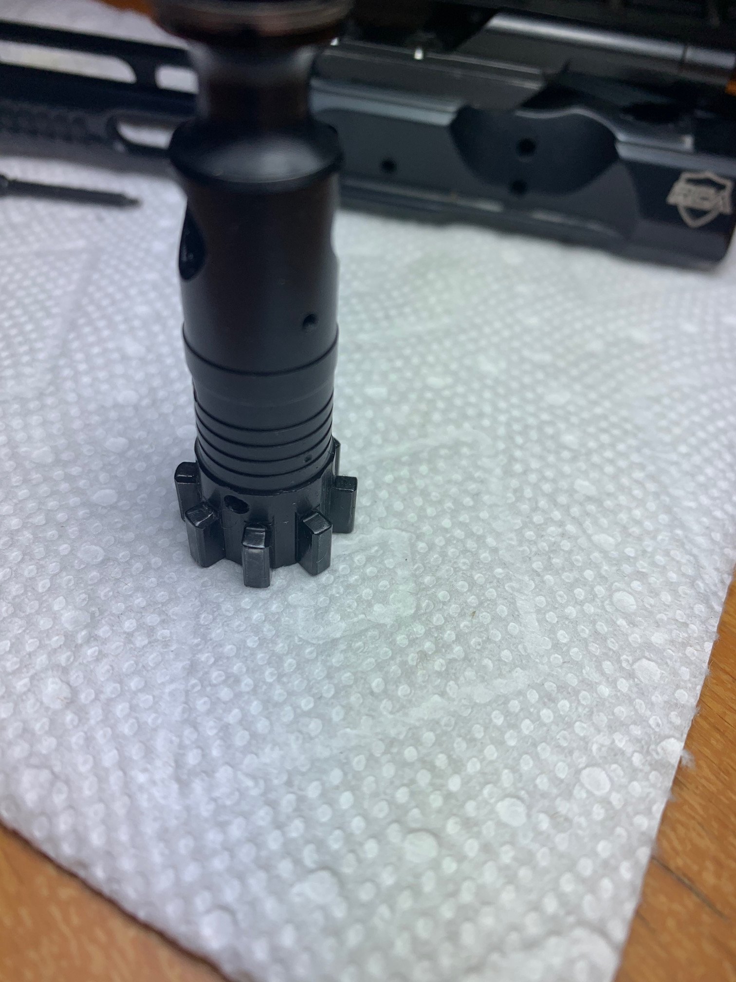

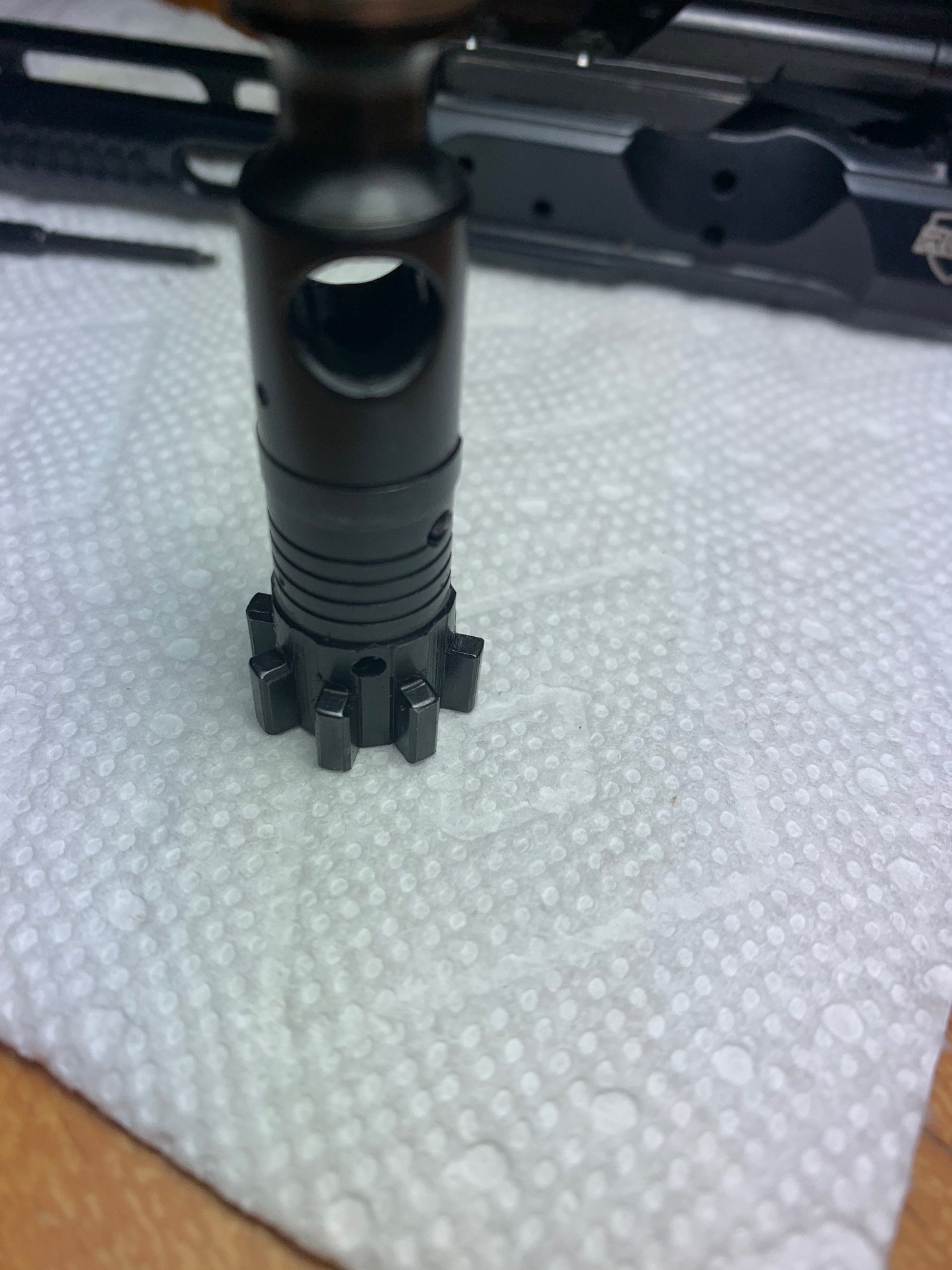

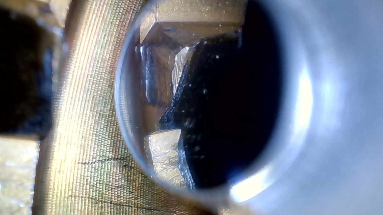

Has anyone ever had barrel extention damage on their ar15? Here is your chance to tell your story. I have never seen it before, but now I have had two barrels in row show the same damage. What damage have you seen and what caused the damage?
My second barrel is showing damage after 20 rounds of 6 arc shooting 25.5g of varget with a 90tgk at 2550. I have seen 223 wilde barrels that have shot several rounds that blew primers and they don't show any deformation on the feed ramps.
My last email i was told.
"What buffer and buffer spring are you using? If that's 20 rounds that's a good amount of carbon which combined with the feed ramp is indicative of very fast/high pressure extraction. Are you running this suppressed?"
My ejection is about 4 0clock 5 or 6 ft away just like my other tuned rifles.
I have seen carbine gas systems running way too fast ejecting almost straight forward for hundreds of rounds show no damage to the barrel extention.
The first two are the new barrel and compares the deformed side to the good sid. The second are the old barrel with about 400 rounds.
  • Wow
Reactions: Ernest 5.56

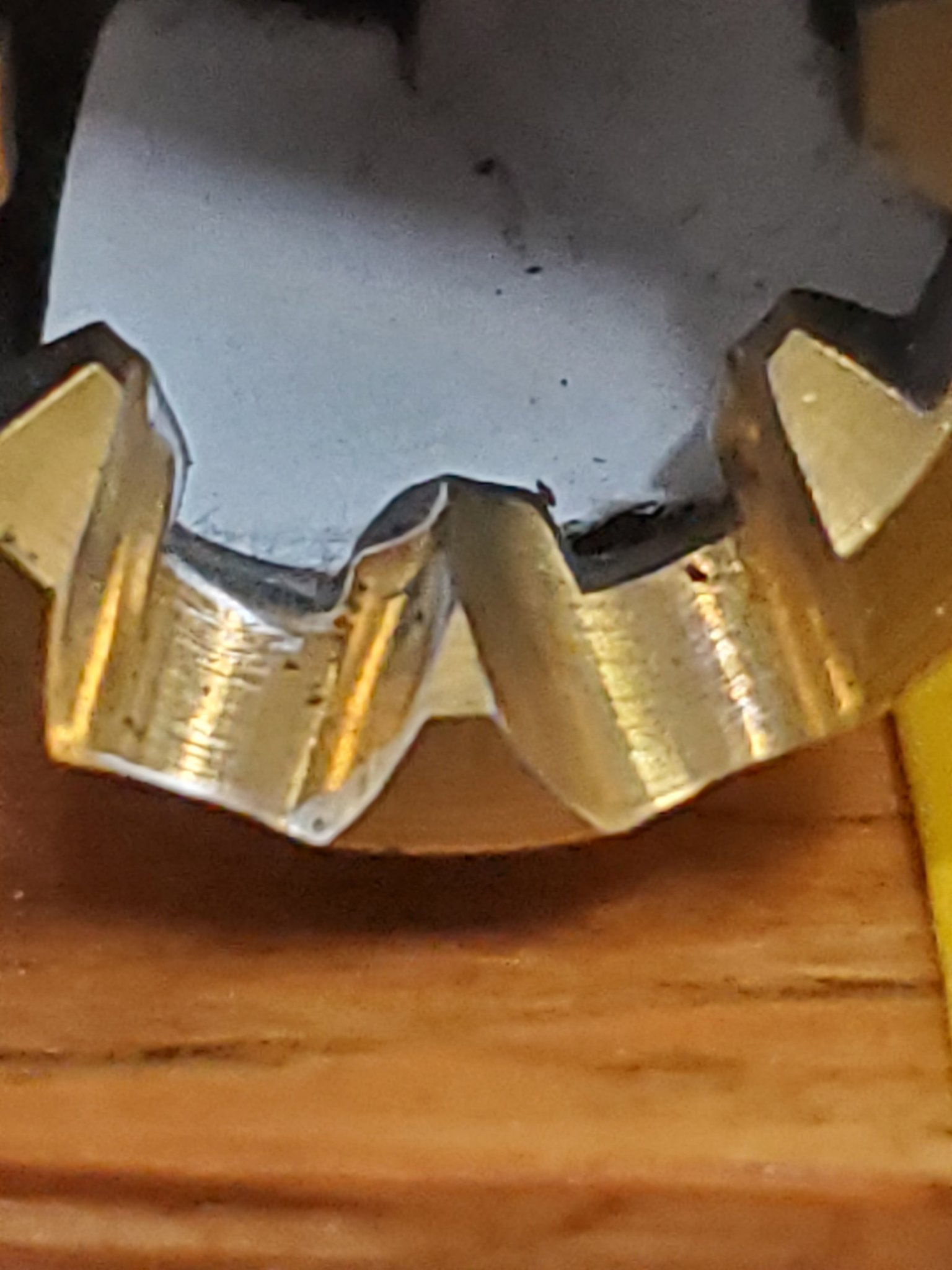

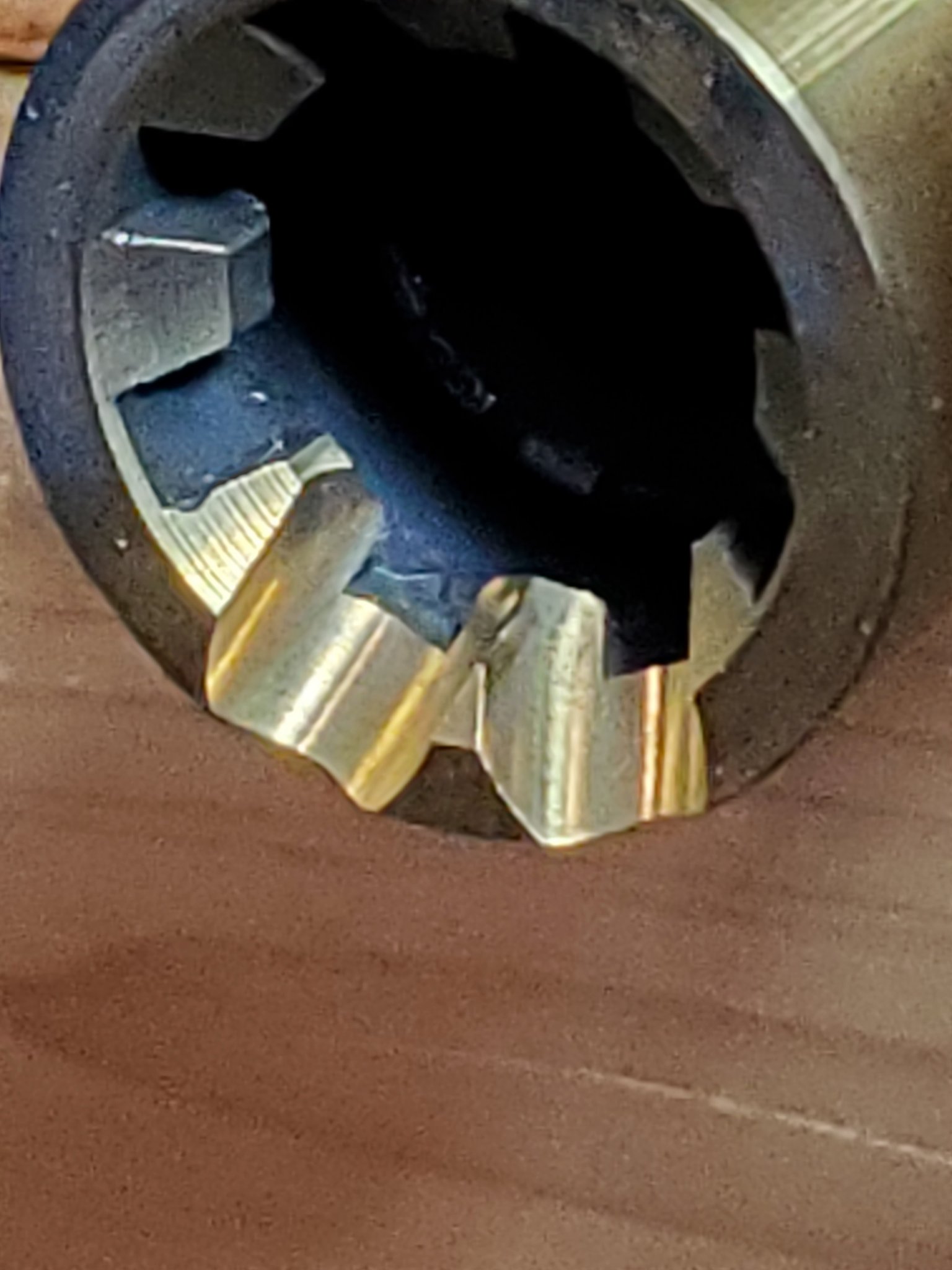

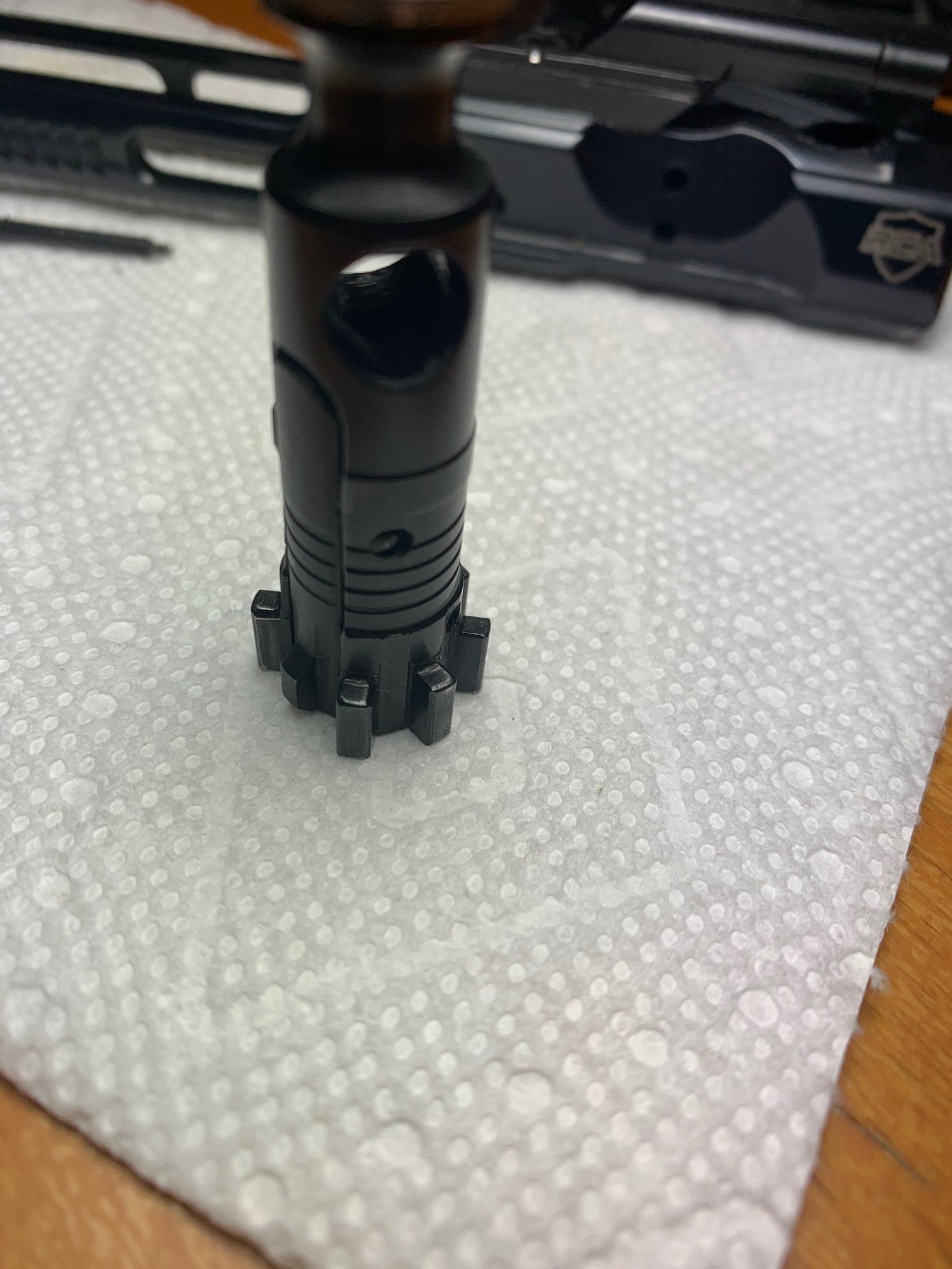

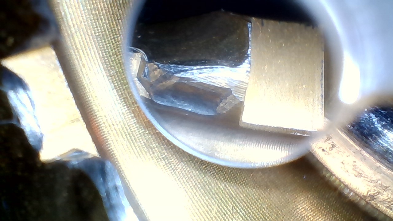

Yes. Rainer asked for all the parts i used. I sent all the parts to Rainer. They replaced the barrel, test fired it, and sent it back.
The bolt looks fine. I am not sure how the bolt would cause the damage. I am pretty sure the extention should be the stronger of the two parts correct?

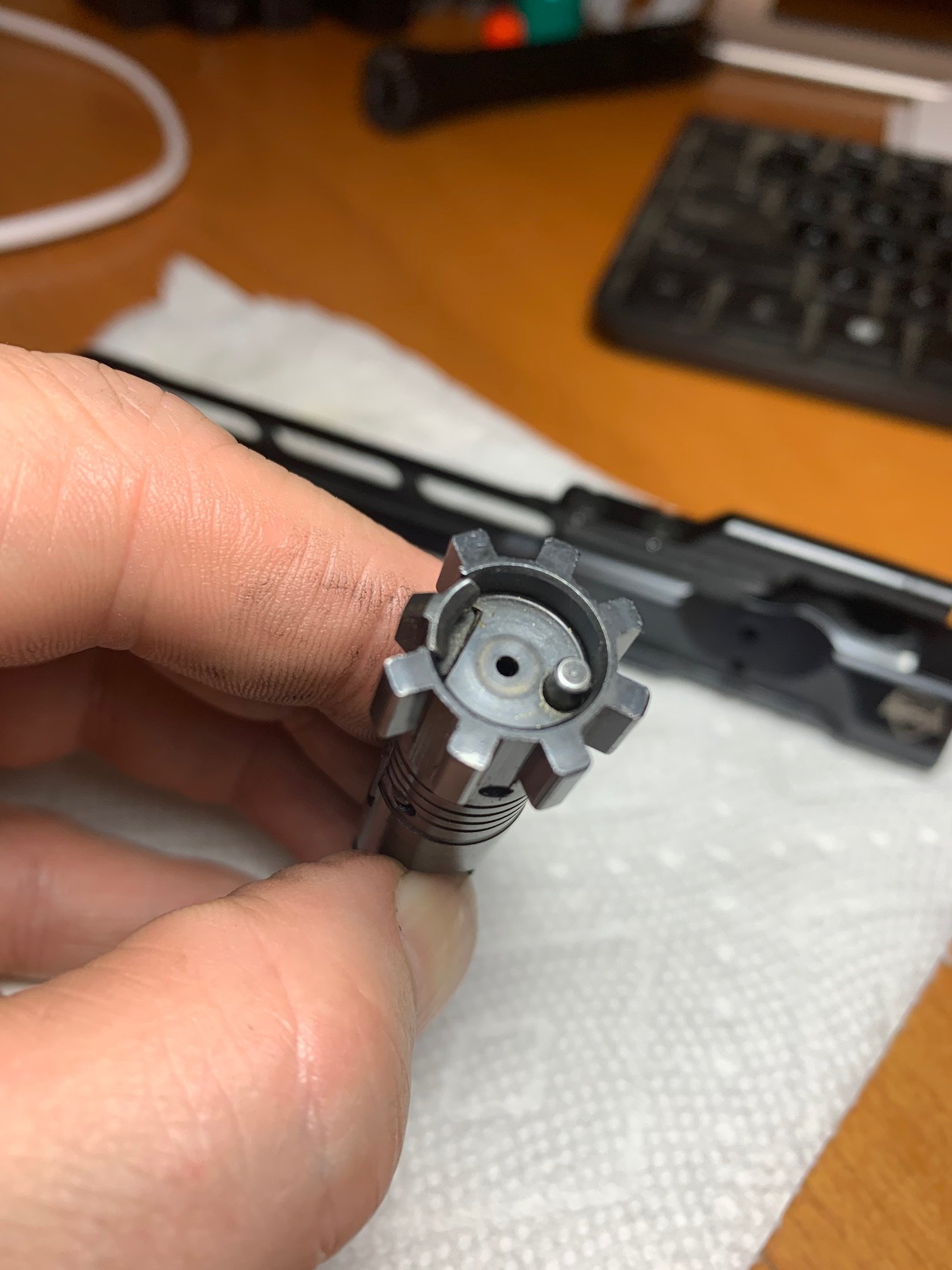

Could it be the carrier and an extraction timing issue? I am digging looking for something other than the barrel extention. It seems quite unlikely two are bad, but if two are bad the implacations are pretty bad.
I was thinking about replacing the bolt and carrier for the next one, but comparing the carrier to the one in my Grendel there is no obvious diffrence in the area the cam pin runs. I assumed inspecting these part was why Rainer wanted them.

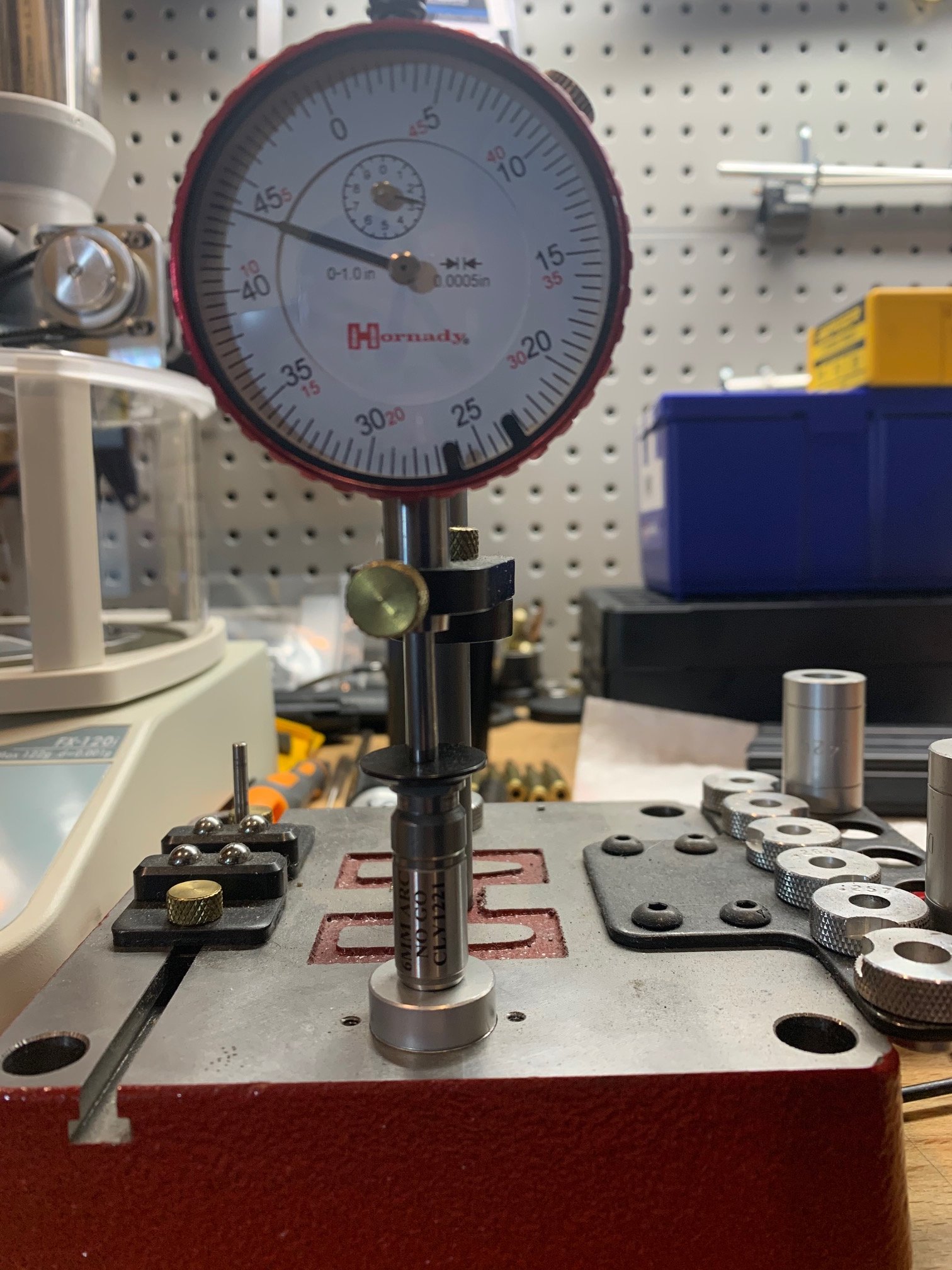

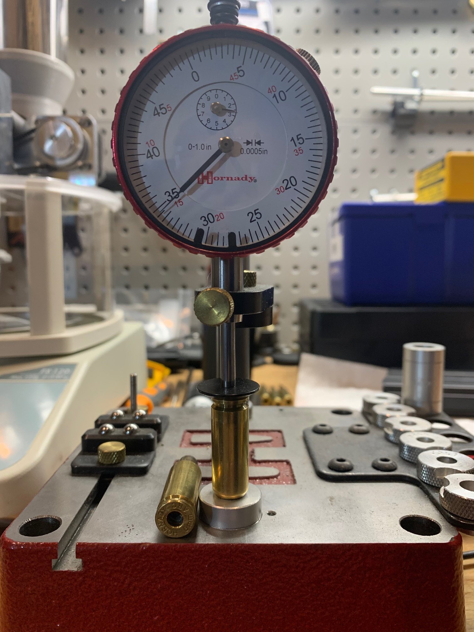

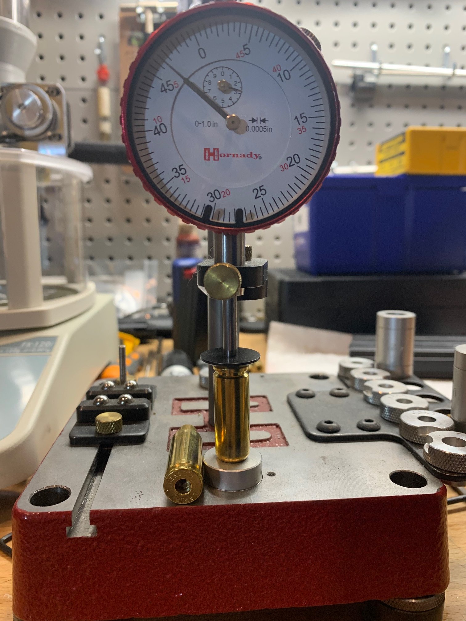

Brass is at 3x and primer pockets are still tight.

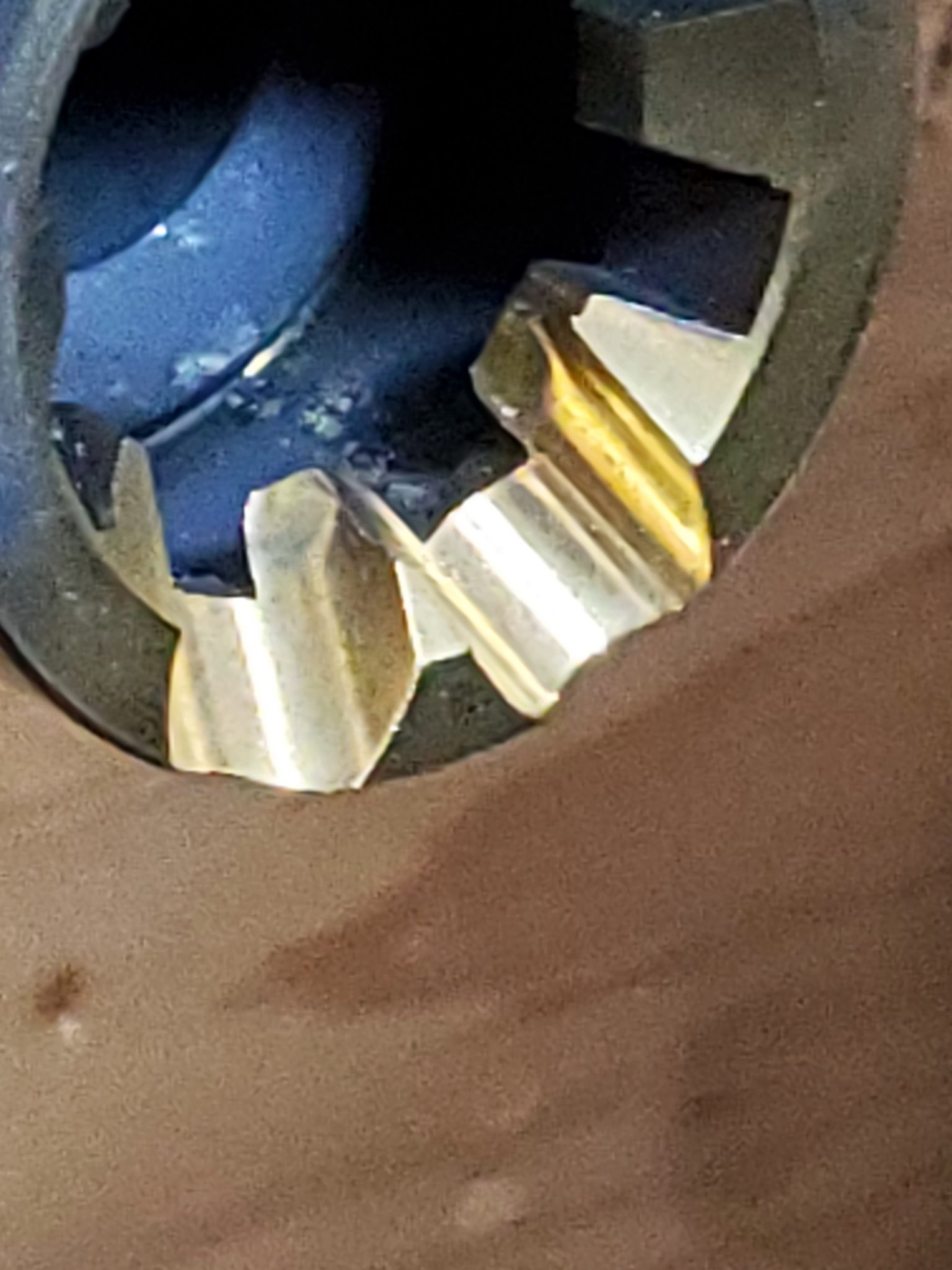

Could the coating or treatment on the barrel extention soften the surface and let the lugs sink in.
I don't see what I could have done to it in 20 rounds or how a part that could damage it that much in 20 rounds wouldn't be obviously damaged as well. I mean would 20 proof loads even do that? Would it set back or break some lugs first?
Does anyone else have a Rainer ultra match 6 arc they can check?
My guess, it's a batch of Barrel Exstenions that didn't heat treat properly and are super soft.
I've never seen that shit before, since it's a Rainier Arms Ultra Match send it back to get a refund. Craddock Precision is making those barrels now maybe it's something on his end.
Reactions: RTH1800 and BCP
The bolt doesn't look damaged. The thing is I bought the first barrel a year ago. And this new barrel I assume was just made.

Was that you?
I had another thread where I was asking about the upper receiver then when I took it apart I found the barrel extention damage. 357max said he had the same problem with a Rainer UM. It wouldn't be very noticeable if one were shooting factory ammo or not watching shoulder bump and growth batch to batch.
I’ve been having trouble with a Ranier match barrel in 6ARC also. It does not want to go fully into battery, I’ll get a click (no FP strike on the primer), and then I’ll have to mortar the damn thing open with a mallet. Does this with multiple magazine, two different bolts and BCGs, and two different buffer setups. Very frustrating.

Below are excerpts from my correspondence with them in reverse order.
As you can see I stressed they had a heat treat problem with the Tin coated extensions.
I did receive the replacement, but only have 40 rounds on it.
Mike,
Following up on this. Called last week on the 13th & spoke to someone. He said he’d been trying to head space a new barrel to the old bolt🤦🏼‍♂️. Told him to give up as that bolt was just sent so you would have the full picture. He said A new barrel would ship Tuesday the 14th? Haven’t received any email or tracking. Has this shipped?
Thanks
Mike,
Thank you for the reply.
I would prefer you just replace the barrel. If the replacement barrel extension can easily be verified for heat treat by your shop that would be fantastic.
The barrel was shipped today using your label. You should receive it Tuesday 3/7. Tracking #
I did include the Maxim bolt that was run with the barrel. If possible I'd like the bolt returned with the new barrel. Ejector + spring & extractor were tuned and I'd like to recycle them for spares.
Not sure if your shop has the ability to perform a Rockwell test on the extension, but I would suggest doing so. It's a very high probability this was the result of improper heat treat by your extension or heat treat vendor.
Build specs below for ref.
VLTOR Fusion F-15 monolithic upper, receiver face trued, extension thermal fitted with 1 full wrap of SS .001 shim stock
Odin works adj gas block & + 2" gas tube.
Rubber City light weight bolt carrier, FP, Cam pin
Maxim type 2 6.5 Grendel bolt
JP silent capture buffer system std weight + standard spring
Magpul PRS gen 3 stock + spacer for silent capture.
JL billet ambi lower
Trigger Tech single stage & ambi selector
Gas block was running pretty close to the center of adjustment range.
The ejection pattern was 4:00
BCG over travel was checked and good.
Attn: Mike
Total round count on barrel is 446. FWIW the receiver face was trued and the barrel was installed with 1 full wrap of .001 shim stock. Lug contact was even & I always run lube on carrier and lugs. When new head space with new Maxim bolt was Go plus at most .001. Now it's go plus .0013
Per our conversation please see attached pictures of the barrel extension. The pictures are in the following counter clockwise order looking from the back.
3, 1:30 (extractor lug), 12, 10:30, 9, 7:30 (might have to stare at this one for a minute), 6, 4:30.
1 picture of 12 oclock lug on Bartlein with 100 rounds on it for reference.
Pictures of the bolt lugs & top.
Back of extension showing metal displaced back on bottom 3 lugs
I think the extension was either improperly heat treated or Tin coated without heat treat. Hopefully you didn't get a big batch of the same. I have a lot of AR's and have never seen this happen before.It was gaining almost .003 HS per 100 rounds. I do not trust this to continue running it. I spoke with one gentleman who's broken 3 bolts each @ about 1000 rounds. Each time a new bolt head spaced to the barrel i.e. no extension wear. He was also running Varget which IMO is too fast a powder for ARC so I'm not that surprised.
1 pic of shoulder area in chamber. Not relevant to this issue nor accuracy but still it's disappointing & hopefully not the norm.
Pictures of the go gauge used when this was assembled, might have been go +.001 at most. And a pic of where it is head spaced now No Go + .004 via 2 pieces of scotch tape.
Pictures of 1 x fired Hornady 108 in Bartlein barrel compared to 1 x fired Lapua in Rainier barrel in Headspace comparator. Both are deprimed.
Let me know your thoughts?

View attachment 8360804View attachment 8360805View attachment 8360806View attachment 8360807View attachment 8360808View attachment 8360809View attachment 8360810View attachment 8360811View attachment 8360812View attachment 8360813View attachment 8360814View attachment 8360815View attachment 8360816View attachment 8360817View attachment 8360818View attachment 8360819View attachment 8360820View attachment 8360821View attachment 8360823
I can already see material bubbling up on my feed ramps at 20rds with my replacement. It looks just like yours.
They are stressing that it is entirely unlikely they have two bad extentions from diffrent batches. And asking what ammo i used and telling me improper spring or buffer is the only thing they can think of of that would cause this.

I kind of thought they would look at this and draw the same conclusions as me. Not give me horse shit about buffers and spring and the bolt running too fast.
I emailed optics planet a couple days ago to see if they will take back the rainer barrel. It looks like I bought it last March so its past the point of click on item and print return label.
The bit in bold above sounds to me like your barrel extension was too soft. IMO there's a reason nobody else uses TiN coatings on them.
A thought to consider from the other side though - Varget is on the fast end of burn rate for the 6 ARC, and it's easy to get short duration but high peak pressure spikes if the barrel has a relatively tight chamber and throat, which in my experience Ranier's UM barrels do. Most of the time I'd expect to see evidence of this on the brass too, like changes in the headstamp markings, but the primer pockets may not loosen. Think of it like a fast slap of the case head against the bolt and into the barrel extension lugs, vs a strong hard push that the pressure profile of a slower burning powder creates. If that's combined with a little more headspace (dependent on how you adjust the sizing die, not what a go/no-go gauge set says) that'd make the situation even worse.
I know you're trying to make loads that use smaller powder charges (per our conversation about 20 Tactical) but doing that with a fast burn rate could be making this barrel extension issue worse. However, if the barrel extension was hardened correctly it shouldn't happen at all, you'd probably not notice until a bolt lug broke, IME.
