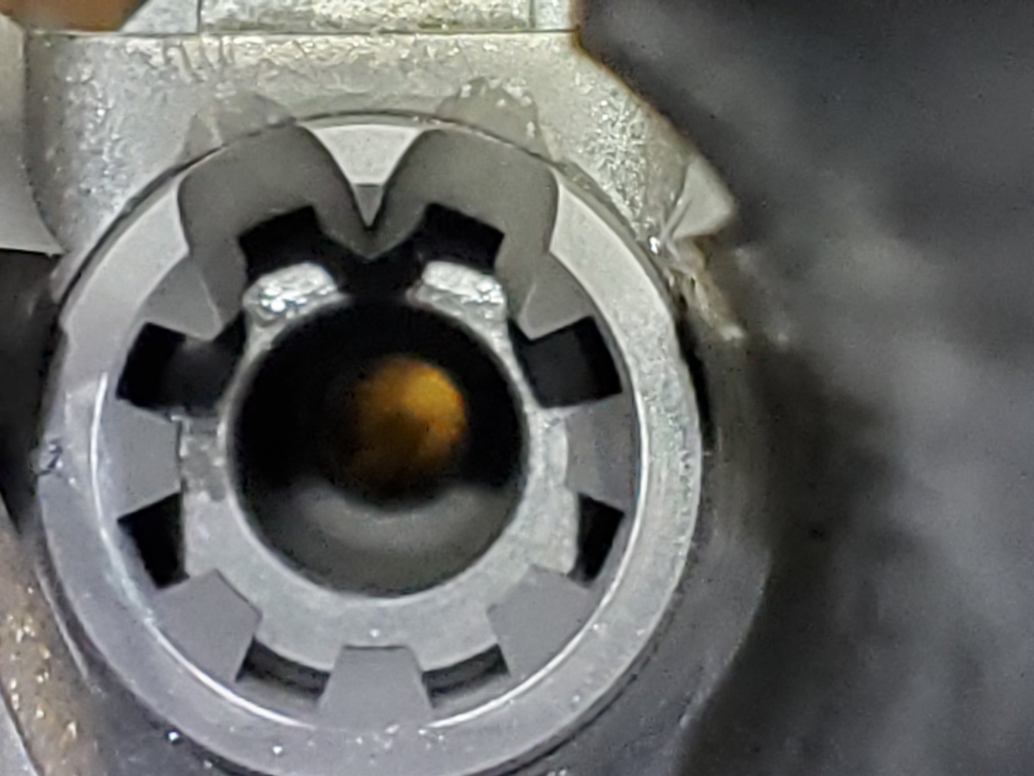

25g of varget with a 90 TGK at 2550 should not be a high pressure load I don't think. Hodgdon data puts an 88g berger at 2550 with 25g of varget at 38k psi. (Its their starting load) Not just that but nothing wrong with my brass after 4 firing exept some Shiney lines showing up because I was over sizing because my headspace was growing.
Borescope probably would have missed it, although I wish I had one to take some pictures of it.
If I was measuring my brass each firing I would have noticed something was up on the first barrel before I shot 400+ rounds.

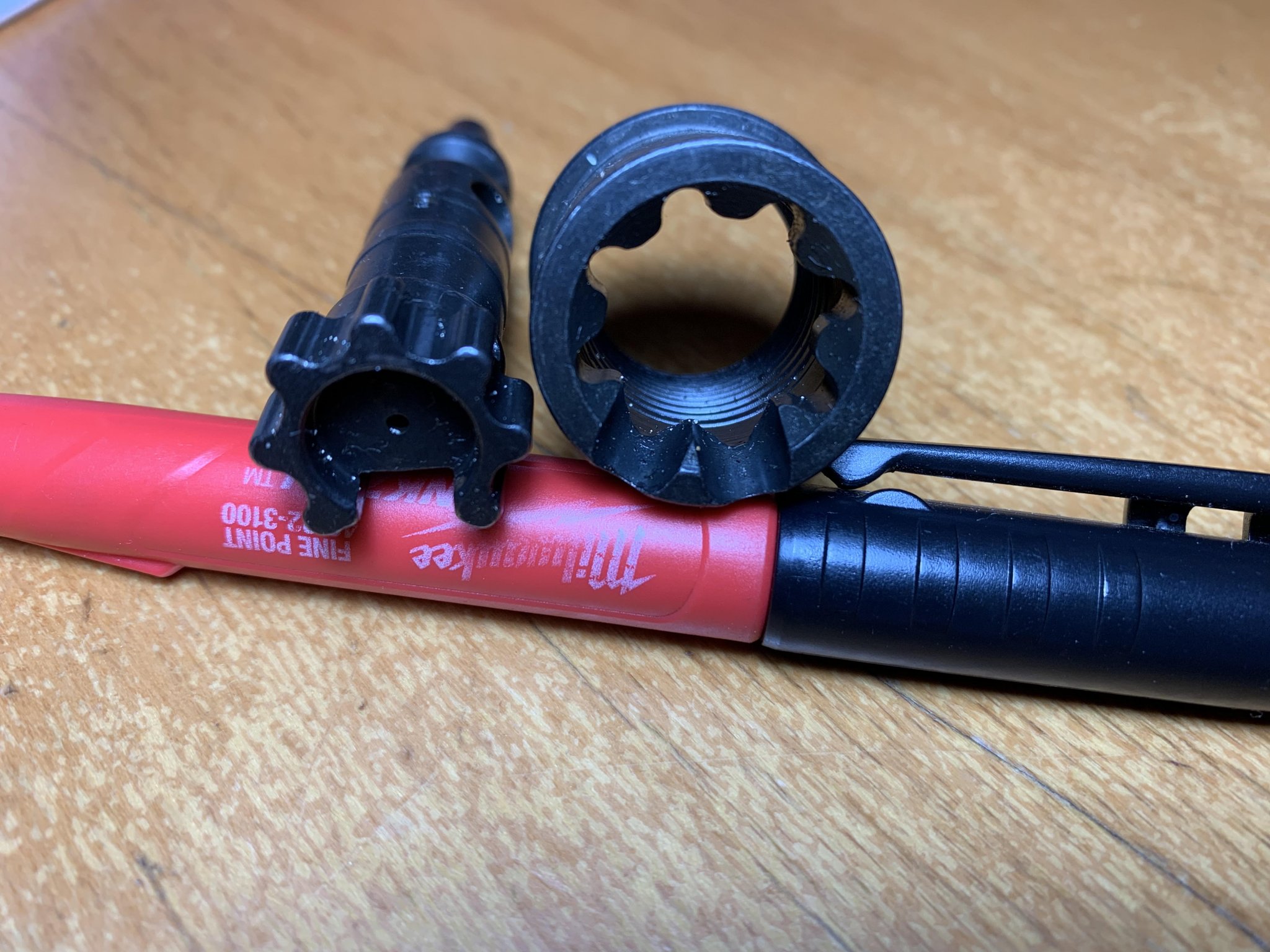

I had a stretch 16 5.56 barrel years ago that had a nitrided barrel extension. It did the same thing. They replaced the barrel extension and it happened again. I think it was the nitride that did it. I still have the barrel, but it has a chewed up barrel extension. It's too bad too, because that was an accurate barrel when it worked.

This was back in 2017. At the time, McGowan barrels fixed the extension under warranty, but they told me it would probably happen again. Sure enough, it did.
The barrel shot super soft and was very accurate. I would love to get the barrel working again, but I don't know where to get a new barrel extension put on.

Isn't the extension just screwed onto the barrel? I bet a decent smith could do it

Yes, but instead of it being torqued on and then drilling the gas port at TDC like you normally would, you've now got to time the extension to line up with the gas port, and not mess up headspace while you're at it. I'm sure it can be done, not sure what it would cost though.

You're definitely right. I was just reading this thread below and didn't think about the timing. A dude mentioned how bad it is to nitride the extension too...

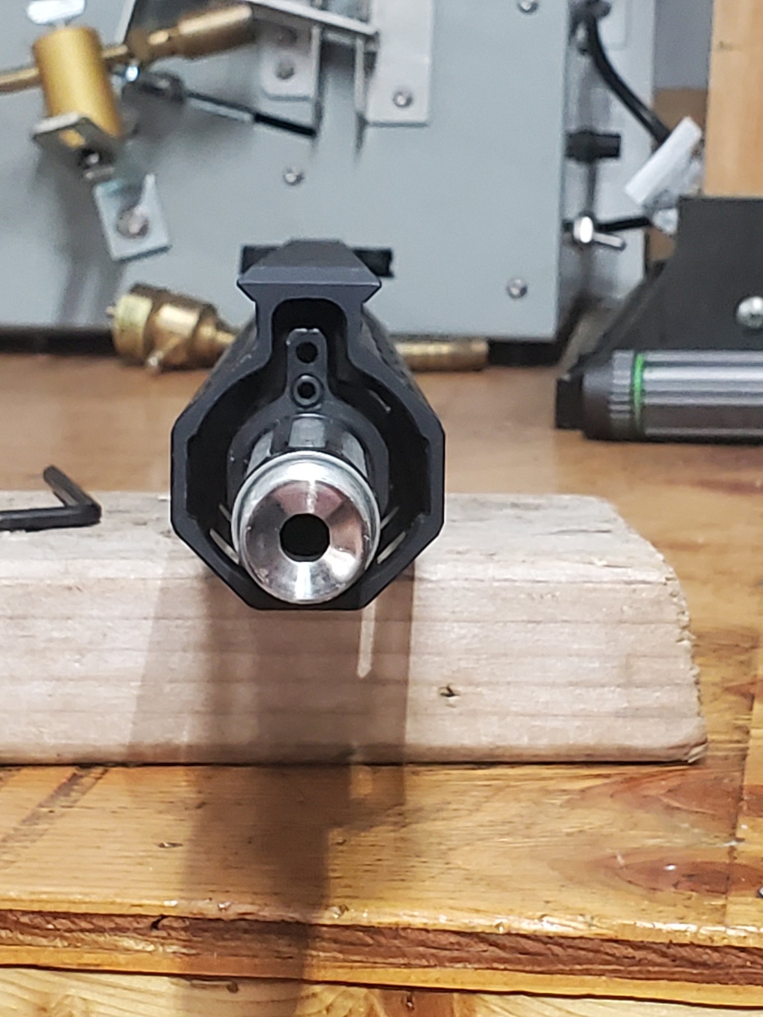

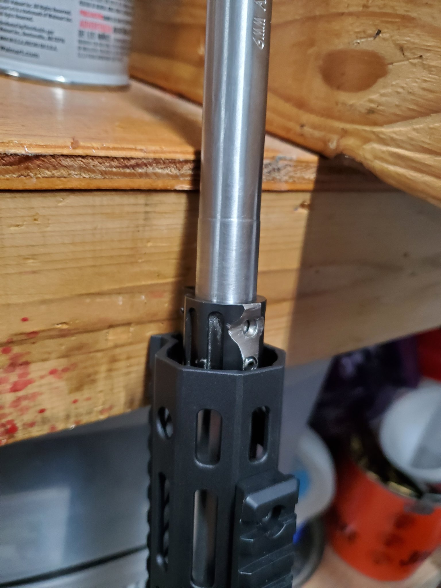

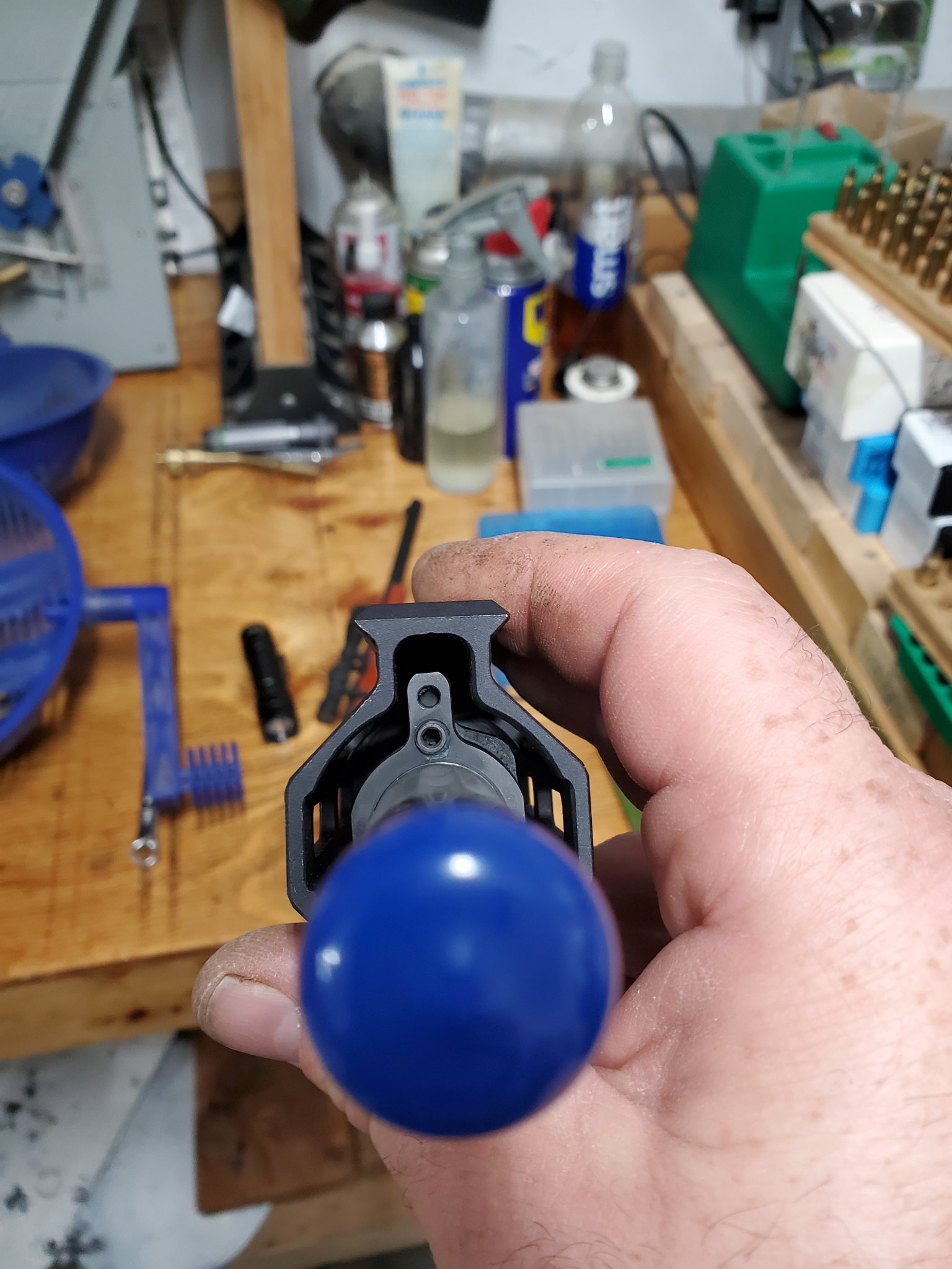

Well I finally got it back with a big time fuck you assembly. The handgaurd screws were tight I almost broke an Allen wrench getting them loose. I needed to get to the badly misaligned gas block. They were not just tight as shit, but also thread locked on. Last time I removed them no problem after their assembly. This time even after using a torch and melting something that looks like jb weld epoxy out of the joint the screw won't budge.
I wait 8 fucking weeks on the second barrel with a bad extention. And this is what I receive. And my ammo that damaged their barrel in 14 rounds seems just fine after 42 rds in my 150 dollar cmmg barrel. Talk about sendimg a big fuck you to a customer.

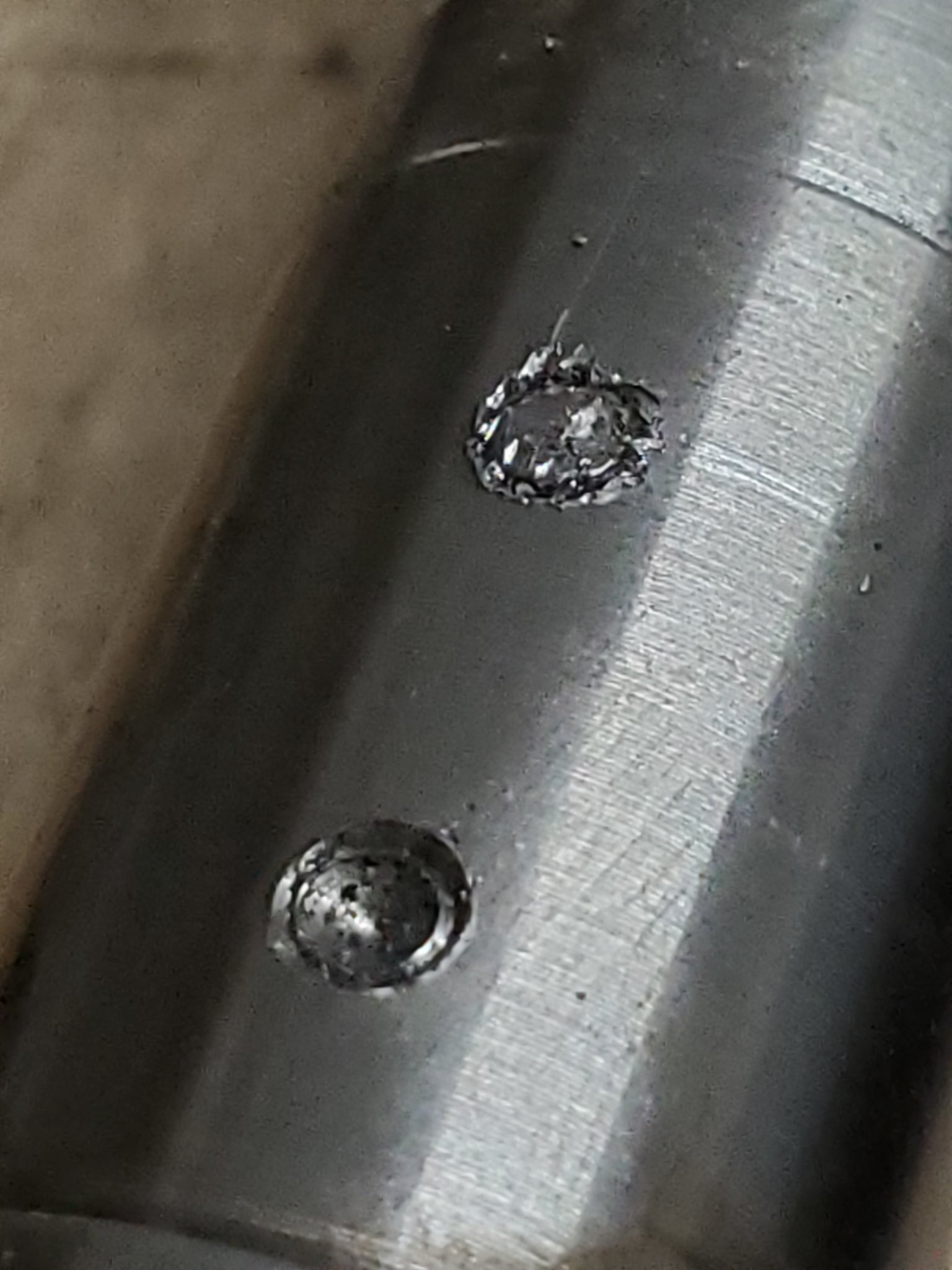

I can't tell for sure. I need to drill out the seized screw but looking through the other set screw hole. It looks lined up on the dimple. Probably mean the gas port is out of position also.
Another thing I noticed was some brass growing belts from the first Rainer barrel. Even after sizing to the shell plate two wouldn't chamber in my CMMG barrel that measure .446 at the base. Those two cases chamber easily in the new rainer barrel. My understanding of print was that max diameter at the base should be .444. Am i reading the print wrong? Is it likely both of the rainer chambers are over max diameter at the base?
This is how tight that front screw was. I drilled it. Broke an extraction tool. Had to grind it down until the extraction tool was ground out of hole. Then slowly drilled it until a slight tap on the gas block popped the remainder of the offending set screw out. I have never seen a set screw leave such a deep indentation on a barrel. I just can't wrap my head around how this could be an accident.

The more I think about the more I can see how this could have just been some ham fisted gorilla that puts everything together way too tigh. Exept the barrel nut. It was probably around 30ftlbs. Put a T handle or L shaped Allen wrench in someone's hand and they can easily get these little fasteners wayyyy to tight.
Is the gas port misaligned?
I don't think so. You can see the indentation around the dimple where the set screw dented the barrel. It was way to tight also. But also shows they just missed the dimple. That's why I assembled my own stuff though. When I worked in the shop there were some other mechanics I wouldn't have let work on my bicycle. Lol.
I am still suspicious if the chamber is fatter than Sammi with the .446 brass chambering easily. I think I need to take someone advice from earlier and just

Idiot probably used an impact driver and tightened the no dimpled screw first.
